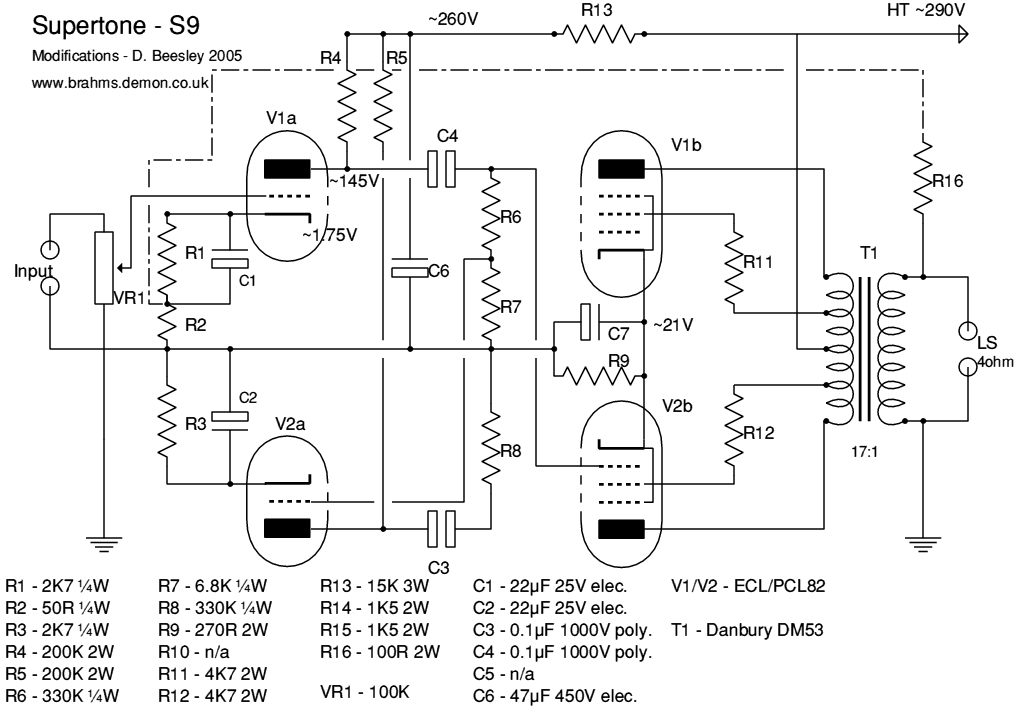

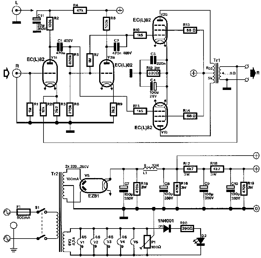

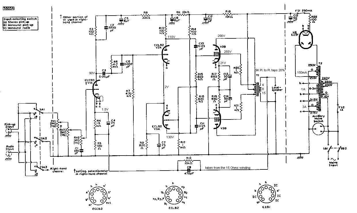

Well. I got some pcl82 tubes and i want to build a little amp. with this tubes.
therefore i search a good schematics. I find some, but I'm courious how to made this that BIGS. (AN)

Hi Mayky,
The AN P-Zero mono blocks delivers 8 Watt each from a pair of ECL82 tubes, where the pentode sections runs in ultra linear (20% taps) push-pull output stage, and one triode section acts as input amplifier and the other triode acts as a phase splitter (but I think they use a driver transformer for this job).
So this is a simple, well understood, and widely available schematic in the internet, BUT with a few variants.
AN UK design is very specific in the way they tap the primary output transformers at 20% to connect the screen grid to get the most power and low distortion from the tubes in class AB2 (I don't think they can take 8 Watt in class AB1, so I believe they use a drivers transformer to run them into class AB2.).
Most of the transformers are tapped at 43% as this is a more common value.
The primary impedance should have a minimum of 9Kohm.

So, You really need the correct driver and output transformers to get the most from your tubes and reach the specified power and distortion.
I believe AN in UK will be happy to sell you the transformers and the schematics as well, I'm sure.

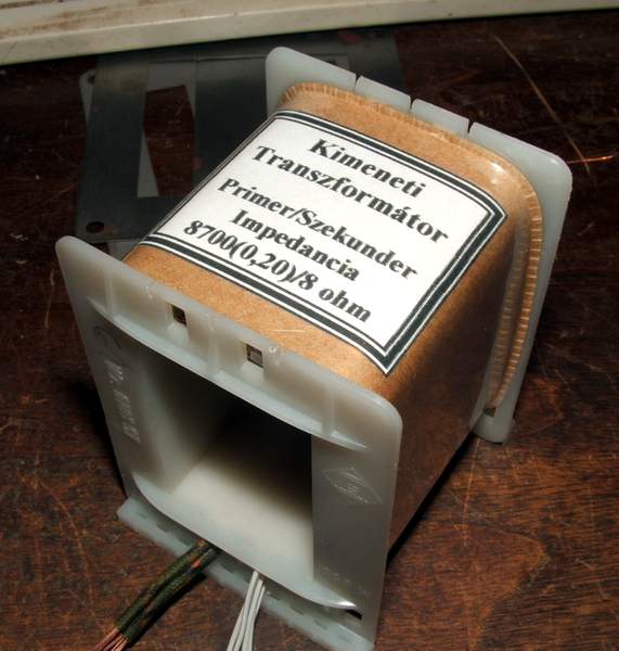

The output transformers will do it by myself. :)
Here is one bobin, this is unloaded ratio. The loaded (wire DC resistance, etc) more than 9k.
This bobin is suit for M85B core, it's about 12-13 cm2

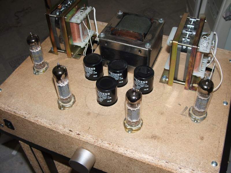

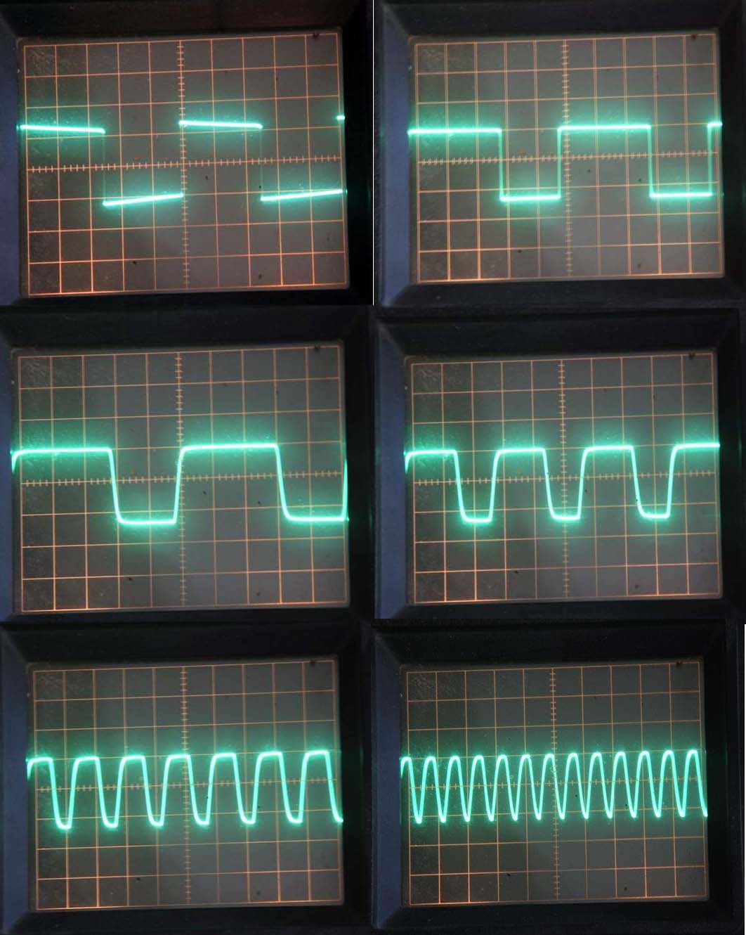

Well I made a test model PCL82 PP. I made some square wave test. I've got this results.
The frequencies:
100Hz, 1kHz
10 kHz, 20kHz
40 Khz, 80 kHz
My audiogenerator is not perfect, but essence is viewable
