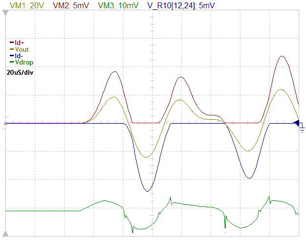

Yes, true, error correction is useful to cancel crossover error that NFB could not reject it most in 5kHz and up, and normally laterals also still need around 250mA bias to get low crossover error.
Also what peavey, I also can't found it with google, I hope anyone could show them. I don't like that spiky crossover error too. I think many people agree we doesn't like that spikes.
I am currently increasing my mosfet bias at HF operation, ofcourse not low bias anymore at high difficulty operation (waste power), but it has low bias normally 10-30mA at idle and normal operation. I still haven't other solution than this for long time.
I post old version here:
http://www.diyaudio.com/forums/ever...si-not-bad-really-i-post-some-proof-here.html
This picture help to show how it work, but I really sorry I am not sharing schematic for now. I can only share on how it work. Picture is showing output stage only without global NFB.
