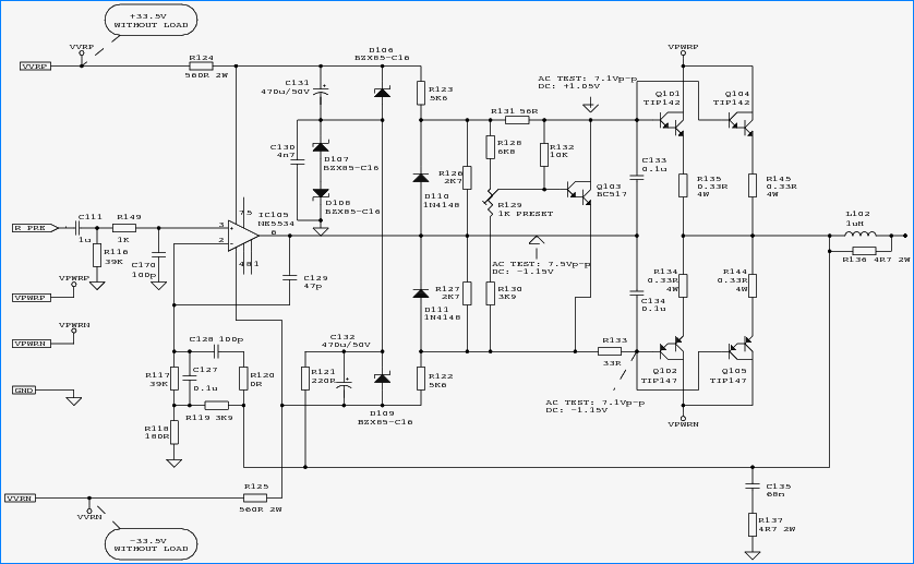

I attach schematic of Puccini SE ( special edition version )

There are plenty of improvements I can think of by looking at schematic.
To me it looks like a very old amplifier, if looking at the components.
Already with those 'old-fashion' semiconductors, it has got very nice reviews, even here in my country.
I have an audio magazine in my archives, with great review of Puccini!
Think what good amplifier it would be, if with an upgrade!
I mean:
Power supply:
+-33.5 VDC Without Any Load
Power transformer:
this is a toroidal 150VA, with dual primary (115+115Vac) and
dual secondary (2x50Vac, each one center tapped).
Gives each channel 75 VA, 2x25 VAC.
Input capacitor:
1uF into 39kohm. ( = 39 kohm x uF )
NE5534 ... okay it is not a bad Op-Amp .. but sure are better now!
VBE multiplier:
BC517 a simple darlington TO92
Output:
TIP142, Two TIP147, Darlington Switch transistors 125 Watt/per device
with Storage & Fall time 2.5 uS and rise time 0.55 uS
Only one pair in standard Puccini.
Two pairs! in SE Special Edition

what is the best currently available op-amp in this unusual application ?
Are here to observe other rules when choosing, as is the case with common applications such as gain stages ?
If not, I would try the AD797.
From reading the website article about this amplifier (written by the designer) I remember he mentioned a few ways to improve performance. One that I remember simulating in LTSPICE was increasing C133 and C134. Wima MKS2 capacitors at 10uF would probably be a good choice. You could also swap the darlingtons for a standard EF output stage and use better drivers and outputs.
