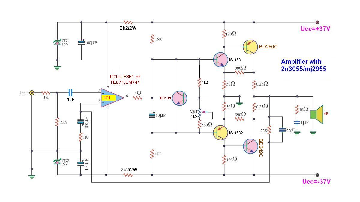

I have the power supply Ucc = +/-(37...40)V/250VA.
For this power supply I need a good power amplifier for 4R speakers!
thanks!
If you want to use the type of circuit that you have posted you must use an opamp that can handle that much voltage.
Else the output voltage swing of your amp will be no more than what the opamp itself can produce and/or result in a burn't opamp due to the overvoltage as the most common ones are only rated at +/- 18V to 22V.
There are ways to increase the output voltage swing and use a higher supply voltage on such opamps but I have not tried any of those techniques yet.
Op amp does not have to swing rail to rail as I explained in post 13. Note that for this type of circuit (CFP) the Vbe multiplier must be thermally bonded to the driver stage and not the output stage.

I'm really sorry to tell, but this is simply not true.
Yes. And it's much easier to establish, with a small heatsink, which mounted together with the 3 TO-126 devices. A small piece of aluminium or copper sheet is enough.

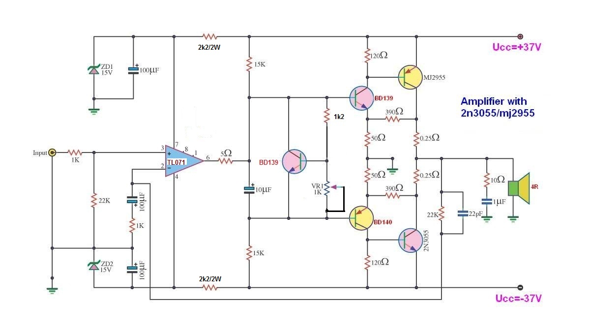

Hi,There are two circuits that were posted.
I was referring to the First circuit in post 1 as that is the same circuit I had made, not the one that uses a Vbe multiplier stage.

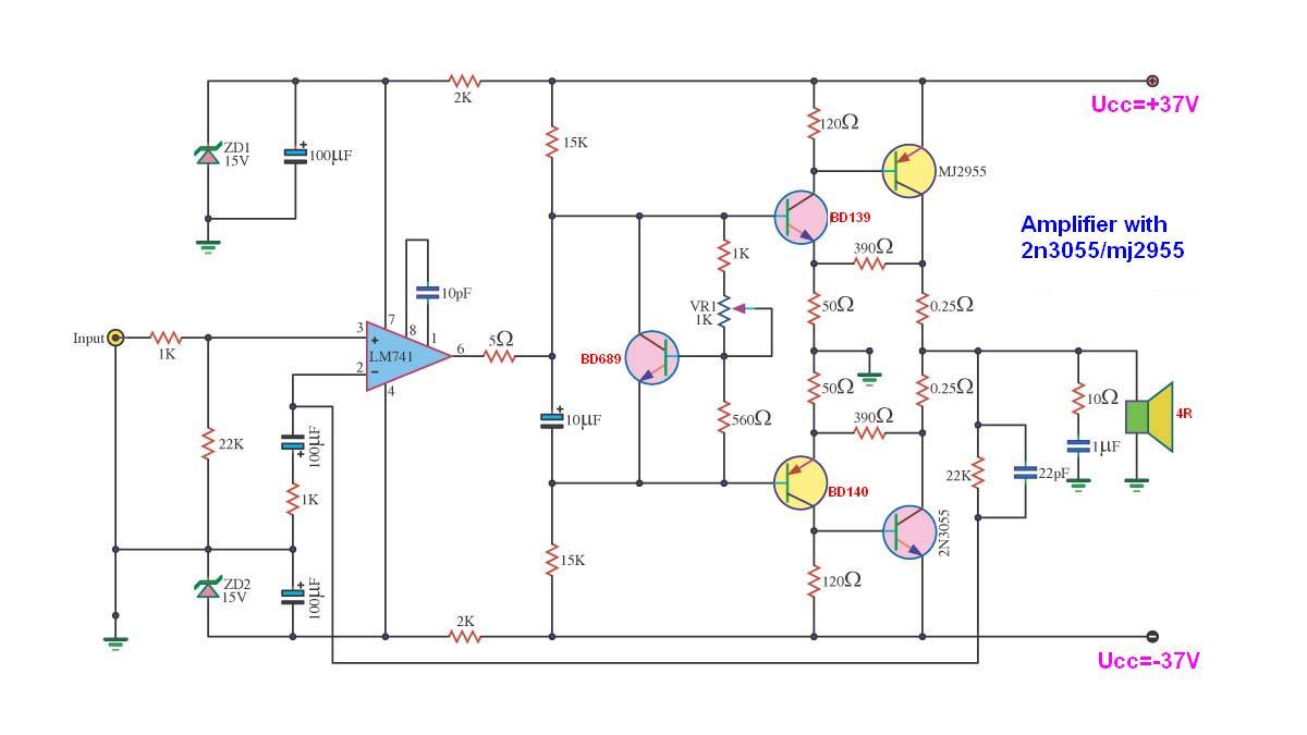

I didn't have running long enough to play music through and critique it as it was just something I through together to see if it worked on my bench and it did!!
I started with a TL072 and everything looked good and then I put a LME49860 in it and all of the waveform's looked very good.
I did have to compensate it for high frequency oscillations when I put the higher gain bandwidth opamp in it.

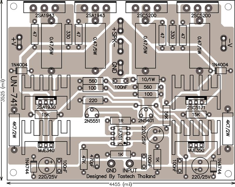

When the whole thing (schematic-diagram and PCB) show here.
For Ucc=+/-37...40V power supply!!
thank you!

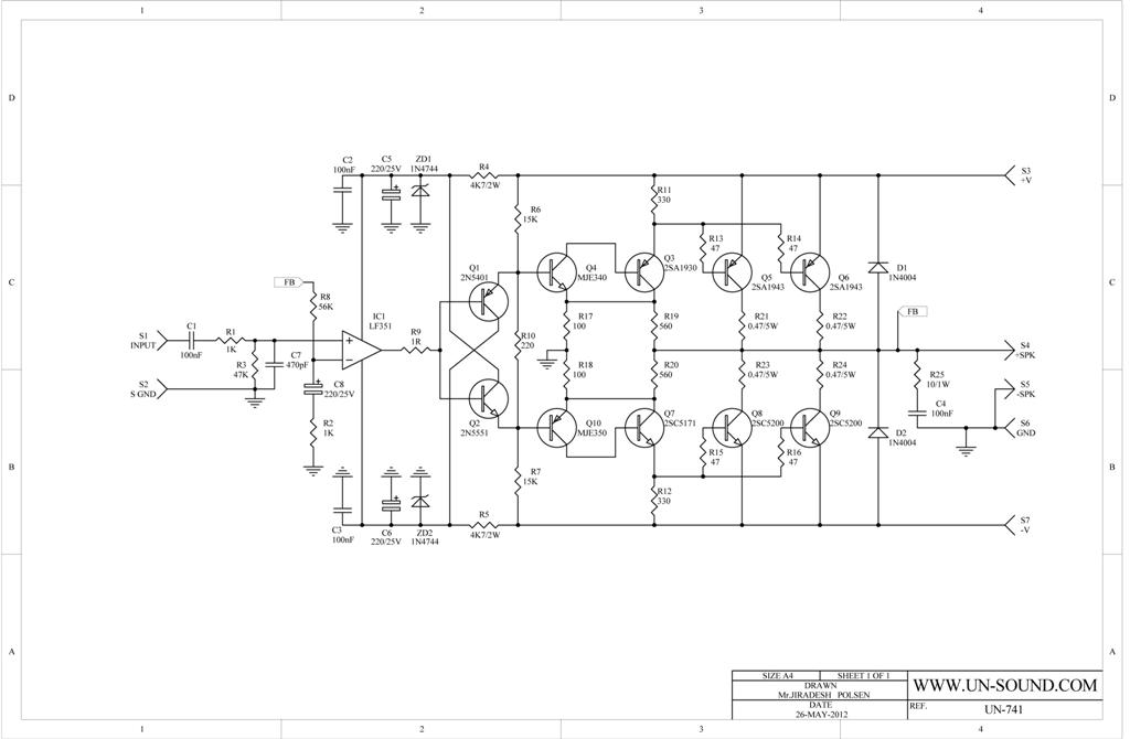

Schematic (circuit-diagram)?This is basically the same circuit as the Texan amplifier Designed by Richard Mann of Texas Instruments. Published in Practical Wireless (UK) in the 70s?

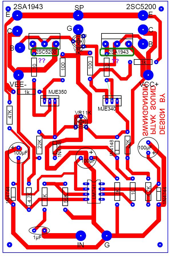

Is this аудио amplifier have made? If you have made such things?
If you are unable display top and lay out the PCB in pdf
