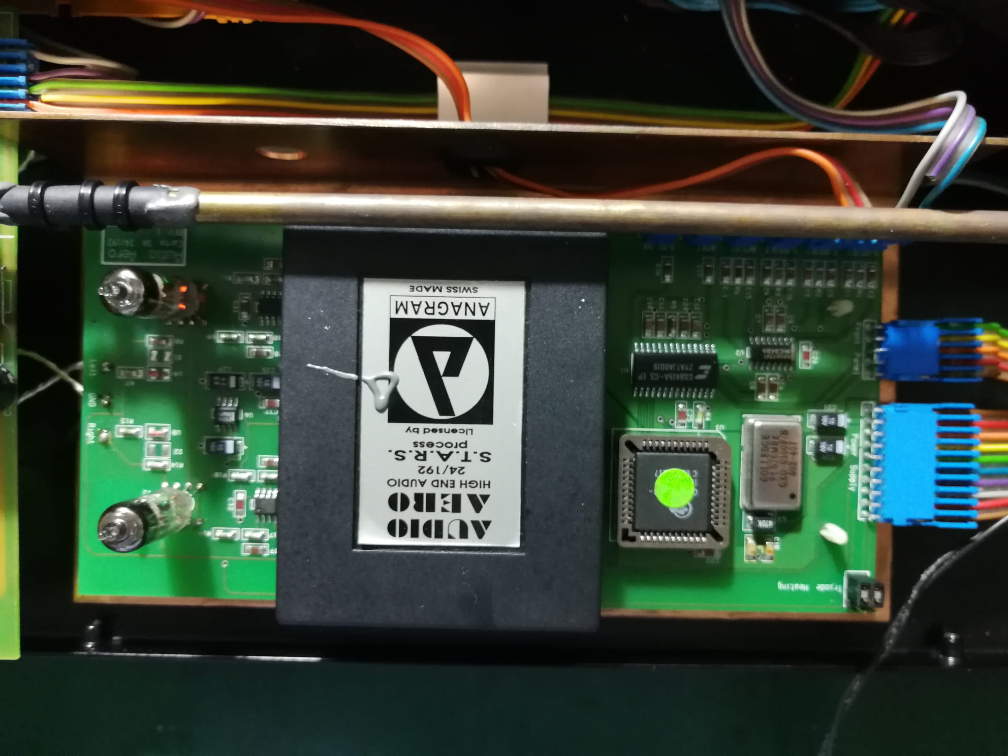

The only thing that tends to suffer in these players is the STARS upsampling processor on the early models tends to go problematic with age.
It's the same unit originally made by Anagram Tech in Switzerland thats used in a few very high end players of the time.
My experience until now is only with earlier players like the one in my profile picture. These tend to be V1 or V2 units. I've had both of these versions fail in my own original machine which was replaced by the UK AA distributor albeit it took well over 6 months to get the replacement and a friends slightly earlier (but still Capitole II) failed with no replacement available.

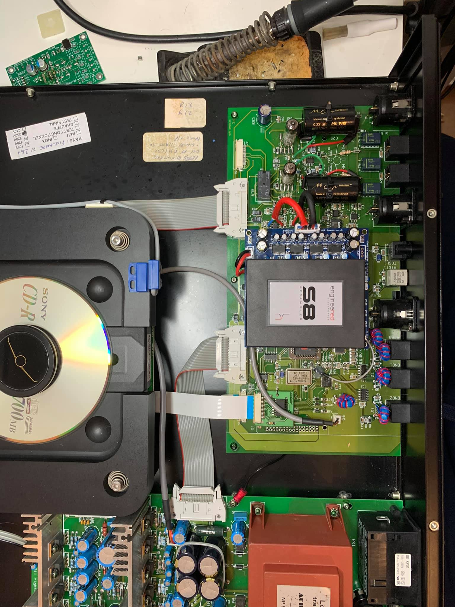

I ended up fitting a much later S8 module and quad DAC setup on an interface board I designed.
Audio Aero S2/8 quad DAC module
Obviously the CD Pro could also be a source of potential issue depending on how much use it's had.
I sill maintain that I love these players and in reality, other than the connectivity options, with the S8 processor there are minimal differences between the early models and the Vermeer Audio Model 2 so far a I can see.

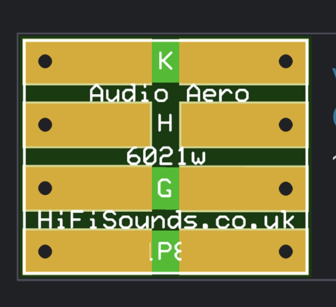

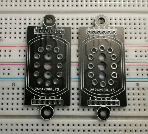

The repair sub boards are produced and on their way to me now.
I plan to hot glue the new pcb section to the main pcb as a permanent fix. I can then mount the tubes normally to the new pcb.

Usually when the STARS processor fails its all or nothing. I've not heard of one behaving as yours does but I guess its not out of the question.
All of the Original units are on borrowed time with that processor unfortunately
My unit is not a plug in replacement for the original unit. Although there are some common connections, the newer S2 and S8 units are designed to drive multiple DACs in differential mono non oversampling mode. To that end, there are 4 DAC's on my adapter panel. Fitting requires adjustments to the I/V stage to take the new summed DAC output and the adapter panel also requires the clock to be sent to the new processor, something that wasn't required on the original as it was derived from the word clock on the I2S input.
The issue I have is the cost of the processor, board and components mean its going to be extremely expensive to try and produce them for sale. Last time I added up the production costs it ran into 4 figures and that was only with a token amount for my time to build. I also have only fitted the adapter onto the MKII version with the earlier PCB version. Yours is totally different and without any service data I cannot confirm how you can integrate.
Unfortunately, this has been a labor of love and I don't see how this can translate into something I can offer for sale across the model albeit I'd love to see these players saved as I believe they are one of the best sounding CD players ever produced with the added ability to play (firmware version dependent) up to 192Khz files.
