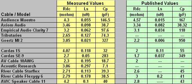

andy_c said:
Just to put some numbers to this, I'm reposting a chart from an article reviewing speaker cables, where they measured the R, L and C of the cables. These numbers are per foot. The article was at audioholics.com
If the amps used were monoblocks and placed right behind the speakers using a very short length of the Goertz wire and no output coil, it seems like one could get some pretty low series inductance values between the amp output and the speaker. Would the improvement be audible? Dunno.
