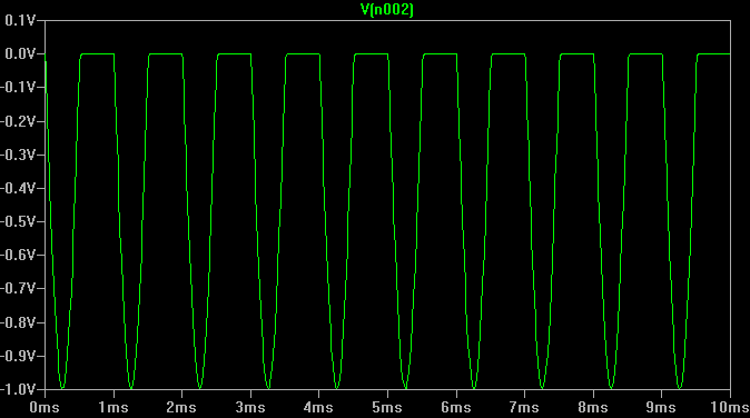

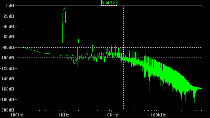

I've been running some sims to explore this using an "ideal" amplifier (VCVS) driving the TS equivalent circuit, for a mid range unit I've measured, via a series 5uH inductor. The input is a 1kHz rectified sine wave (single rectification, not bridge) passed through a 20kHz 1st order low pass filter. This waveform (start of) is not uncommon in music sequences - a drum hit at the end of a quiet passage generates a similar starting signal.
A picture of the input signal is included below. I'll post other pics in subsequent replies.

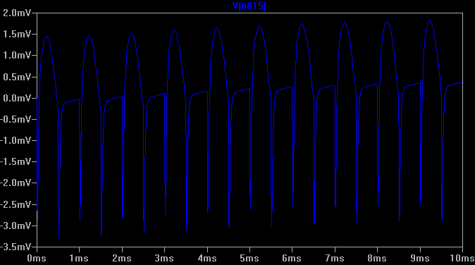

I then differenced the signal at the output of the coil with a suitably delayed version of the input signal to obtain an error signal. Input signal peak value 1V, error signal peak about 3.3mV. I then summed the error signal with the original (before rectification) sine wave in order to get an FFT plot of the result (this is just to get the results in some recognisable format - not intended to imply any sustained error generation). The spectrum of this was very broad with dominantly even harmonics: 2nd harmonic at -62dB, 4th at -67dB, ...., 20th at -80dB. Similar results were obtained comparing the coil output signal to an RC delayed version of the input. I also tried the same test with a 50uH coil and got about 20dB higher harmonics.
The conclusions I've drawn from this are.
1) Stored energy in line to the speaker is bad and generates errors in response to changing amplitude signals - starting from zero is probably worst case but audio has constantly changing levels of various amplitudes.
2) The errors generated appear proportional to the amount of inductance in line: so a passive crossover containing series inductors is also bad and will likely swamp the effects due to a (much) smaller output coil.
Of course, none of this addresses the issue of audibility particularly since the errors generated by a single event are of fairly short duration. Don (AMV8) did make some enlightening observations on this in post #333 however.

Cellardoor said:Next picture is FFT of error added to original 1kHz sine wave.
Hello Tony,
Quite interesting. I understand this last picture is actually the output signal with the coil? Would it be possible to have the same pic of the output signal *without* the coil? I guess that signal will also have substantial harmonics due to the asymmetric waveform. How much did the coil actually add?
What was your output signal level? Would it be possible to post a diagram of the speaker equivalent circuit?
Jan Didden
