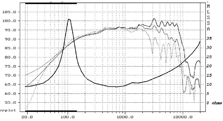

I've worked extensively with PR170M0s and variants (PR17HR70, PR17HR100).
I too, would limit low end extension to no lower than 400 Hz, 18 dB/oct, or 500 Hz, 12 dB/oct. IME, for a more "public address" application (which is where these drivers see their most usage, ie, in several EAW and Peavey high-end cabinets... Audax OEM supplied the PR17 to these manufacturers, among others), a range of 500-5000 Hz is QUITE usable... I tend to use these drivers in a small enclosure (Qtc of about .8 to 1.0), with a silght overlap between the woofer and midrange, and a slight "underlap" (gap) between the midrange and tweeter. Also, using a slightly lower-Q low-pass (ie, larger inductor and smaller cap) on the top end of the PR170, will also benefit the response greatly. For the most part, if you use the tricks specified, the response will wind up pretty much ruler-flat. .. the "rising response" will be very well compensated for. Exemplary dynamic range and control...
For a "hi-fi" application, using them in the range of about 400-3200 Hz (three octave spread) would be quite nice. Avoids most of the breakup, and what you do get, does not color the sound to any detectable amount. GREAT driver. My first choice for high-efficiency 3-way systems, even to this day...

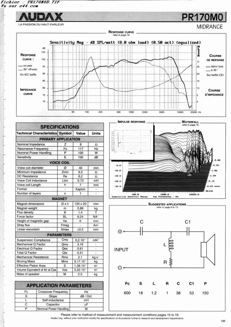

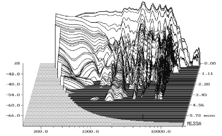

Wow, the waterfall looks a bit nasty! Sounds like GordonW was saying that the first few resonances sound benign and just watch out for the one around 6.5kHz.
As well, this:
Referenced to pro 500-5000 Hz, sounds like HP: 2nd order at 5k (15ohm@5k) with lower Q and LP: 2nd order at 500 (with a bit of boost from higher Q cab)
Hmmm ... sound right?
And then I would apply this to the 400-3.2k he recommends for home use.

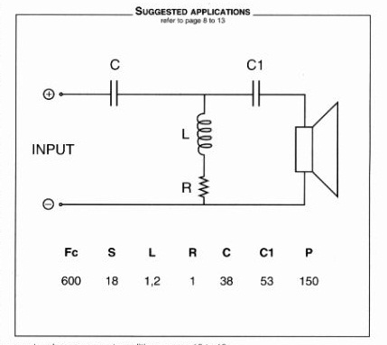

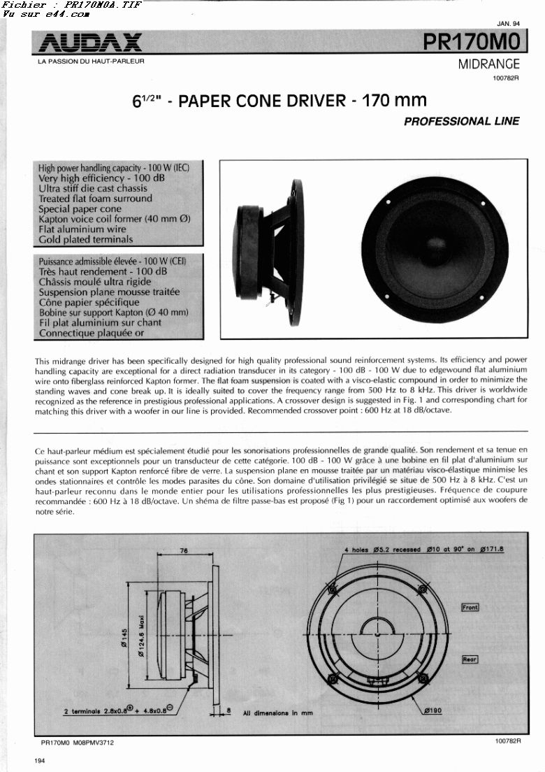

Found these in the archives:
Recommended 600 Hz crossover (R = 1ohm so that's not just dcR of the coil ... hmmmm):

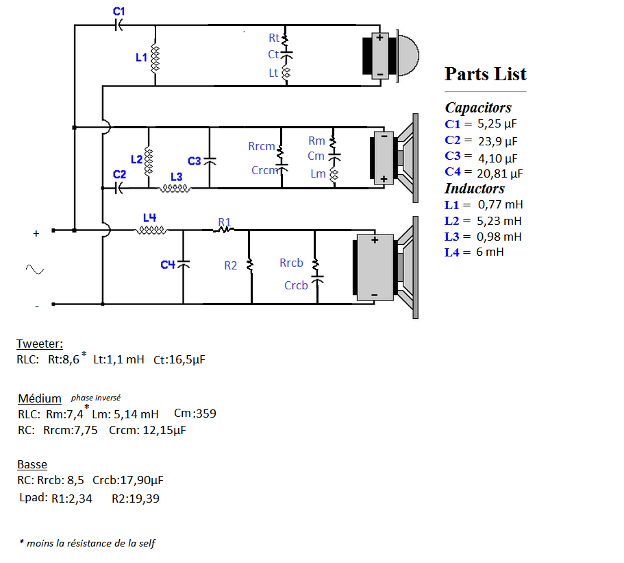

And this from the web:
PR170MO et TW025A12
And an interesting idea from Thorsten:
http://www.diyaudio.com/forums/multi-way/55299-pr170m0-appreciation-club-new-member-questions.html
