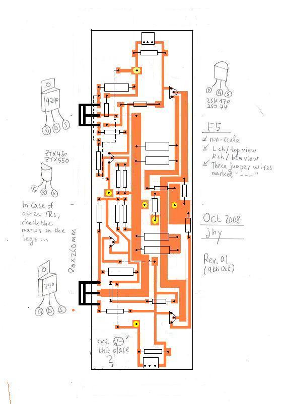

It cannot be better than yours, it is yours. Just went over your work with some minor changes.
I bought some more boards today, and also some etching powder, same as yours, 400g. So I hope that it will be enough.
I will work on my supply boards tomorrow, see what I can do to get them semi-completed.

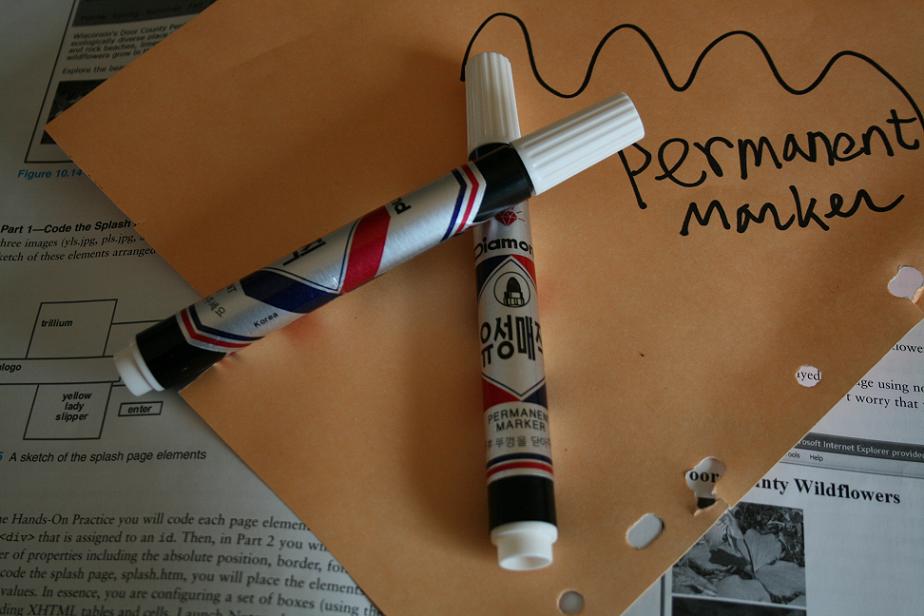

Etching pen?
I droped by a stationary shop and bought a permanent marker (oil) pen.
Cheap and useful . . . !
After the marking, wait for a day or two till the marks are entirely dried off.
Good luck
enzedone said:... I also got an etching pen, but ...only about a quarter way through drawing my first board and it has run out.
Etching pen?
Good luck

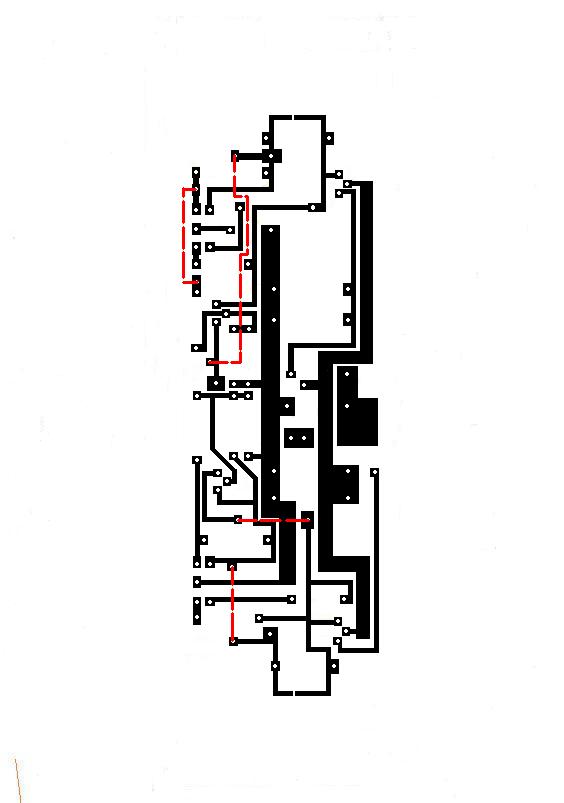

PCB Design
Check this out, this is an excellent way to create layouts. Just found it now.
http://tacashi.tripod.com/elctrncs/pcbworks/pcbworks.htm
Brett
Brett

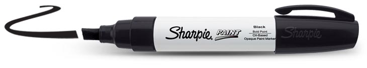

Pens
Wow, you would not believe it has taken me two days to track down an oil based marker.
We just don't stock them over here.
But This is what I've found on the net.
I will drive down today and look at a special art supplies store,.......50km and counting to track these down.
Sharpie Markers
O.k
Here are the Sharpie markers that I have found. They are oil based and come in two sizes.
I finally found them, but will take a week to get these in, welcome to New Zealand.
Sorry can't attach file
Sharpie
Models are:
SH4001
SH5001
One is 7mm, the other 15mm
Brett
O.k
Sharpie
Models are:
SH4001
SH5001
Brett

enzedone said:...
I removed the added caps and made some of the holes slightly bigger as well.
I have wondered why you considered the additional caps--i.e. the supply bypassing.
A book says that bypassing the supplies is almost always essential with ICs. The bypass capacitors should be located as close as possible to the IC. Yeah. . . with IC. . .
I understand that the bypass capacitor prevents current feedback caused by long lead between the circuit and the power supply. But, in this F5 case(, which is different from the ICs), the original has no bypass capacitor. Probably based on the kitchin table test results. . . ?
Circuit
That was not drawn up by myself, it was done by a guy on the F5 thread. I don't really understand why they were put in either. But there are some really knowledgable people who know waaaaaaaaaaaaaay more than myself.
Including you,
But for me, I think it would be safer to just stick to the original layout.
How is your amp board coming along? Have you traced it onto your copper board yet?
Including you,

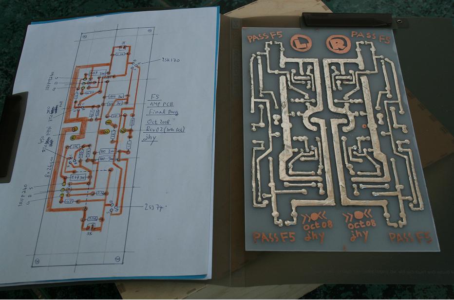

My wife pressed down the "pause" button, saying I should not do any physical effort yet.
Yes, I am still in the middle of the anti-cancer chemotherapy treatments. One treatment takes three days for total four injections (each injection takes 1.5 hours). After the treatment, I feel easily tired and feel as if my body was being pressed down by something, for ten days. And, next ten days I feel getting better little by little. But, after this 20days, I have to visit Dr. again for the next treatment. . . Ayo. . .
I have got three treatments, one week later I might need 4th treatment, or not, depending on. . .
Mmm. . . better to wait few weeks. . . for the next progress of my F5 construction.
