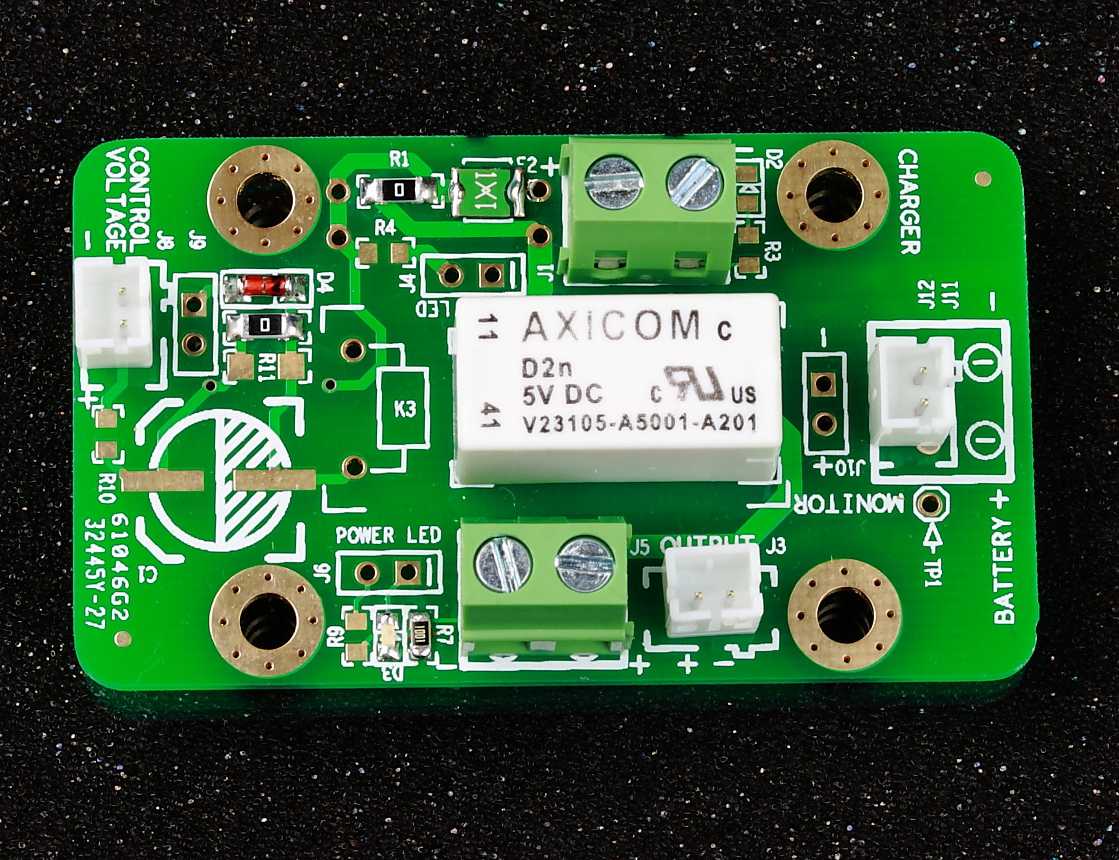

BOM of standard configuration of Passive Battery Management Board
Testing group start receiving the PCB. Someone may get bit confusion on the schematics and BOM. Actually the standard configuration is very simple, just a couple of components. I post a picture of this configuration below. It should be a good start point. More features could be added step by step later on. Just hope it’s clear enoughJ.

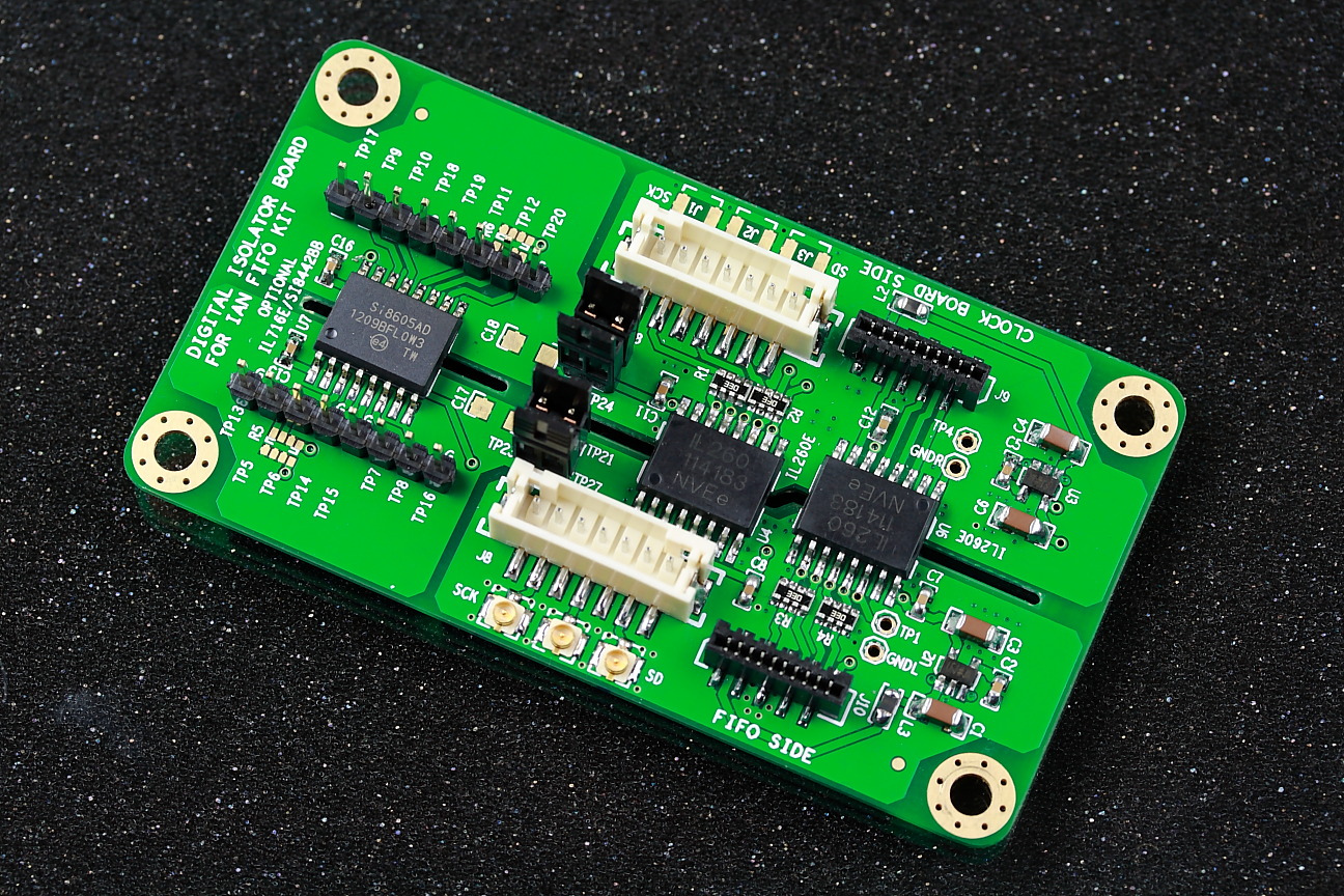

no, not on the board, but in lightning quick response to a suggestion, Ian whipped up this separate isolator, which doesnt just isolate USB, it isolates everything. its placed between the fifo main board and the reclock board, so everything including the fifo CPU itself is isolated immediately before the reclocking process, a much better idea if I do say so myself =) placed here it makes it so the reclock board and clock become part of the dac, not part of your source.
at this stage only the prototypes have been sent out to testing after Ian verified it himself, in fact pretty much the last 20 pages have been about the battery board, Si570 clock board interest list and the isolator.
so its not available for purchase just yet, not till we've finished our testing, but I feel confident it will be standard issue for most people from now on.

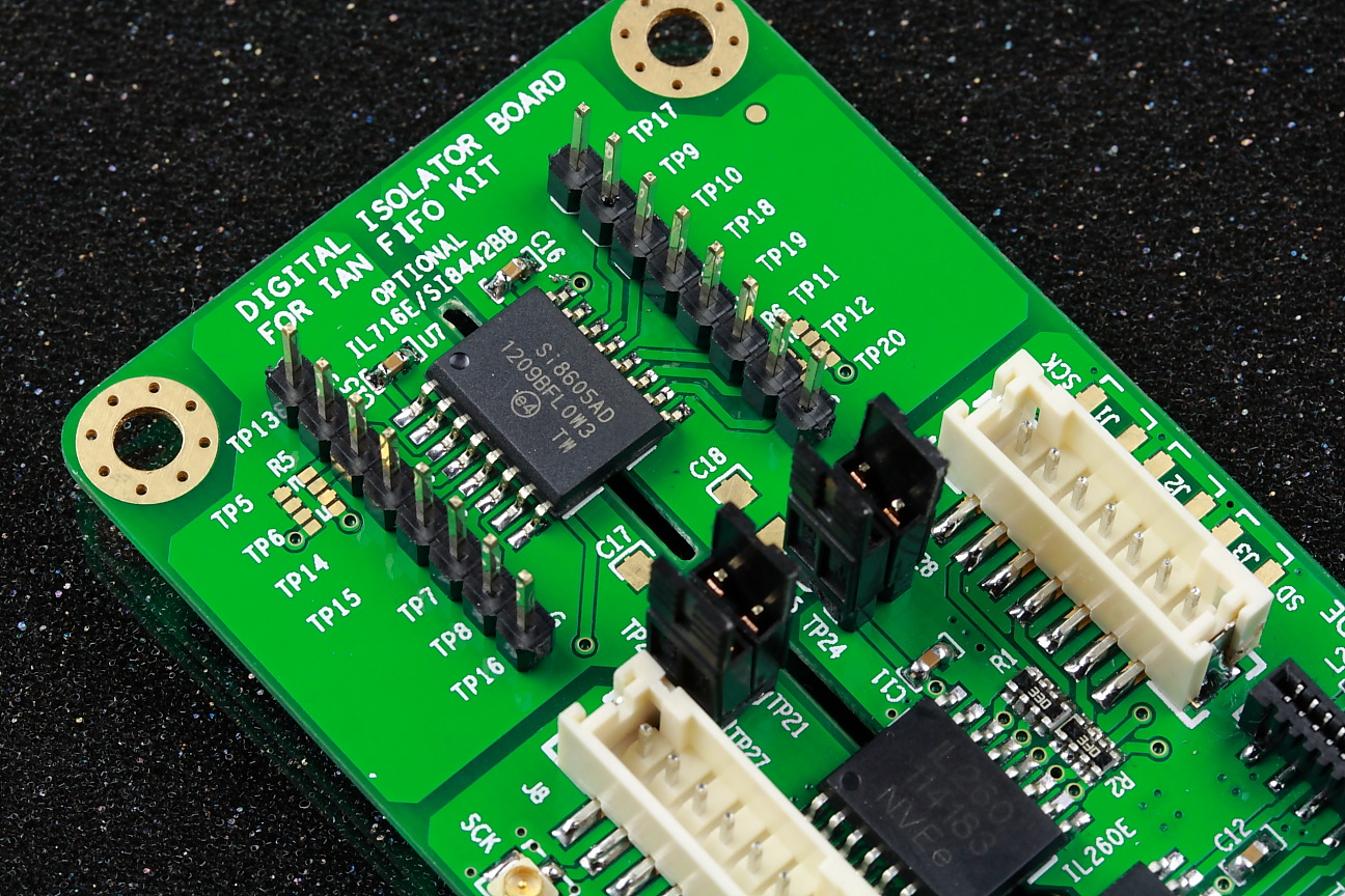

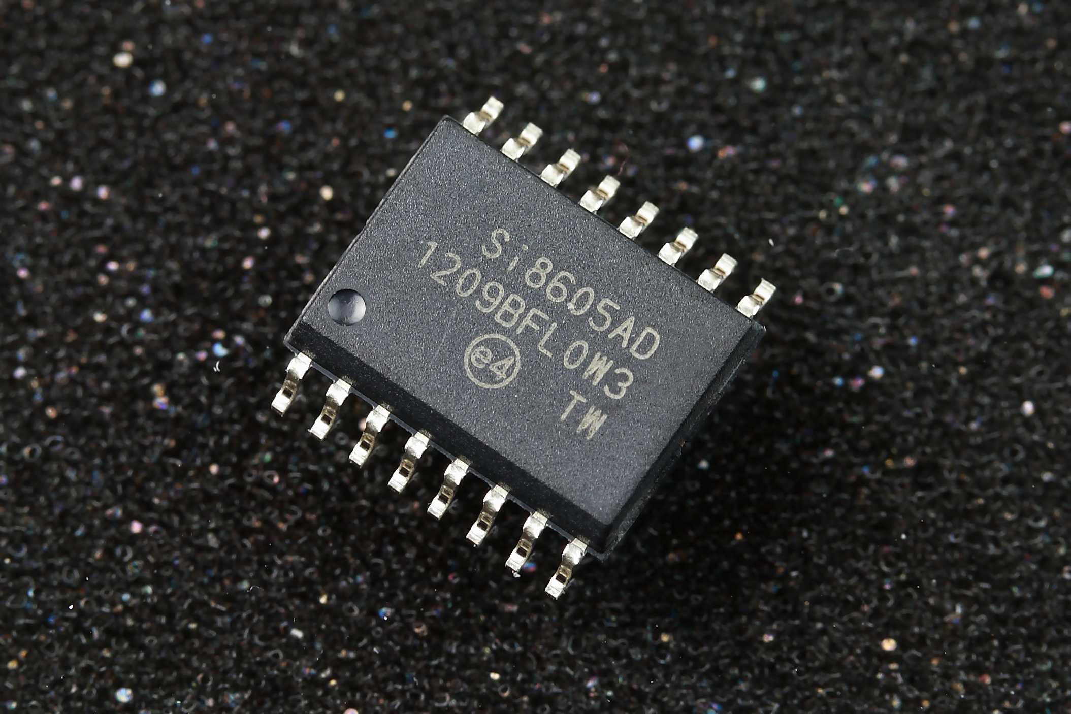

Assemble Si8605AD I2C/USART digital isolator to the FIFO isolator board
Si8605 arrived yesterday. I assembled it to the isolator board. It will work for ESS9018 with external controller. Just fit the reserved PCB footprint on the FIFO isolator board. Pull up resistors might be required for the I2C bus on both sides.
Digikey P/N: 336-2053-5-ND

Ian, it Looks beautiful.

I received your power management board, I just want to confirm the resistors to make sure I didn't do a silly mistake:
1. R1, 2, 5, 6, 8, 10 are 0ohm
2. R11 is 100ohm
3. R3, 4, 7, 9 are 1kohm
4. R12, 13 are short because my -ve is Gnd
