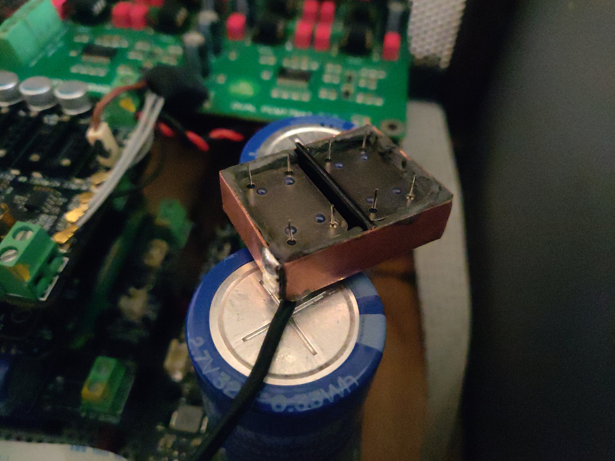

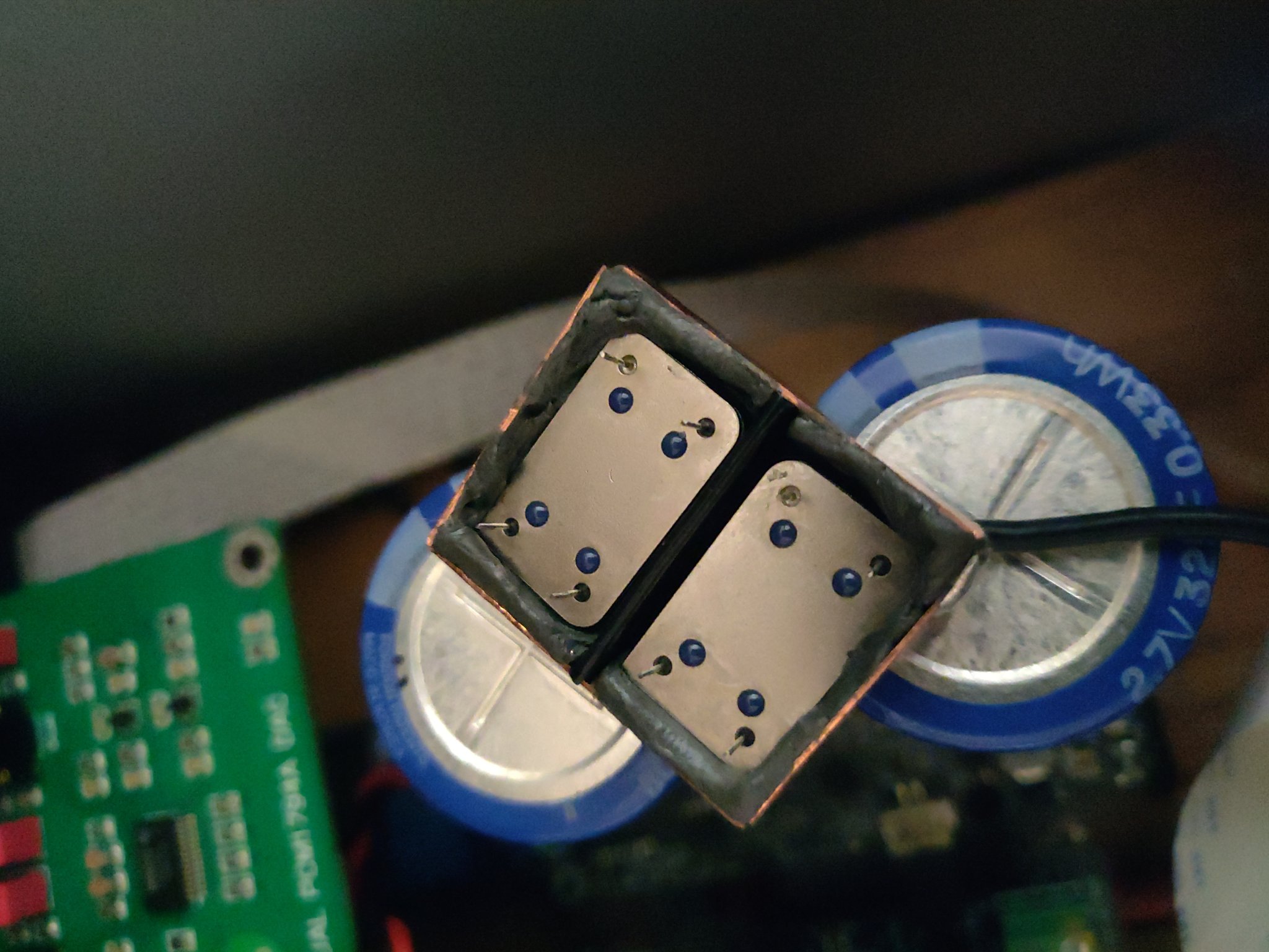

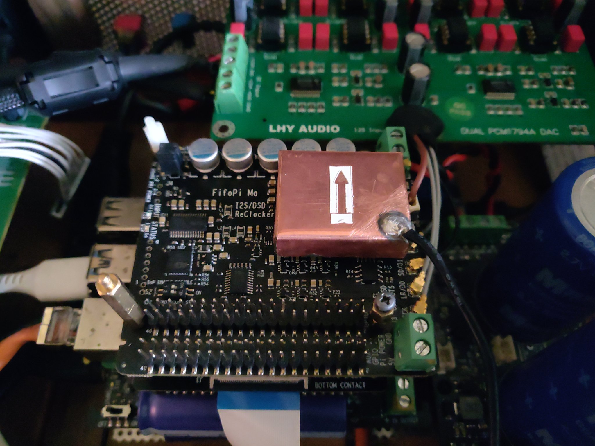

Can you post a pic of this? Just trying to get an idea on how to dampen the clocks and or shield them
I do it this way. copper shielding with earth and secured all around with Blu Tack. a small piece of foam at the top inside so that the clocks do not make contact with the outside off the copper shield.
I use ACCUSILICON clocks.
Due to the weight of copper and blu tack it remains nicely pressed down.
You could of course also secure the bottom with blu tack, I didn't think this was necessary.

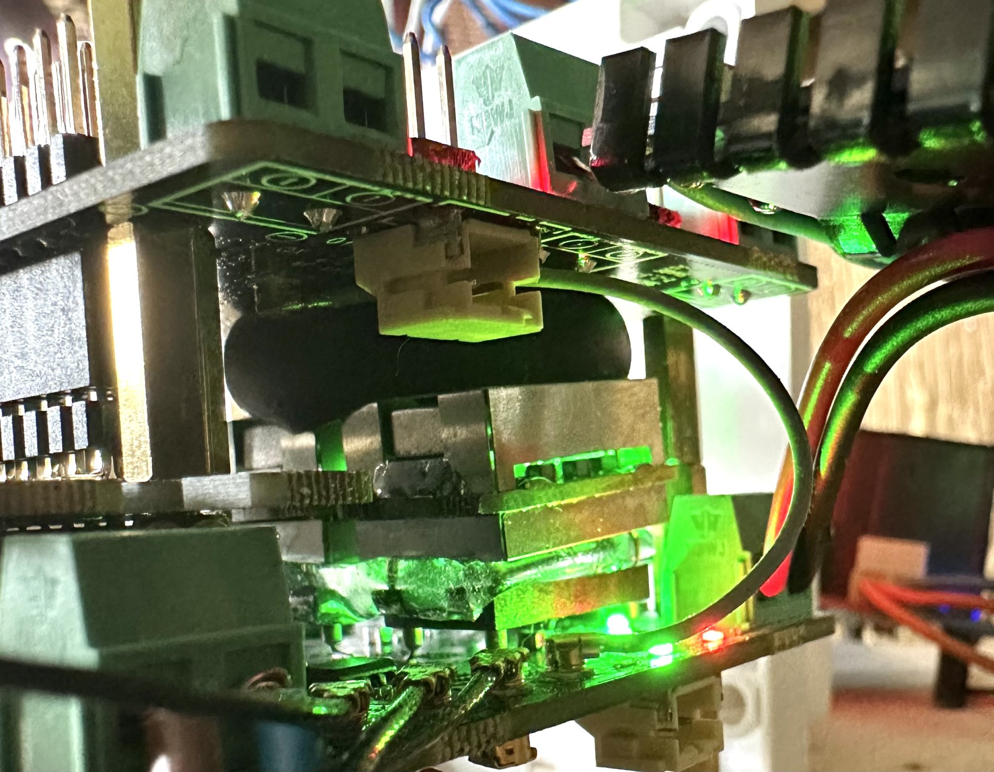

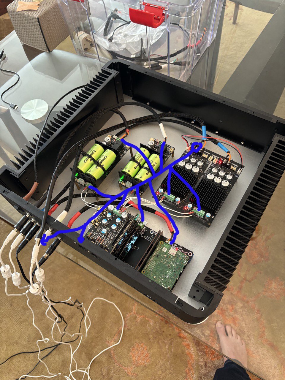

It seems the issue lies with the type of connectors you're using when mounting them to the case. Based on what I see, your case is attached to the negative pole of your Raspberry Pi, FifoPi, etc. Then, you connect your input power to the same ground, effectively connecting your Linear Pi input to the output.
so all the blue lines terminals are connected see photo attached. I am surprised you have not damaged anything.
I recommend using different connectors altogether for all components, or at the very least, changing all your power input connectors so they do not connect to the ground. It's important to note that your connector's metal screw is connected to one of the two wires of the input (black wire ), if the metal screw is not connected to anything then ignore all this.
hope this help you see what I am trying to say. View attachment 1290045
Thanks you very much, @Gabster 2000 , it appears you were right! I changed out the connectors on my dc cables and everything is now working perfectly. My system has never sounded so good. Accuphase E4000 integrated amp with Sonus Faber Auditor M SE speakers. Heavenly!
