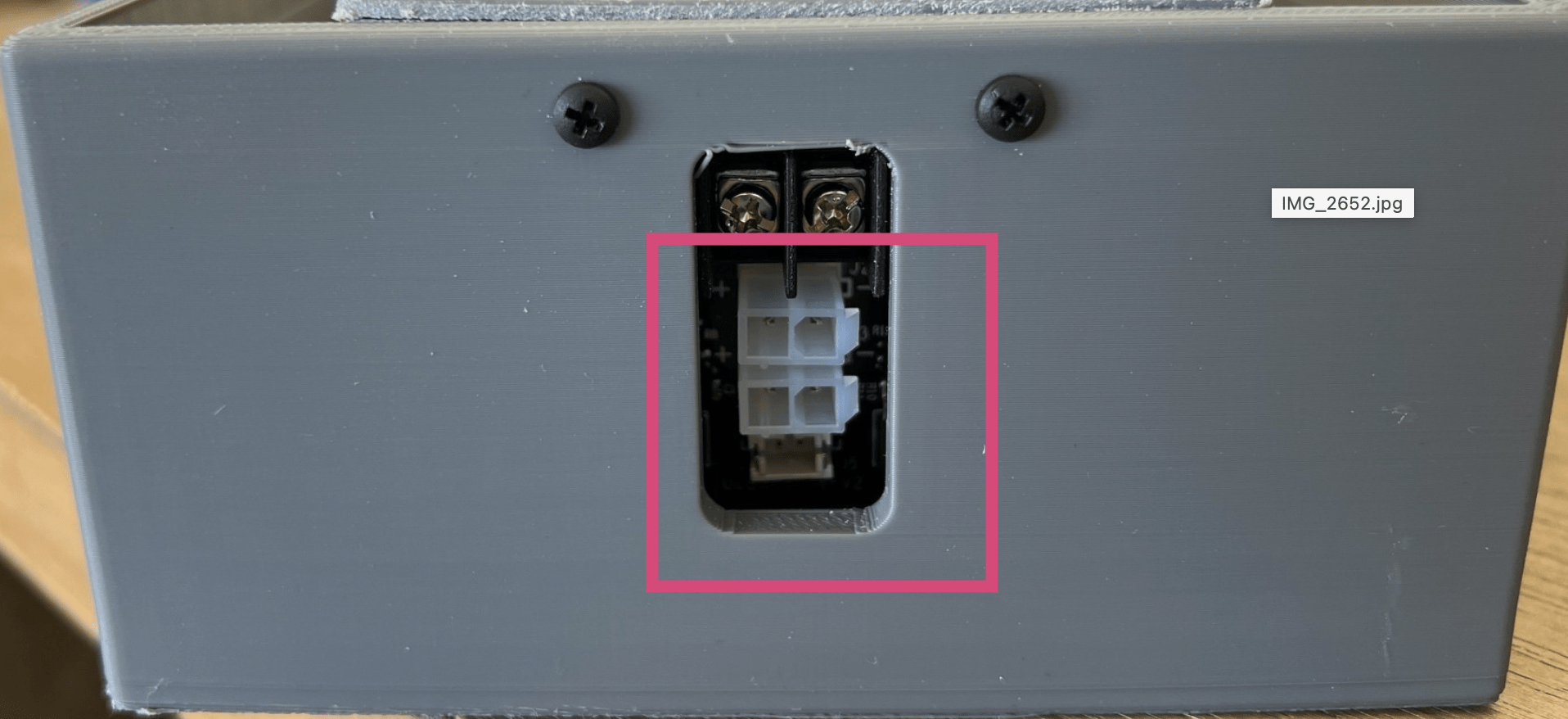

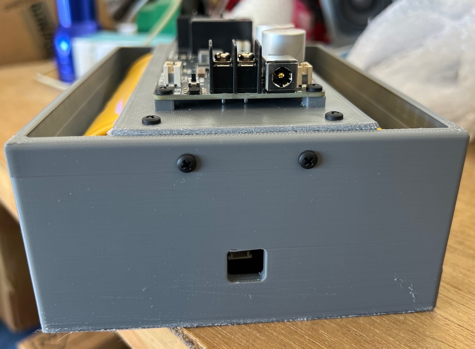

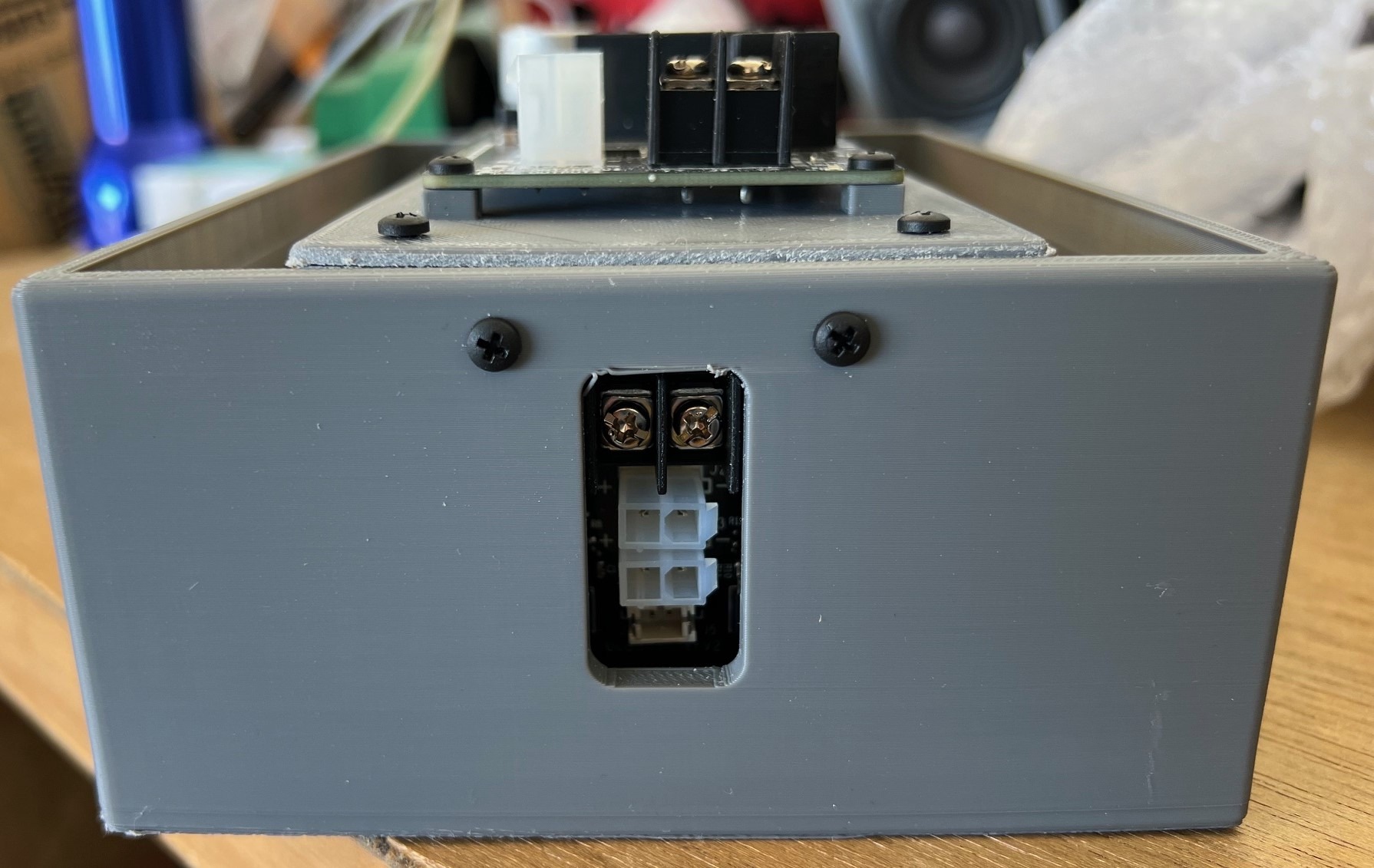

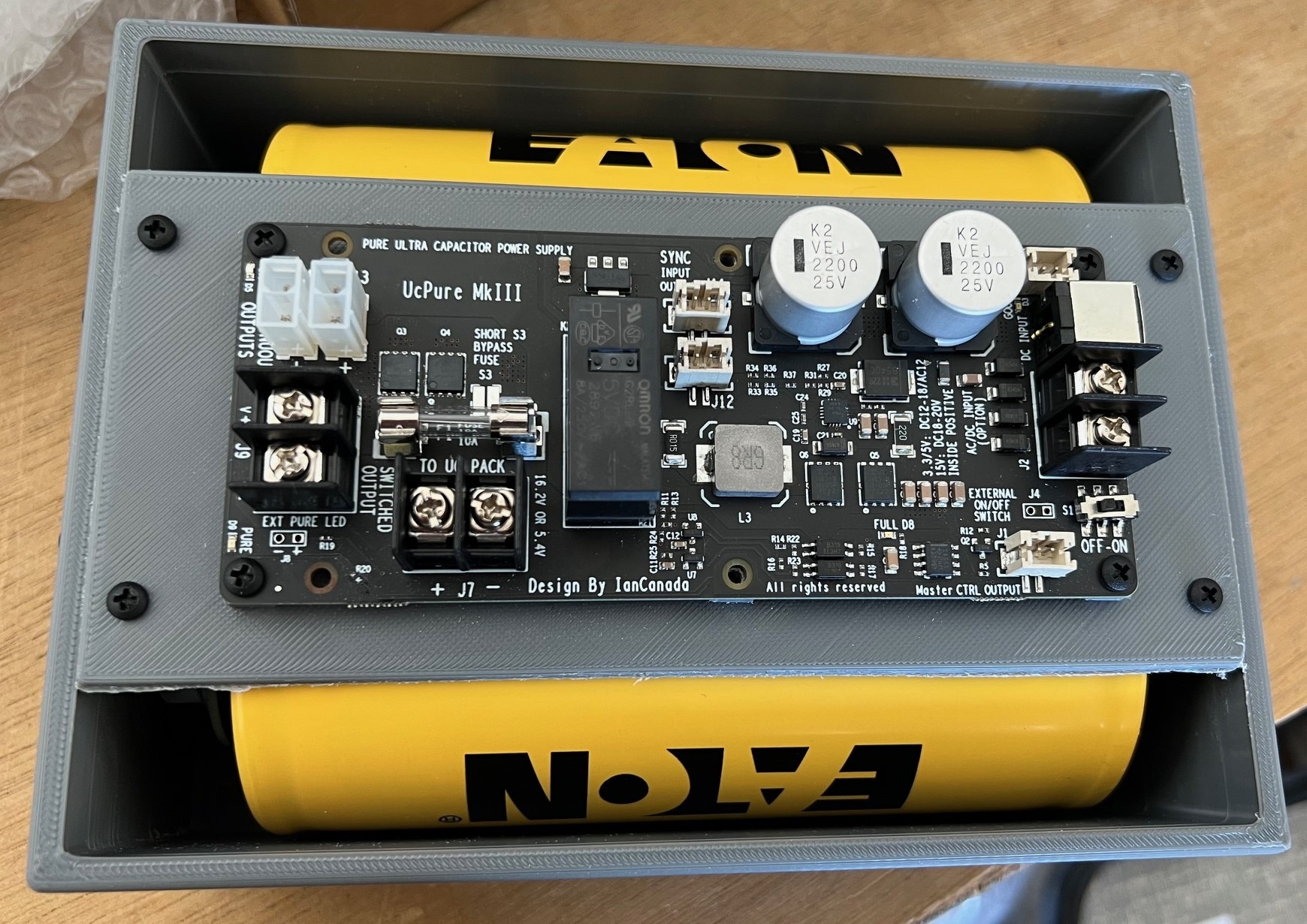

@Ghostship
The bare minimum values are as follows
6 11/16" in length
4 7/8" in width
2 1/2" in depth (capacitors only)
The total height with the board mounted on top is 3 9/16" for me. You can shorten that by probably 1/8" because I made a mount for the board. But, if you heat shrink the super caps it will add back 1/16" or so
I 3D printed this. You can PM me if you want one or more
  • Thank You
Reactions: 2 users
I am not sure by looking at the picture but I suspect one may have a problem putting a connector through this whole and even bigger disconnecting it. There is a "clip" you need to "squeeze" with a palm in order to disconnect.
Reactions: 1 user
