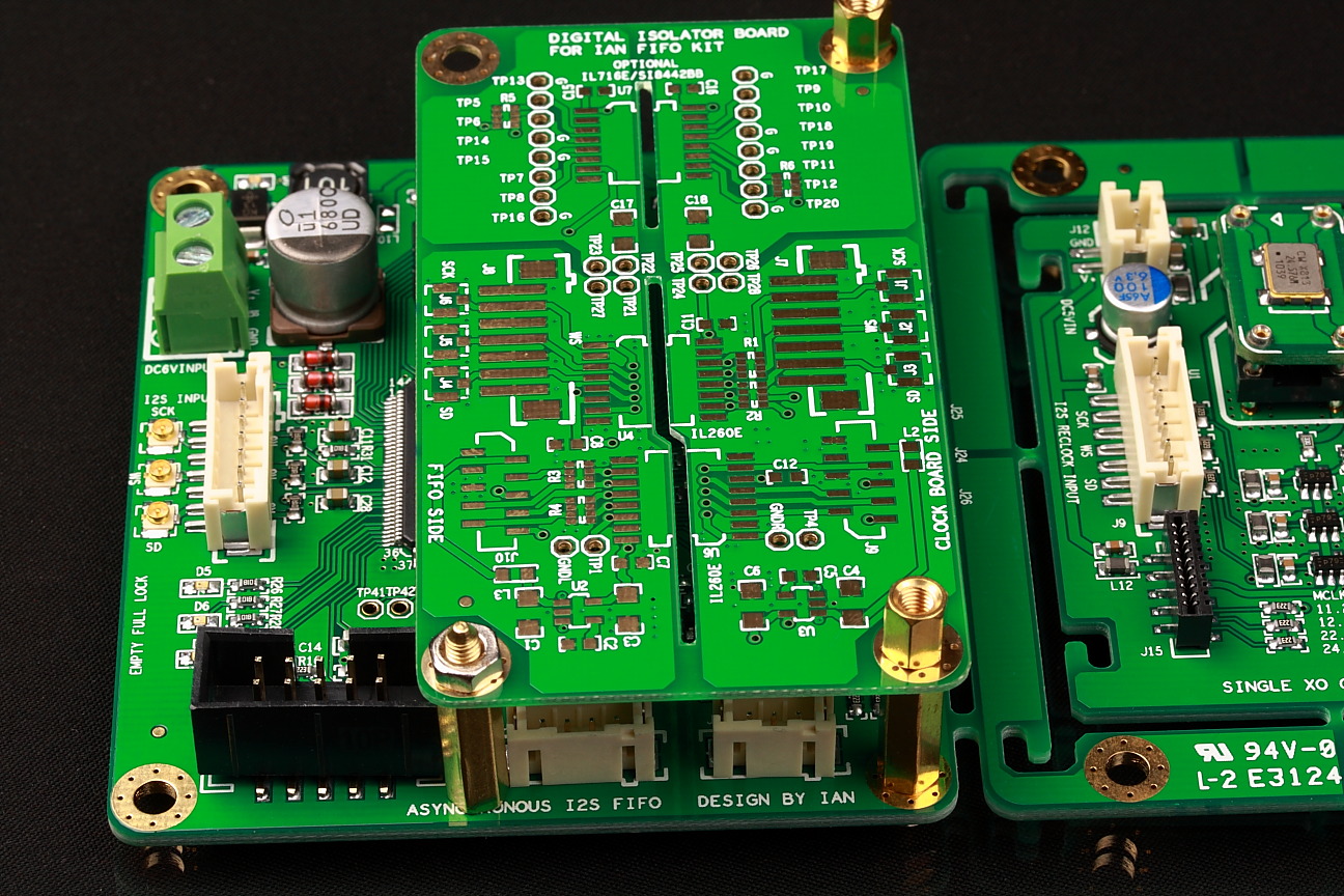

Schematics and PCB pictures of Ian FIFO galvanic isolators adaptor

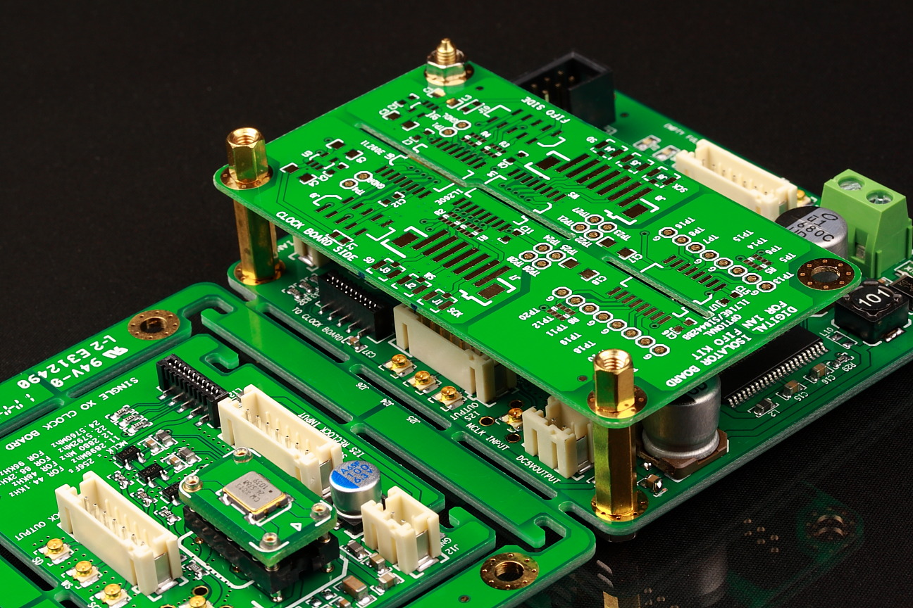

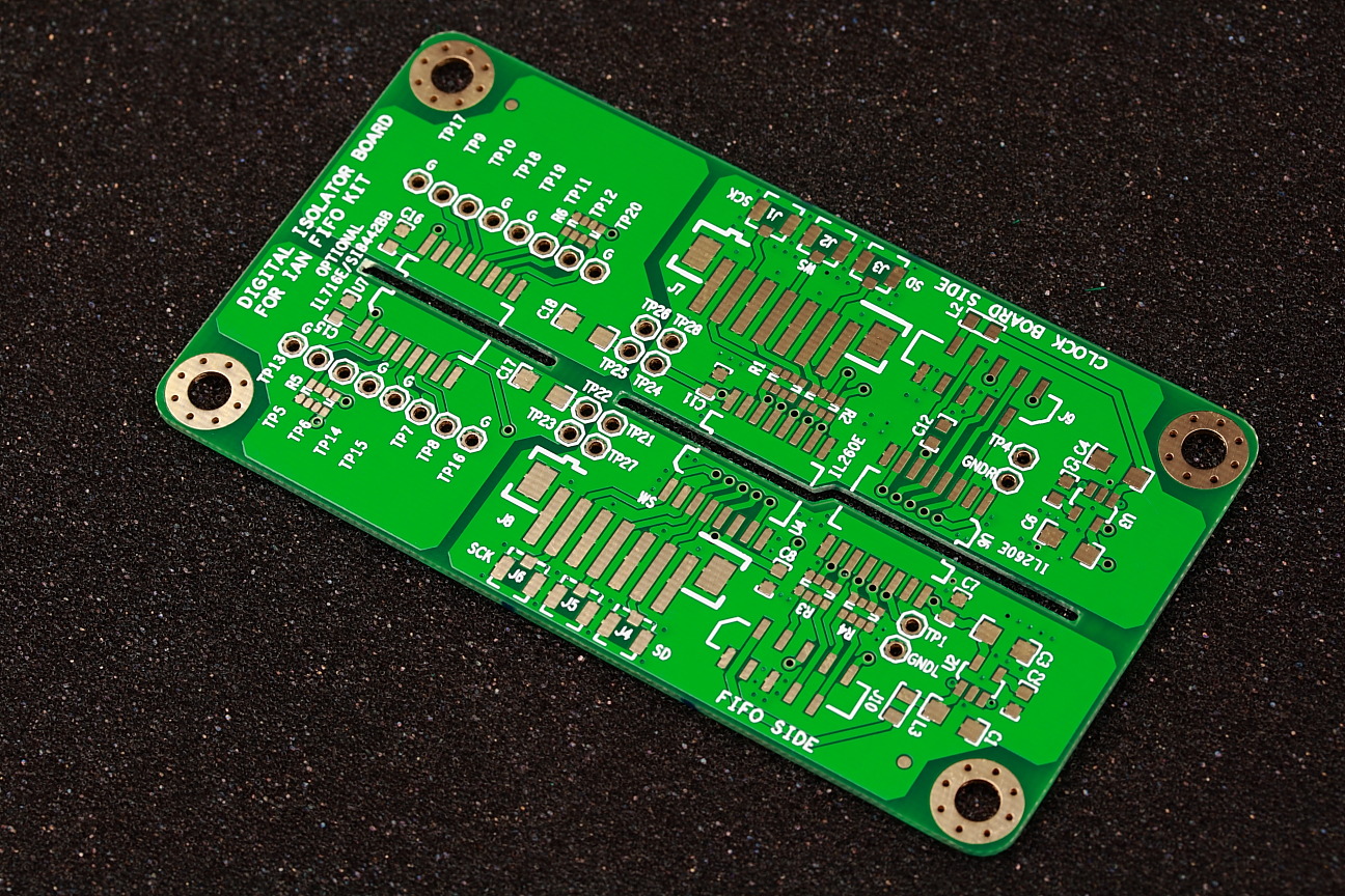

Got the isolator PCB samples today. It looks nice. Schematics of this isolator board (with BOM) attached at bottom of this post. Digikey P/N included for ordering the BOM components.
This isolator adapter designed with mounting hole positions as same as clock board. So, it could be not only placed between the FIFO and clock board, but also stack on top of the FIFO board. It works as a bidirectional bridge between FIFO board and clock board providing galvanic isolation without degrading any function.
This small board makes the clock board and the half of the isolation board only as part as the DAC, isolating the EMI noise introduced by ground plate and signals from the digital front end or other devices, thus the improvement on the sound quality is expected.
The isolator board powered via the 10P FFC/FPC cables by the FIFO board and clock board from both side. So, no any power connector is needed for the isolator board. You just need powering the FIFO board and clock board with different power supply which could be isolated from each other.

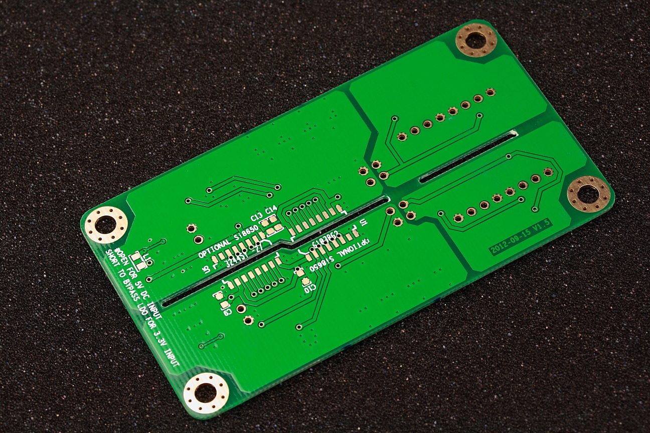

Footprints of optional SI8650BC were placed on the bottom side of the PCB. They can be the good alternatives to the IL260E. Please see the schematics for more details.
At least one FFC/FPC cable longer than 3” is required. As well as a 7P PH2.0mm cable. Or, you would be interested in trying three u.fl cables if you think the PH2.0mm cable is too big.
It's not a high density board, so the SMT assembling will not be difficult. But soldering the four 0603 resistor packs would be a little challenge. Two of them were placed very close. Highly recommended using the SMT re-work station with air temperature control function, rather than a regular soldering iron.

Bug found so far: TP2 and TP4 reversed on the PCB.
