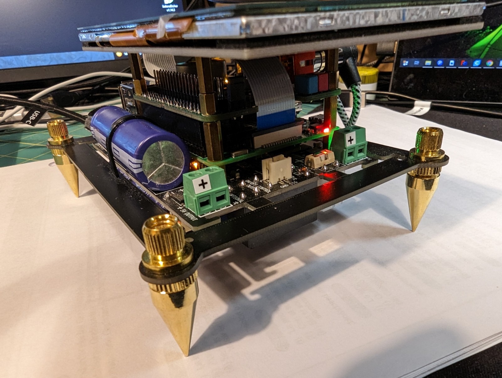

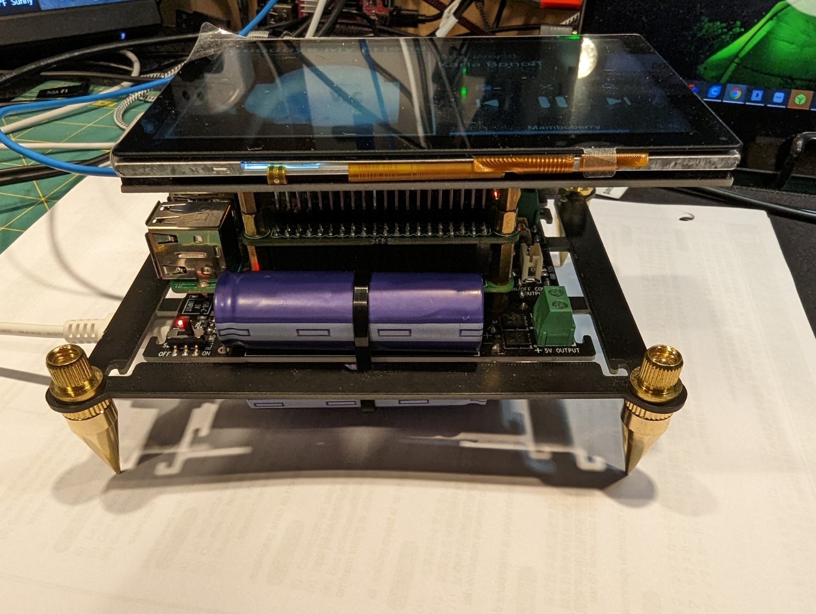

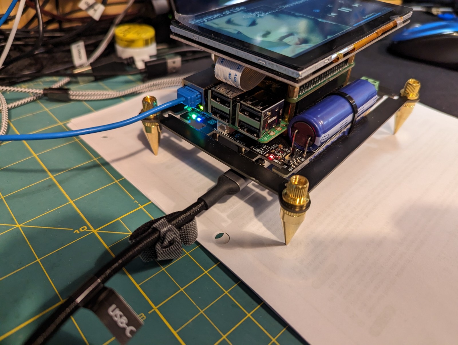

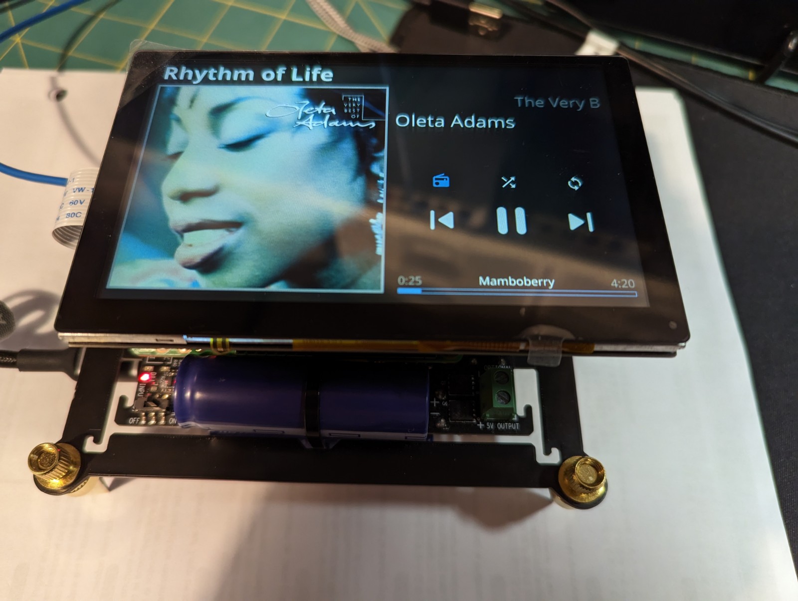

While I'm waiting for some parts to arrive for my next projects, I'm re-visiting Ian's PurePi battery and super cap kit I bought a few months back. This is a fascinating little PSU. Clearly it was designed specifically for the RPi. Ian has once again shown us his genius. Powering through the GPIO with the tiny spring contacts works superbly. 🙂 Focusing on DAC's power supply can (and will) make a difference in the sonics. This little board allows for all the voltages you will need to get a simple DAC/Streamer up and running.
I took an 'older' DAC hat I had - the MamboBerry LS - and put it atop the RPi. I then added a little 5" LCD and configured ropieeeXL (my roon bridge) to provide a rudimentary means of simple transport and artist/album art to the mix. I'm still surprised and amazed at the quality of sound coming from this combo. Keep in mind, the MamboBerry is like 5 yrs old, but used the ES9023P, 24-bit DAC. Anyway, thought I'd share some pictures of it. Now all I need is to dream up a nice looking enclosure to show-case it. 🙂

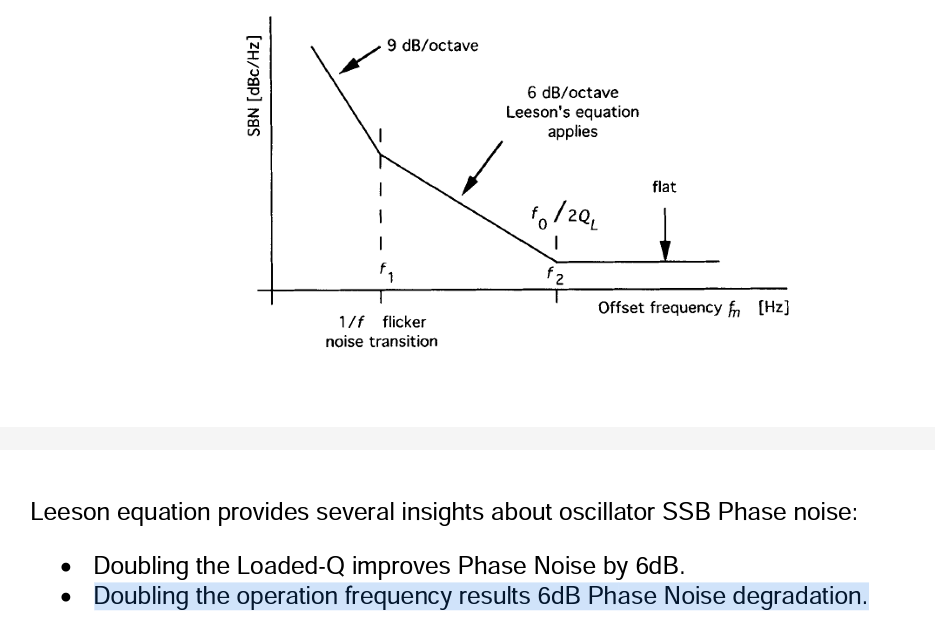

@paulca
To select higher or lower MCLK frequencies is a very good question, But it would be a long story.
Different DACs take clock frequencies differently. R-2R DACs don't use the MCLK directly, they just use up to 384KHz SCK which is generated by MCLK. But ESS D-S DACs can take MCLK higher than 100MHz. D-S DACs may also divide the MCLK down to lower frequency internally to match the Fs. But no matter what, we will need at least one MCLK at a time in the system. Basically lower phase noise or less jitter MCLK result in better SN thus the sound quality will be improved. So it's all about the jitter and phase noise.
To select higher MCLK or Lower MCLK, it's the question.
Based on Leeson's equation, Doubling the MCLK frequency results in 6dB Phase Noise degradation. While, each time dividing the frequency by 2 it will lead to 6dB phase noise improvement. (This is the principle, in the real world, there will be more consideration)
https://en.wikipedia.org/wiki/Leeson's_equation
So, if you have two AT-CUT clocks at similar phase noise levels, the higher frequency clock will be benefit from this principle.
But if you have a lower frequency OCXO or SC-CUT clock with really great close-in phase noise performance, and if it is always better than the AT-CUT clock no matter how many times to divide, then the OCXO would be the better option.
However, some OCXOs have very good close-in phase noise numbers, but the noise floor could be not that great, in this case, compromise has to be made when selecting the MCLK frequencies.
