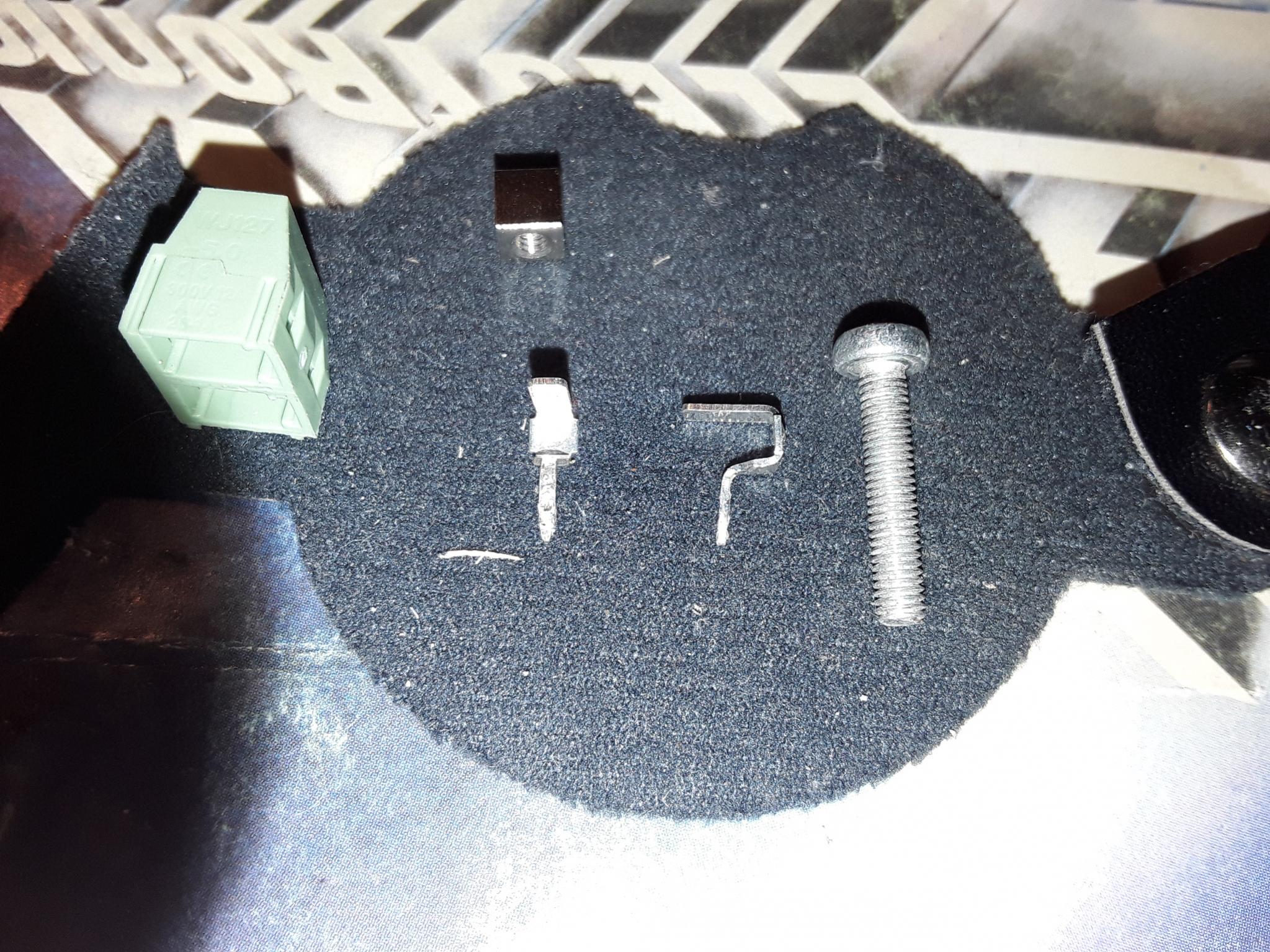

Hello,
Because my parts finally were released by customs i made a start connecting some circuit boards together on my fifopi tower.
Like i wrote before i wanted to make some connections as direct ( without interrupting) as possible so just a soldering contact on both sides.
The connections from the ucconditioner boards to the lifepo4 board i made with the standard Kimber wire that exist for a few decades now.
Removing the green terminals and soldering the Kimber is a bit time consuming.
Making ALL connections( like the 3,3 output terminals going to the circuits ) also with Kimber can be done but i decided to go for some solid core silver wire i have in stock because whenever i need to disassemble the tower that wire is easier to desolder and solder again. Kimber needs some heat to get a good connections and Kimber all around will make things a bit to rigid.
As you can see there is no need to worry about the thickness of the copper bars connecting the cap terminals the parts inside the green terminals are lilliputian. M3 bolt added for comparison.
Greetings,Eduard

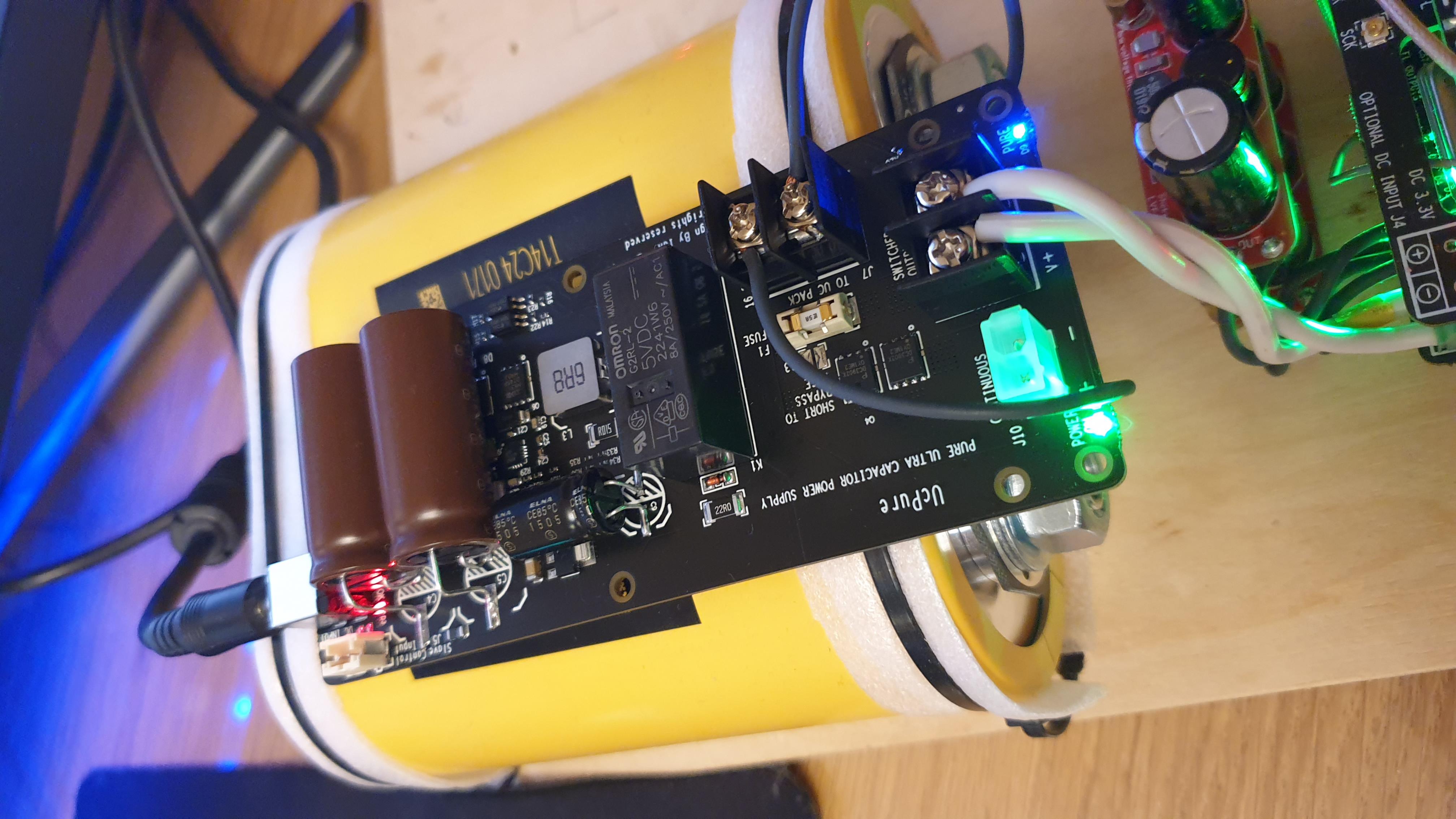

@Brzzl,
For more than a month, I'm still using the pair of Eaton XL60 3000F without a balancer/protection board. I'll measure the voltages of both and let you know.
Ian
That sounds promising and thank you in advance for measuring them again.
