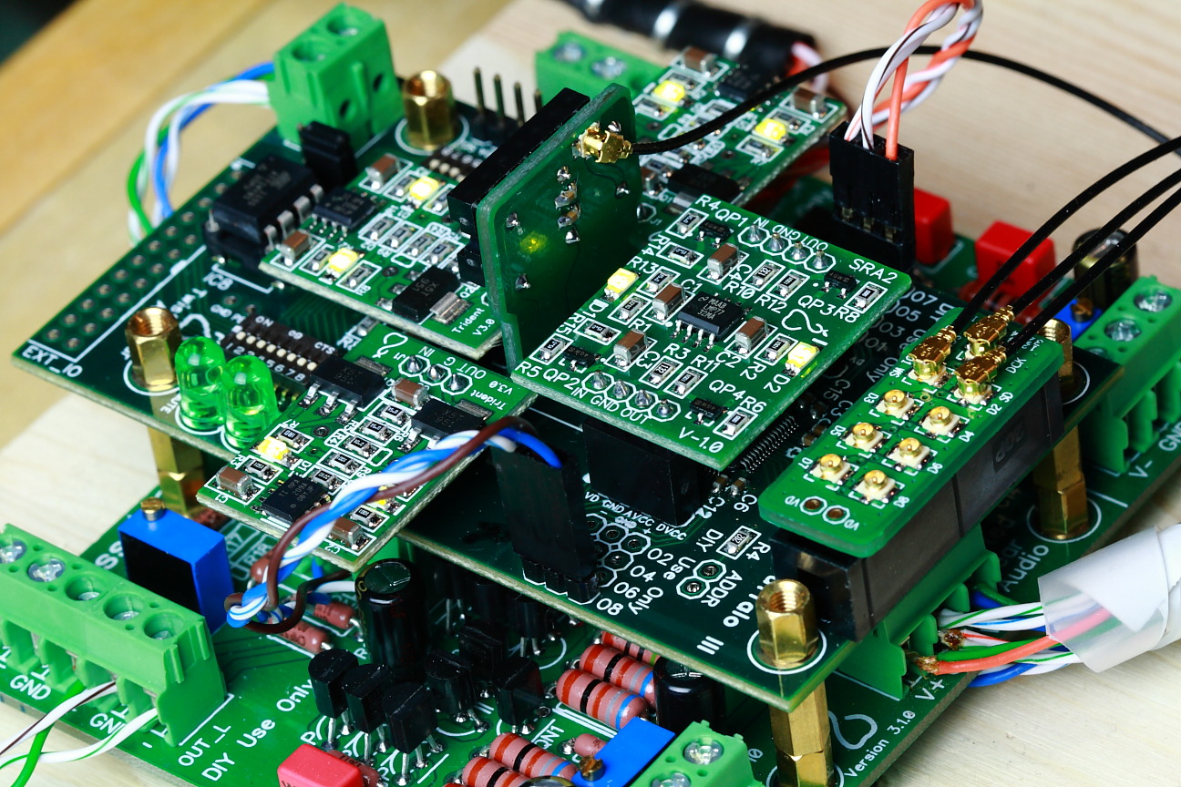

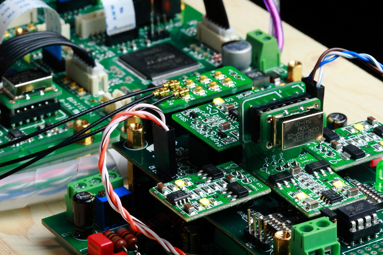

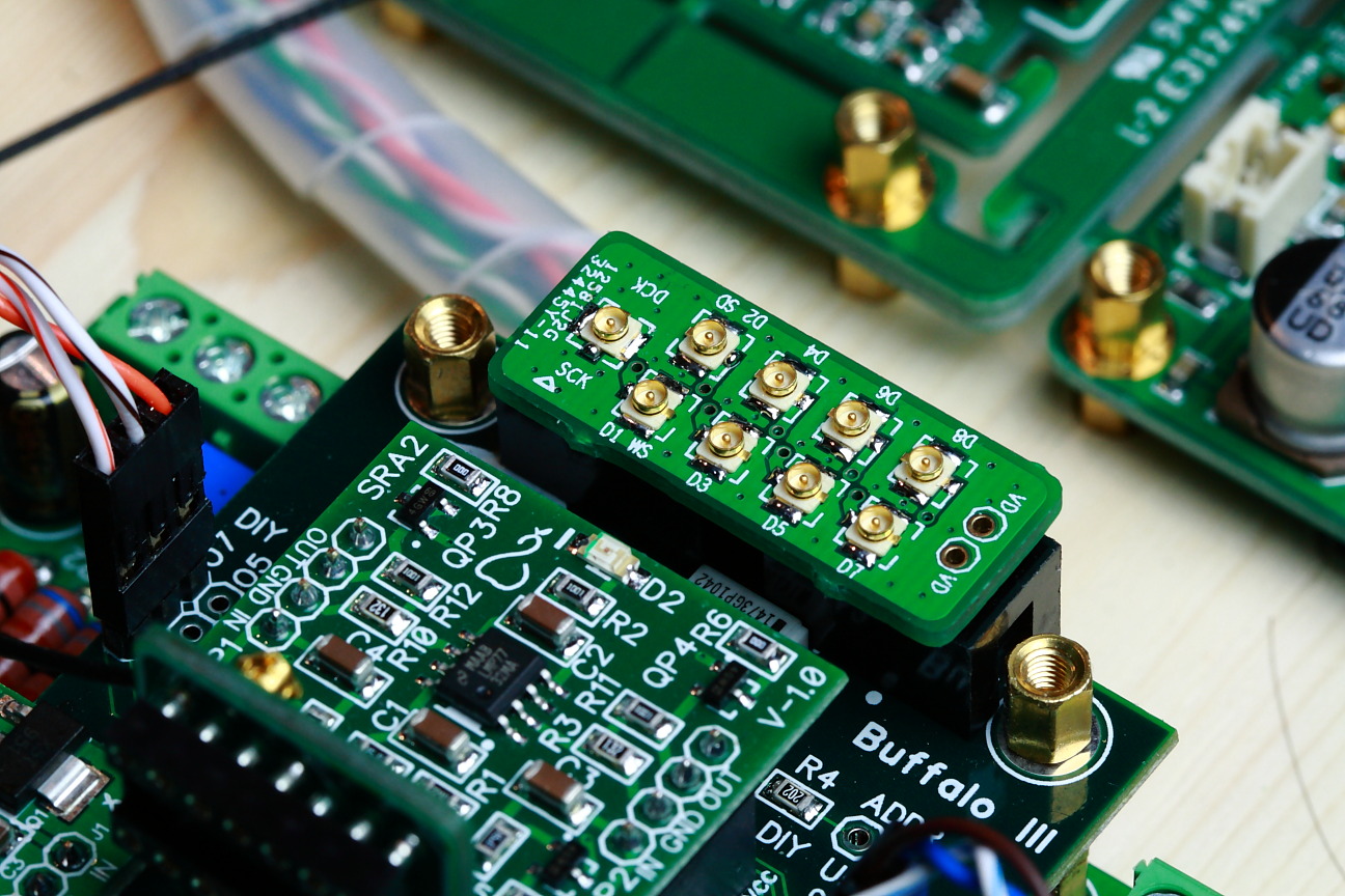

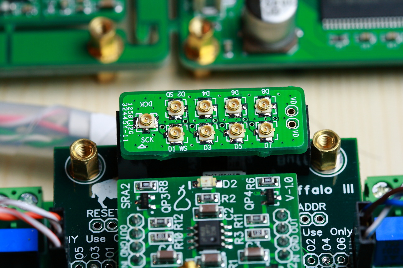

BIII U.FL input adapter testing

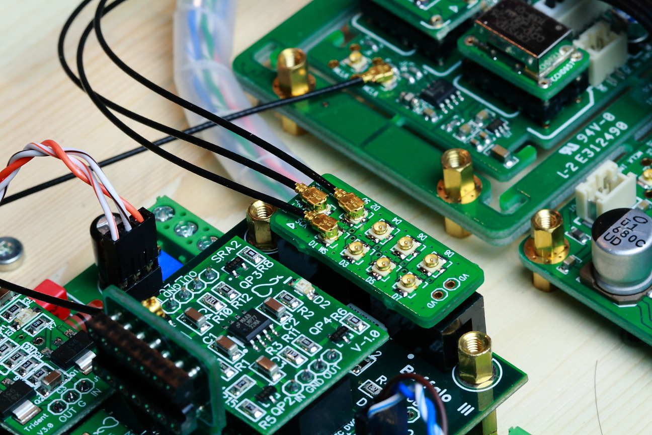

Because of the internal ASRC architecture, Sabre ESS DACs are quite sensitive to the jitter from the input signals. Both async mode and sync mode are. I like this adapter. It’s kind of perfect solution to introduce higher quality U.FL connectors into BIII DAC. But still not as good as DAC which comes with U.FL sockets originally placed on the PCB.
I did some test with this new adapter on my BIII yesterday. It works very well. I’ve noticed some improvement: With BIII (DPLL bandwidth set to lowest) working with I2S FIFO at SYNC mode, If feeding signals with this adapter and U.FL cables, DPLL locks solid never lost; However, without this adapter and U.FL cables, it will lost lock occasionally(every 10 minutes roughly).

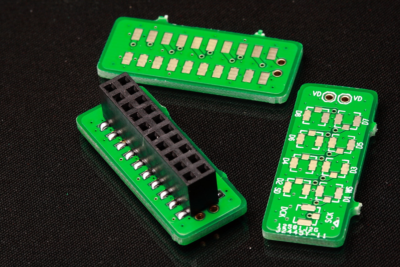

The BIII input adapter has 9 U.FL footprints, can support all modes: Multi-S/PDIF, Stereo I2S, Multi-channel I2S, or multi-channel DSD.

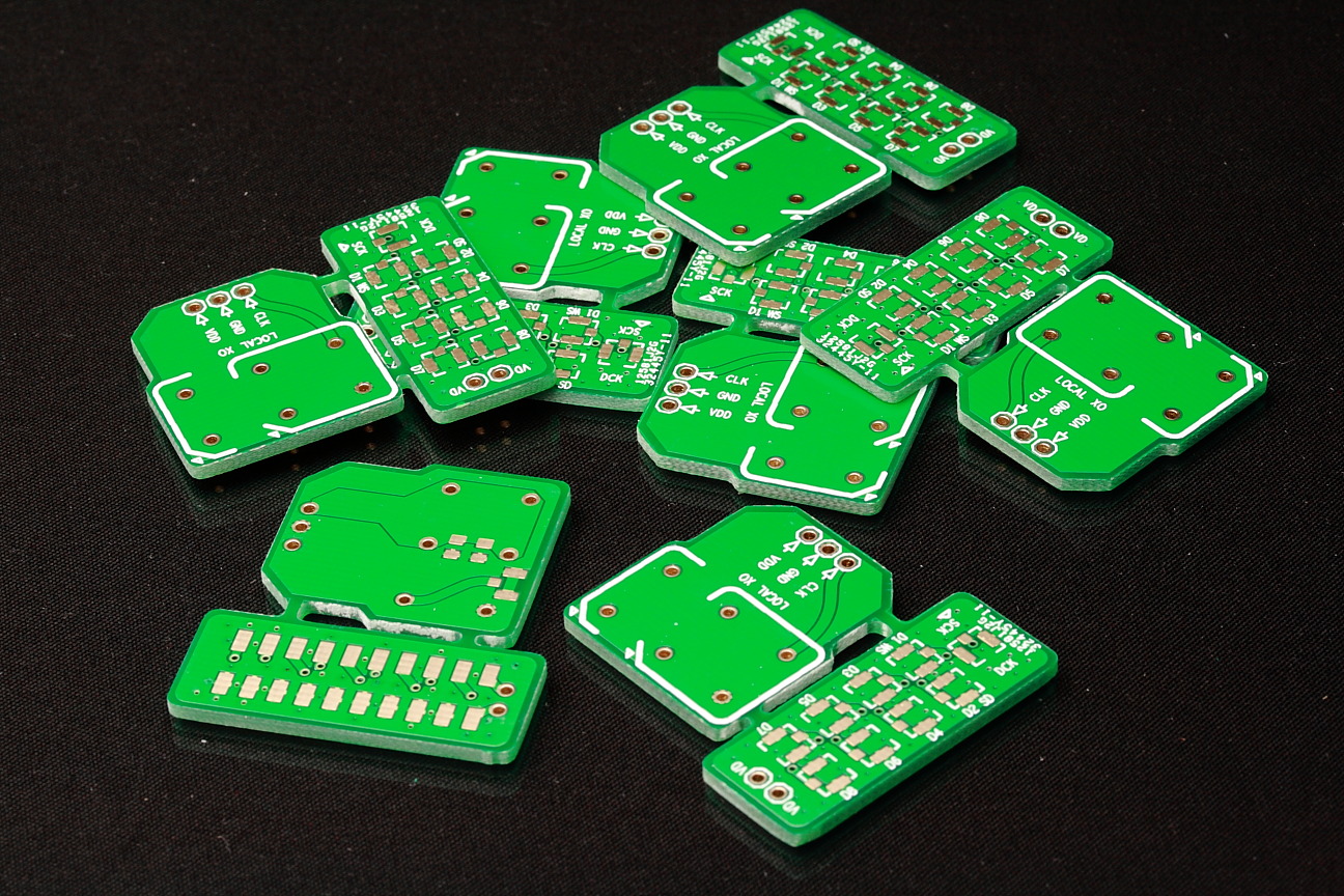

I attached some pictures below just show how the adapter works. Actually the BIII input adapter and the clock adapter were integrated into one PCB. So usually, they come as a set. I’ll supply each FIFO user from GB II one set PCB for free. But to assemble them perfectly is a challenge.

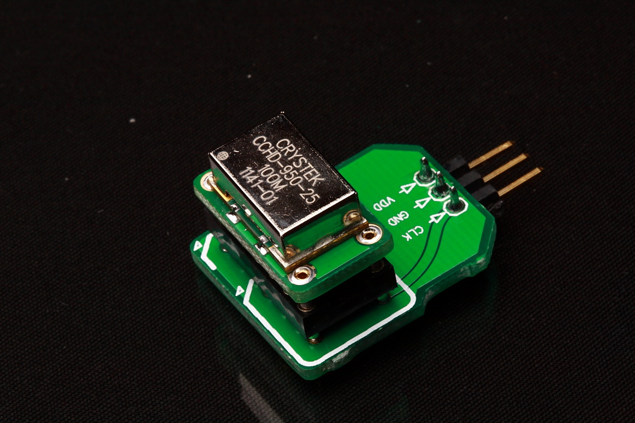

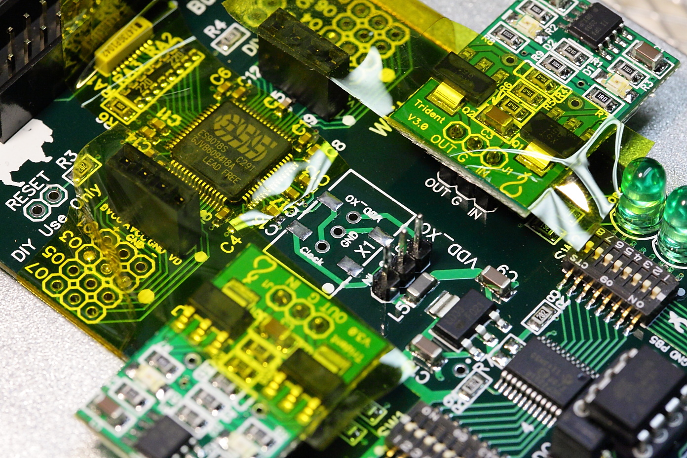

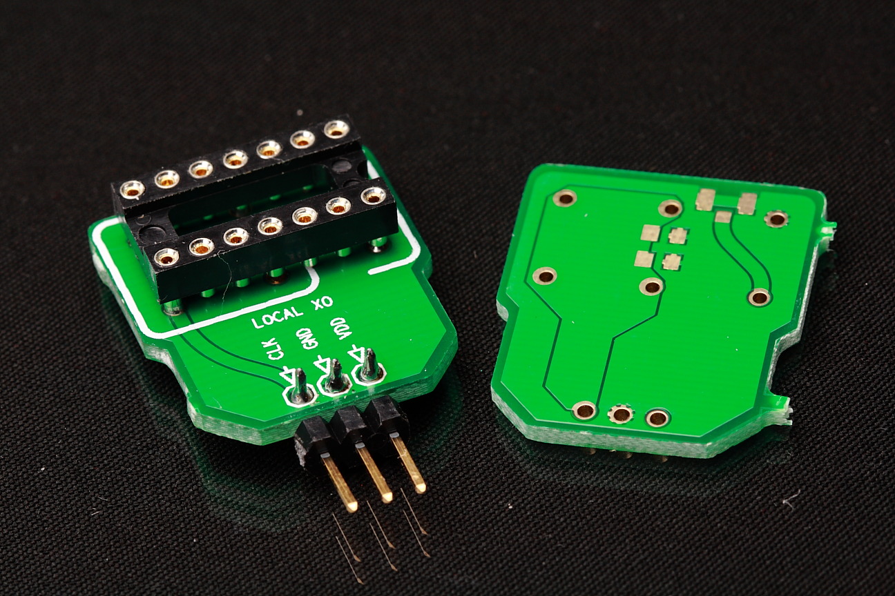

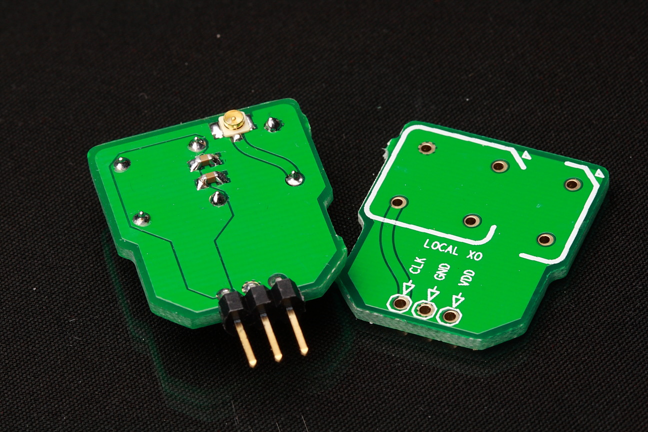

Test of BIII clock adapter with ASYNC and SYNC mode
BIII didn’t design with SYNC mode originally. But with this small adapter, it can now. Thanks for the backdoor under the original XO footprint.
Assemble the adapter first. Then remove the CCHD950 from BIII PCB. Solder the three pins of the clock adapter into CLOCK, GND and VDD_XO on the BIII PCB. That’s all. The assembly looks pretty nice.
With U.FL cable connected to the external clock from FIFO clock board and onboard XO removed from the socket, ESS9018 works at SYNC mode; while with on board 100MHz CCHD950 plugged into the socket and external U.FL clock cable disconnected, it works at ASYNC mode. So, having this small BIII clock adapter, it will be very easy to switch between ASYNC and SYNC mode. So, different modes with different clocks will be experienced and a lot of researching and comparing are waiting.
Please see the pictures below for the configuration and details. Please note the name of pictures for the meanings.
