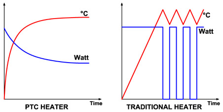

Not sure of your heating elements you are using, but I would be very careful in selecting them. An analog temperature controller is required, "bang-bang" controllers could have a very ugly impact on the oscillator spurious.
Please find the attached curves for the PTC heater's performance.
PTC heater would be totally the different technology if you mean the "bang-bang" is the transitional heater.

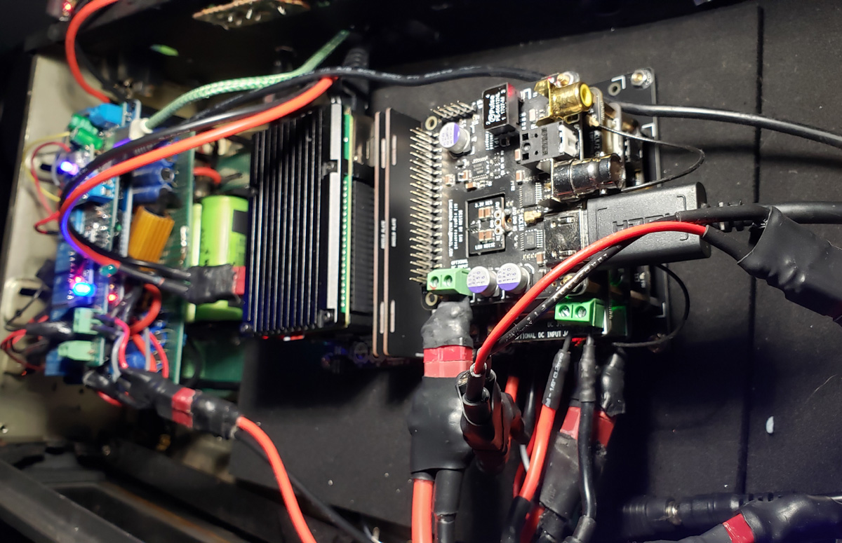

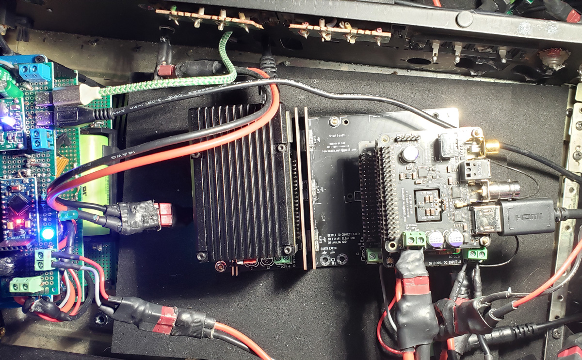

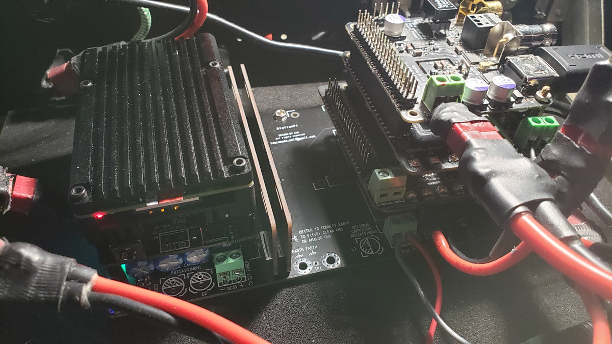

iancanada;6757747]@JCMcNeil
Please no worry. Can you please post a picture of your system showing the configurations and connections?
Thanks,
Ian

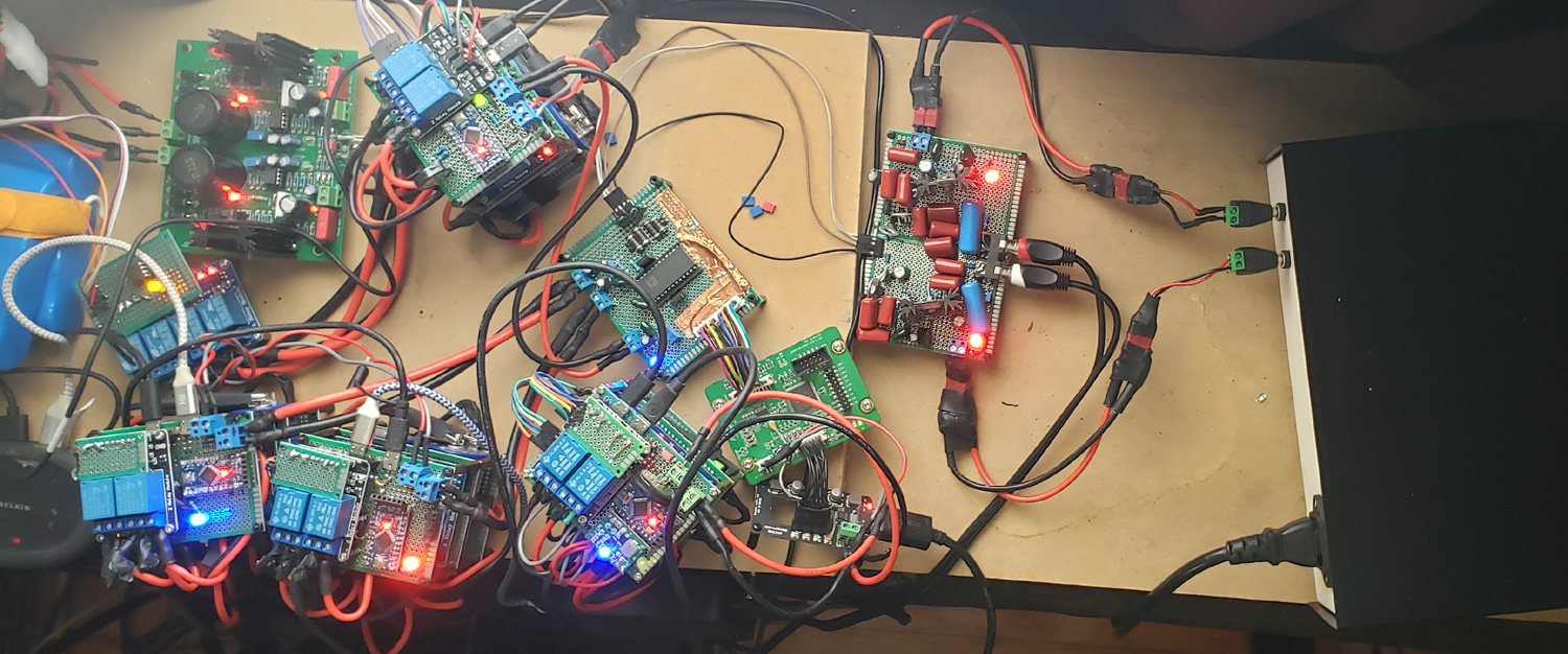

Here you go, Ian.
Forgive the system sprawl! Once all is working to my satisfaction, I'll figure out how to consolidate this into a few enclosures. Right now the StationPi and 1 of the power supply modules lives in an old NAD receiver chassis and the jungle of an AD1865 and its power supplies are hanging out on a board.
The first 3 images are of the Pi4/StationPi/FifoPi/etc streamer with a few LifePo4 + (in some cases) Ultracaps modules I built with Arduino controllers and relays so the clocks get 24/7/365 clean power and recharging the batteries plus handling current issues with the Ultracaps are handled automatically.
The 2nd 2 are of the DAC, it's output board, and the myriad power supplies that run it .... not as space-efficient as Ian's solutions, obviously, just something I did to learn my way around managing such systems.
I feel the master clock connections are the best I could do with this but I'm open to suggestions to making changes- the master clock ufl connections are:
FifoPi to ReClockPI
FifoPi to ReceiverPi (IIRC)
ReClockPi to TransportPi

@JCMcNeil
Thanks for the pictures.
Your 44.1KHz family is OK now. Only 48KHz family has no sound. Am I right?
Dose the FifoPi lock led light when you play 48KHz/96KHz? How about the XO1 and XO2 LED on FifoPi?
