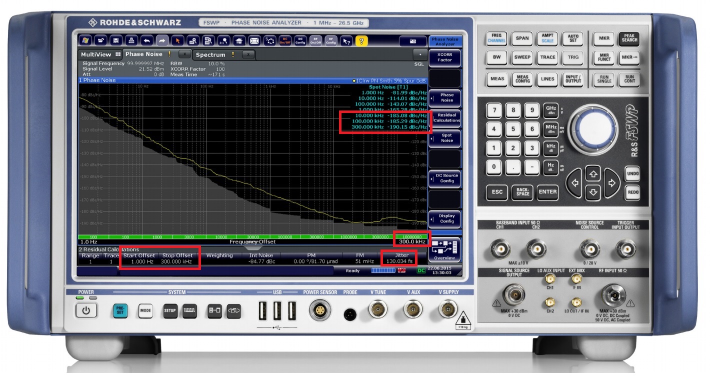

I don't believe, when the noise floor is reached the phase noise keeps constant.
Please take a look at the FSWP attached picture.
It's the phase noise plot of a 100MHz oscillator, above 10 kHz from the carrier the phase noise is almost flat.
Please, note that the measurement have been executed with an offset band 10Hz to 300kHz

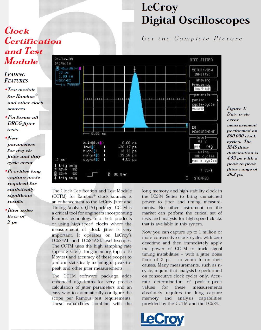

Since someone did ask me to compare my measurements against the measurements from a digital oscilloscope and I have a noise spectrum instead of a standalone number, I had to
choose an integration bandwidth to calculate the jitter from the phase noise.
The digital oscilloscope does not provide the noise spectrum and I assumed its time base is very poor, so I have chosen 1Hz instead of 0.1Hz or even 0.01 Hz from the carrier.
The calculated jitter of the Crystek CCHD-957 I have published has clearly demonstrated that the the digital oscilloscope cannot measure at such close in frequencies, since its measurement was more than 2 order of magnitude optimistic than the actual jitter of the oscillator.
I suspect that the digital oscilloscope cannot measure the noise below 100 Hz from the carrier.
You have a point here, I agree a digital scope cannot estimate these levels of phase noise down to 1Hz, but then see above; the core question still remains what's good enough for audio purposes? One think I am pretty sure about: the close in phase noise is not audible, at least because the source material processing wow and flutter (even if it's not sourcing from mag tapes) is many orders of magnitude higher. If the entire processing chain would use your clocks, then we may talk about a Crystek oscillator in the DAC as being "poor" (and even then, the effect would be beyond any human hearing threshold).
Yes, maybe it is remains constant (but then again, maybe not), but the jitter (the phase noise integral) is not, in particular for non sine signals. Which raises a good question, what matters for audio, the phase noise (frequency domain), or the jitter (in the time domain)? You seem to conveniently switch from one view to another, depending on the context. It would be nice to once and for good specify the scope of your project(s).

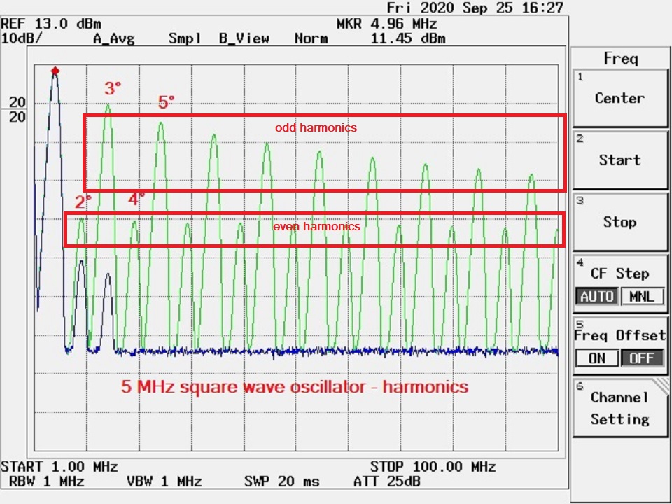

Once and for all, there is no issue in measuring the phase noise of a square wave clock.
Phase noise means zero crossing, so if harmonics did shift the zero crossing (phase) it would be easily detected by the measurement, increasing the phase noise.
I have already demonstrated this at least two times, I would avoid to do this for the third time.

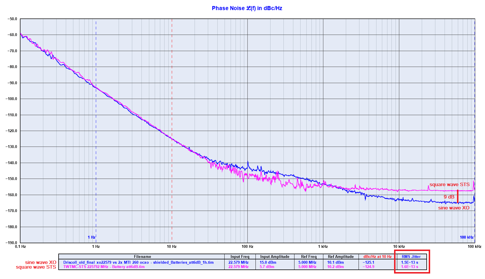

Sorry but you have not clarified anything because you are wrong.
Firstly jitter is not significantly increased by sine to square conversion as clearly showed in the attached plot.
Jitter is practically the same (150fs for the sine wave oscillator vs 160fs for the squarer) and noise floor is almost the same, only 9 dB worse for the squarer and we are talking about -157dBc.
Secondly the the limited input bandwidth of the Timepod (30MHz, the same of the R&S FSWP before the signal was digitized and cross correlation was applied) does not affect the measurement as I have already demonstrated at least two times, but I take note that I will have to do it for the third time.
You still keep forgetting that phase noise means zero crossing so there is no way for the harmonics to alter the measurements unless they affect the zero crossing (phase).

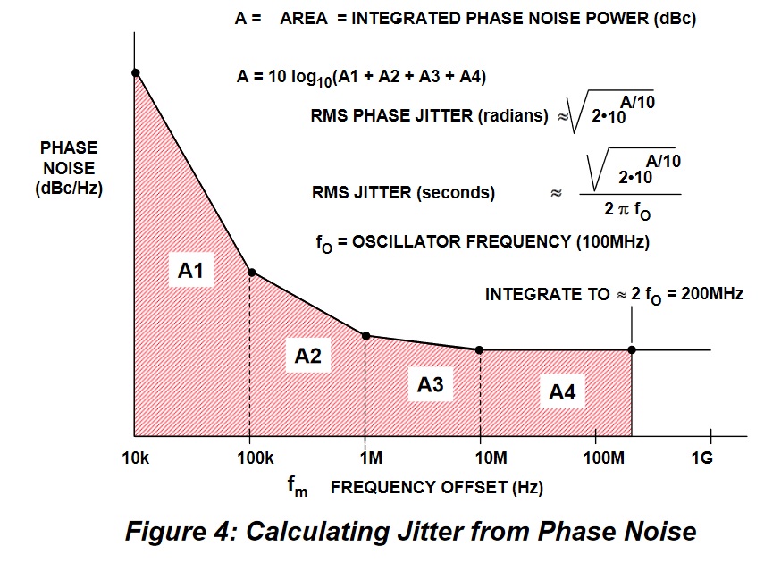

At the risk of repeating the obvious:
a) jitter depends fundamentally on the phase noise frequency integration limits. These integration limits were under discussion here, Andrea says that integrating the phase noise from 0.1Hz or 1Hz to 100KHz is universally good enough (for digital audio?), AD in the quoted reference recommends integrating up to the twice the sampling frequency, I was questioning why not integrating from 0.001Hz, if the close in phase noise is all that matters for digital audio.
b) the AD recommendation for the upper frequency integration limit is in particular important for calculating the jitter of non sine signals. Andreas plot already shows a degradation of 9dB in the wideband phase noise floor. While integrating up to 100KHz has indeed a minimum effect on the jitter degradation, integrating according to the AD recommendation would show a much larger jitter degradation.
c) Lo and behold, what do you think is the timepod seeing as coming from a 22MHz input square signal, filtered by the timepod anti-aliasing input filter to some 30MHz? Answer: the fundamental frequency, the same as for the sine before square conversion. While it is well known that the whole sine to square process additive jitter degradation is in the harmonics:

a) this is just the reason why the jitter is useless since the phase noise frequency integration limits are arbitrary, while the phase noise plot shows the whole spectrum of the noise
b) integrating according to the AD recommendation would not change the result since the noise floor point had been reached for both signals (sine and square) and above this point the plot is flat. Moreover you can easily play with a phase noise to jitter converter tool to understand that the higher the distance of the noise from the carrier the lower the calculated jitter is affected.
c) I disagree, just move to a 5MHz fundamental (far above the LPF of the Timepod) and the result does not change, as I have already demonstrated two times. Please take a look at the attached harmonics spectrum of a 5MHz CMOS oscillator. Since the infinite odd harmonics are just the square wave, do you think the even harmonics of the spectrum will affect the jitter? The answer is no as I have demonstrated.

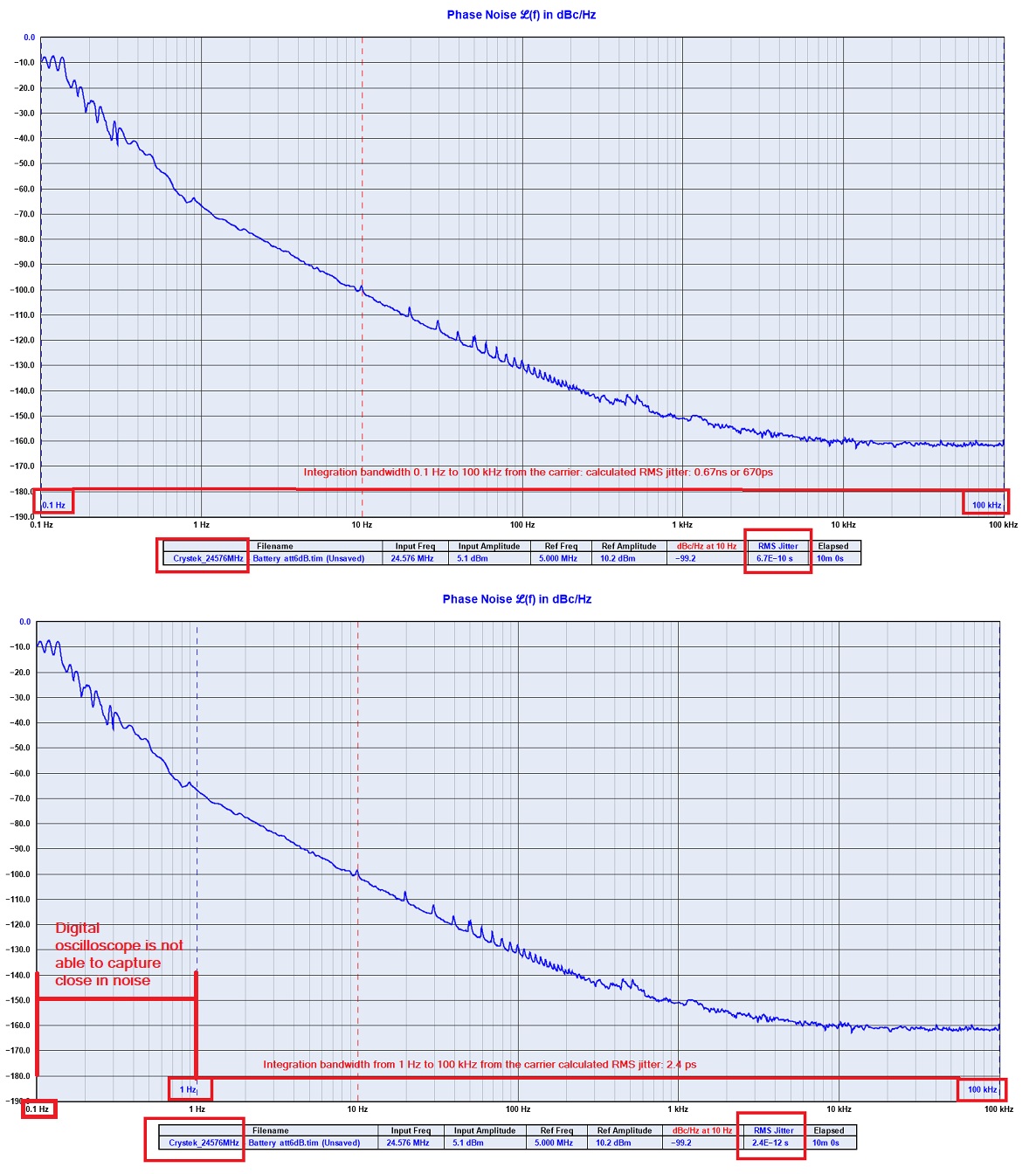

So, since the jitter is mainly affected by the close in noise, do you think your digital oscilloscope with its poor time base and without cross correlation was able to measure phase noise/jitter at 1 Hz or even 0.1 Hz from the carrier?
The answer is NO, let me explain why.
First picture
The RMS jitter of the DRIXO oscillator at 22.5792 MHz calculated with an integration bandwidth 1Hz to 100kHz is 76fs, no doubt from the upper image.
The RMS jitter of the DRIXO oscillator at 22.5792 MHz calculated with an integration bandwidth 0.1Hz to 100kHz is 980fs (lower image).
It was pretty obvious since the jitter is mainly affected by the close in noise.
Although the jitter noise floor of your digital oscilloscope (2 to 7 ps) is far worse than the DUT you would measure (980fs), there is no way your tool could measure with such integration bandwidth lower limit (0.1 Hz) because its time base is much worse than the DUT and moreover the cross correlation is the only way to reach such lower limit (and your tool does not use cross correlation).
Let me demonstrate the reason.
Second picture
Using an integration bandwidth from 0.1Hz to 100kHz the RMS jitter of the Crystek CCHD-957 is 0.67 ns, while you have measured 2.71 ps with your digital oscilloscope.
This demonstrates that your tool is not able to measure the close in jitter, it substantially measures the noise floor but it's not capable of measuring the close in noise.
It's suitable for telecommunication mesurements but not to measure the close in jitter and it's quite obviuos due to its poor time base.
Third picture
By calculating the RMS jitter of the Crystek CCHD-957 starting from the phase noise plot of its datasheet, the resulting jitter is almost the same measured by the Timepod when using 0.1 Hz to 100 kHz integration bandwidth.
The lower image clearly shows a calculated jitter of 0.47 ns, a little better than the one measured by the Timepod (0.67 ns), maybe the specific DUT has a little worse noise floor.
Anyway the resulting RMS jitter is very similar, 0.67 ns vs 0.47 ns, while you have measured 2.71 ps, more than 2 orders of magnitude better than the real jitter.
I hope it's clear you have no way to measure such close in jitter with your digital oscilloscope, the time base of your tool is much worse than the DUT you would measure.
It's phisically impossible.
Andrea

Let me apply the same reasoning to the Crystek CCHD-957 so that it will be clear how you are manipulating the calculations.
The first plot in the attached picture shows the calculated jitter of the Crystek CCHD-957 with an integration bandwidth from 0.1Hz to 100kHz, just the same you have chosen to calculate the jitter of the DRIXO oscillator.
The resulting jitter is 0.67ns or 670ps, no doubt since I have already posted the calculation using the same online tool you have used to calculate the jitter of the DRIXO oscillator with the same integration bandwidth.
The second plot shows the calculated jitter of the same Crystek CCHD-957 with an integration bandwidth from 1Hz to 100kHz, the close in noise is lost in the calculation.
The resulting jitter is 2.4ps, magically almost the same you have measured with your digital oscilloscope (2.71ps).
What does it means?
It does mean that your digital oscilloscope is not capable to capture the close in noise.
It was quite obvious since your digital oscilloscope has a poor time base and does not use cross correlation, so it cannot capture the close in noise because it's below the noise floor of your tool.
In conclusion, you have no chance to measure the real added jitter by your SinePi, since the jitter of the sine wave oscillator is far below the noise floor of your digital oscilloscope.
This means that you will measure at least a jitter of 2 to 7 ps (the noise floor of your tool) at the output of your SinePi, although it was perfect by adding zero jitter to the incoming sine wave.
Almost 2 orders of magnitude worse than the base oscillator.
And tricks don't help.
Andrea

My LC584ALX is equipped with a JTA jitter testing package. The jitter noise floor is just 2ps. I attached the JTA specifications for you to reference. Please don’t mislead others with wrong specifications to degrade testing equipment other than yours. Can you explain where the 7ps wrong noise floor number came from?the noise floor of your digital oscilloscope (2 to 7ps)
Crystek CCHD-957 with an integration bandwidth from 0.1Hz to 100kHz, The resulting jitter is 0.67ns or 670ps
CCHD 957 RMS time jitter was tested directly in the time domain of 2.71ps. However the phase jitter calculated by your TimePod was 0.67ns (0.1Hz to 100KHz). By comparison with the time domain measurement, I think your TimePod phase jitter calculation result is inaccurate. If you don’t agree, please show me the evidence of the 0.67ns jitter that you measured a CCHD957 directly in the time domain. 0.67ns jitter is pretty big and can easily be seen even using a normal oscilloscope.

Agreed, it's pretty much textbook knowledge, but still doesn't answer to what I would think is a fundamental question: what does matter for digital audio? For a (for example) ADC, "phase noise" is an abstraction, what really matters is the jitter, which creates incertitude in the sampling timing, resulting in digital noise at the output, affecting the ADC SNR.
Jitter can be calculated from the phase noise spectra, but obviously not the other way around: there is no way to reconstruct the phase noise spectra from a single number that is the jitter. But, again from an ADC perspective, does it matter what the original phase noise spectra was? It doesn't, of course.
Secondly, it is true that the close in phase noise may have a significant contribution to the overall jitter (which, once again, it's what ultimately matters). But if we want to estimate an oscillator jitter from a phase noise plot, how can we do that? From the just posted Crystek example, if we integrate from 1Hz we get 2.4pS RMS of jitter, if we integrate from 0.1Hz we get 670pS, so what is the jitter? It appears to depend violently on an arbitrary constant that is the lower limit of integration. Why not integrating from 0.001Hz, since the phase noise will increase fast, then we are going to get an even larger jitter? What is the "true" value of jitter?
The answer is in the attached chart, from the Analog Devices application note; the relative jitter contribution of the close in phase noise decreases faster than the phase noise increase per the Leeson model. So there is a frequency point from which the close in phase noise contribution to the jitter becomes insignificant. Where is that point, that is a good question; so from a jitter perspective, the phase noise profile is much more relevant than ultra low phase noise values at 0.1Hz.
There is another thing here: the close in phase noise affects the spectral resolution of the system output, while the broadband noise (the "flat" part) affects the ADC SNR. One has to answer the question of what matters most for digital audio, something we have nothing but anecdote level evidence about, stories from usually self appointed Golden Ears uncontrolled, sighted listening tests. Based only on the current body of evidence, I would think SNR is the right metric (which does not mean we can hear a difference between 110dB and 120dB of SNR). Except, of course, for specialty applications like radars or space guidance systems, where the spectral resolution is of course critical.
