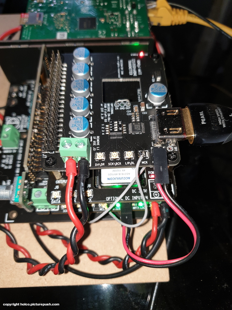

I finally have the reclockpi and the hdmipi mkII upgrade working, but I am not sure if it is connected correctly (read, best way) now?
S1 switch, jumper 4 off and on works when jumper 1,2 and 3 are set to the on position, all other options do not work.
Signal routing,
MCLK u.fl cable to J3 reclockpi from FifoPi MCLK output (bottom side), MCLK (top side) fifopi to MCK hdmipi mkII.
jumper 4= off
jumper 4= on
Signal routing,
jumper 4= off
jumper 4= on

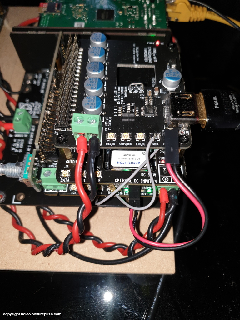

Signal routing,
https://picturepush.com/public/16389475
jumper 4= off
https://picturepush.com/public/16389474
jumper 4= on
https://picturepush.com/public/16389473
You should only connect mclk when the external dac uses the mclk. All other connections from to reclockpi to hdmipi mkII should be made i.e. da to da, sck\bck to sck\bck and lr\dl to lr\dl. And then set S1.1 to S1.3 in off position. If external dac uses mclk also connect mclk from reclockpi to hdmipi mkII and set S1.4 to off position. In my setup my external dac does not use mclk so I did not connect it to hdmipi mkII.
With regards.
With regards.
Thanks for your comment
I really don't know what my DAC prefers regarding the i2s signal
My DAC is a Audio-GD R8 (2021 version)
???响
With regards.
My advice would be to connect everything with u.fl cables from the reclockpi to the hdmipi. And set all S1.1 to S1.4 in the off position. If the dac does not use the mclk it won't matter. It will just ignore the signal.
Will try that, ordered some extra u.fl cables.

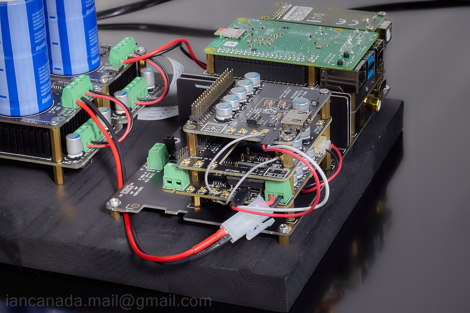

StationPi Pro
@ holco
I have a similar transport, but just upgraded to the new StationPi Pro.
StationPiProSystem1 by Ian, on Flickr
StationPiProSystem2 by Ian, on Flickr
StationPiProFinished by Ian, on Flickr

@ holco
Ian
@ holco
https://flic.kr/p/2m1p4RU
https://flic.kr/p/2m1ux86
https://flic.kr/p/2m1ux8B
Ian
