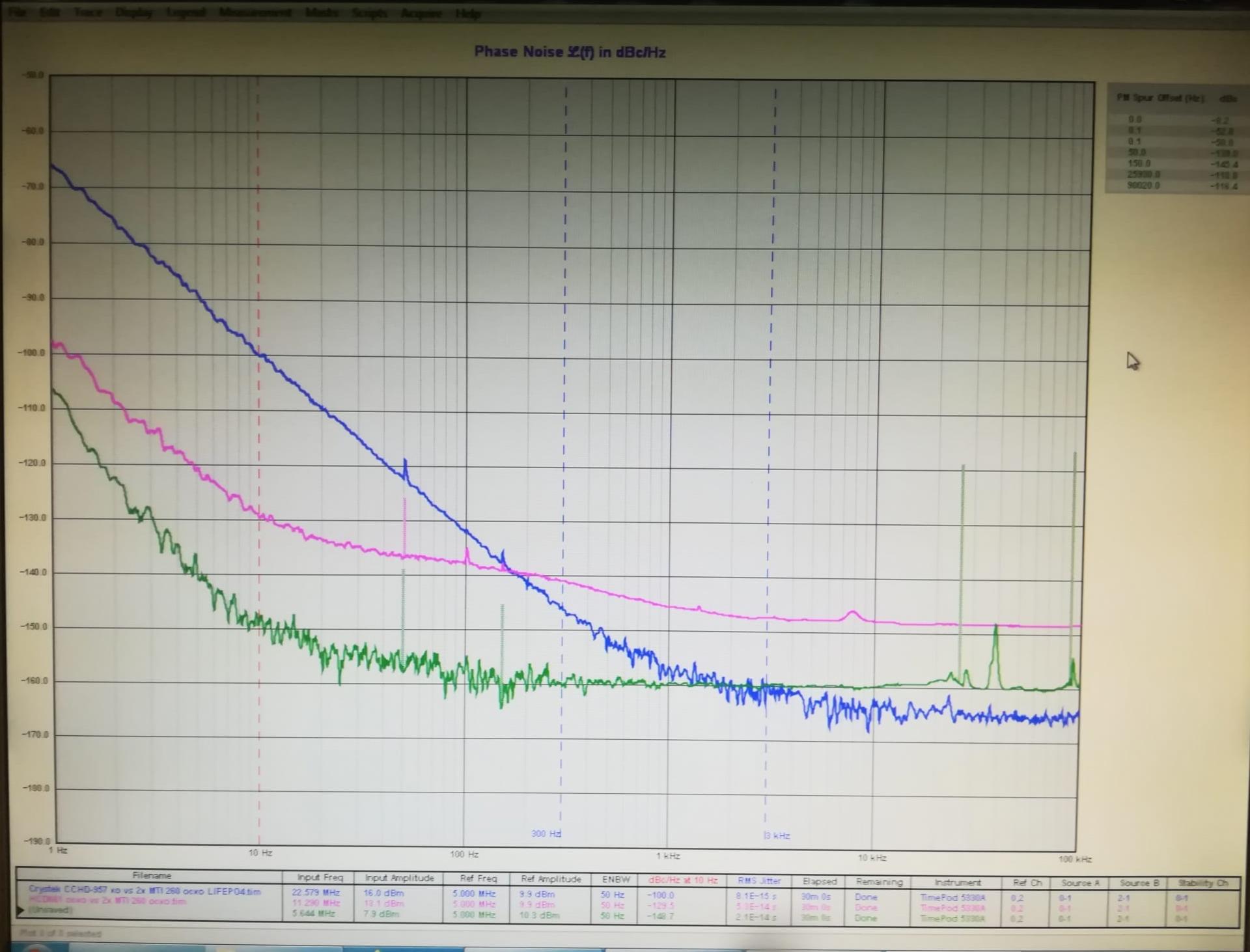

The Digital oscilloscope is not suitable for accurate jitter measurement, because the time base is not enough precise.
Do you think you can measure a really low phase noise clock? You cannot do it, the time base error of your oscilloscope overcomes the time error of the clock.
That's the reason to do a phase noise analisys.
In actual measurements, effects of phase, frequency and amplitude jitter need to be considered.
By investigating jitter in the frequency domain, we get a better understanding of its effects on the desired application over the entire time record of the signal.
The cross-correlation measurement of the phase noise solves the issue related to the quality of the reference, so you can measure a DUT much better than the reference.
You cannot do this with an oscilloscope because the time base is much worse than a decent oscillator.
You can already do a comparison, I attach the phase noise plot (blu line) of the Crystek CCHD-957 at 22.5792MHz measured with the Timepod.
Please, do the jitter measurement of the same oscillator with your oscilloscope and then compare the results.
As you can see the Timepod also measures the jitter, and thanks of its cross correlation technique the measurement is very accurate.
And now let me know if the jitter measurement is useful, starting from the jitter analysis the Crystek is the best performer.
Do you think so?
Just take a look at the phase noise performance of the 3 oscillators and draw your conclusion.
Do you think so?
