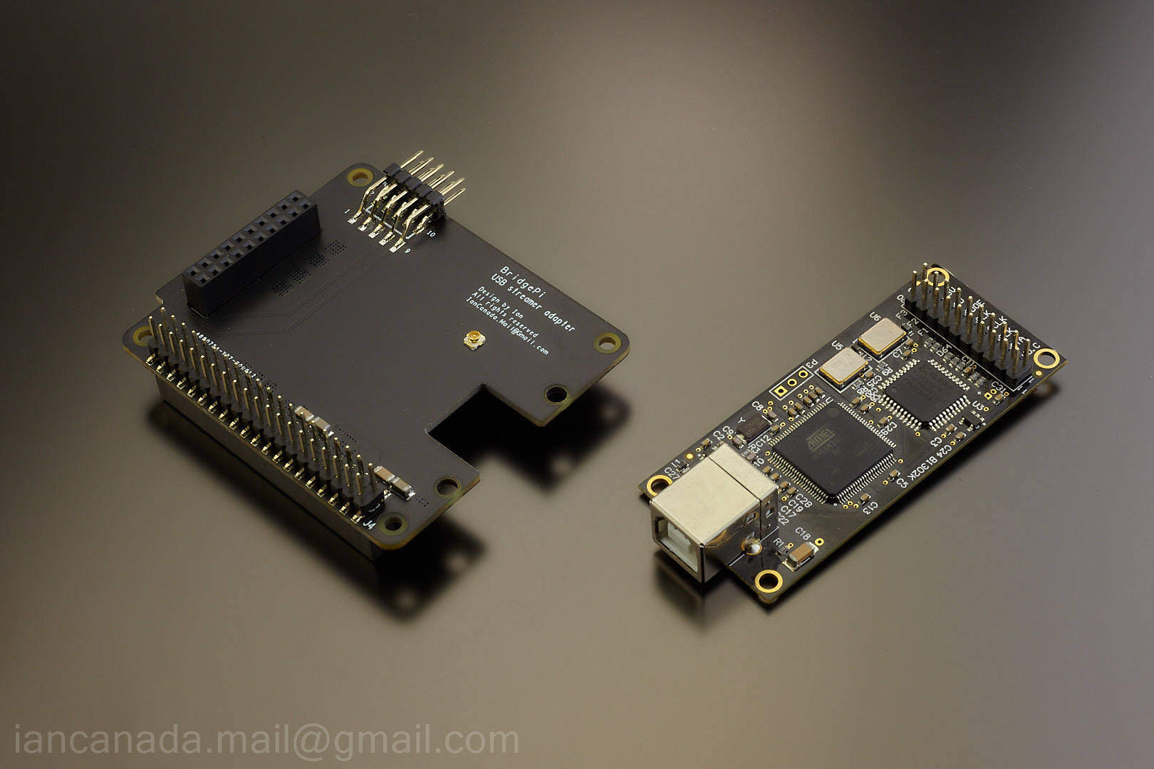

The futureproof (can we say this at all?) solution anyway will be the BridgePi.
BridgePi for a RPi free digital transport over RPi stack
With BridgePi, to setup an high perfromence independent PCM/DSD transport has never been as direct as this. RaspberryPi free becomes possible.
BridgePi + Amanero or other compatible USB streamer + TransportPi/HDMIpi.
DSD up to DSD512 and PCM up to 384KHz works great.
Again, I'm highly recommend use a ConditionerPi as power supply for better quality right away.
BridgePiTransport1 by Ian, on Flickr
BridgePiTransport by Ian, on Flickr
Ian

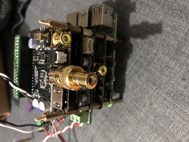

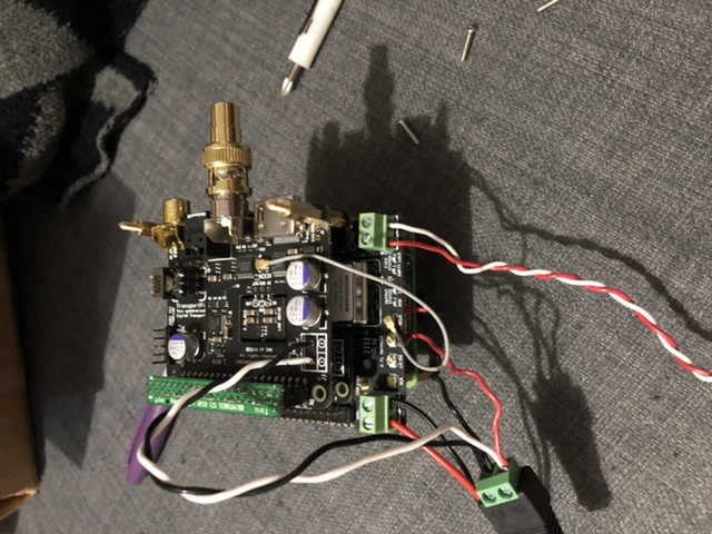

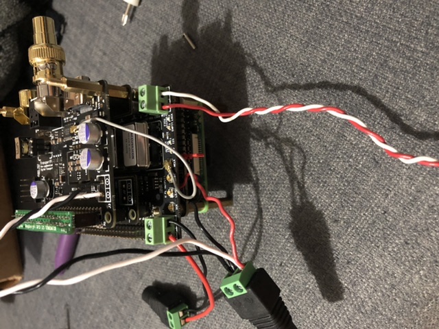

Hi Ian,
I have an issue with receiverpi playing independently without the rpi. I initially removed L1 and shorted L7 since i was using 3.3v ps. Now if I don’t power rpi, i have no sound even if i have music playing into the optical of receiverpi. How do i use the receiverpi without the rpi attached. I have fifopi on top of receiverpi then going to transportpi. All is good if rpi is powered on. But i want to remove rpi on the stack.
Hi ian
Attached are pics of the stack.. rpi4, receiverpi, fifopi, transportpi..
In my setup, i have to power up rpi and play music before i can use the receiverpi. But if i remove rpi, I cannot play music through receiverpi
Hi ian
Do you have power LED D4 on TransportPi lit with RPi removed?
And the power LED on ReceiverPi?
Do you have lock LED lit on FifoPi?

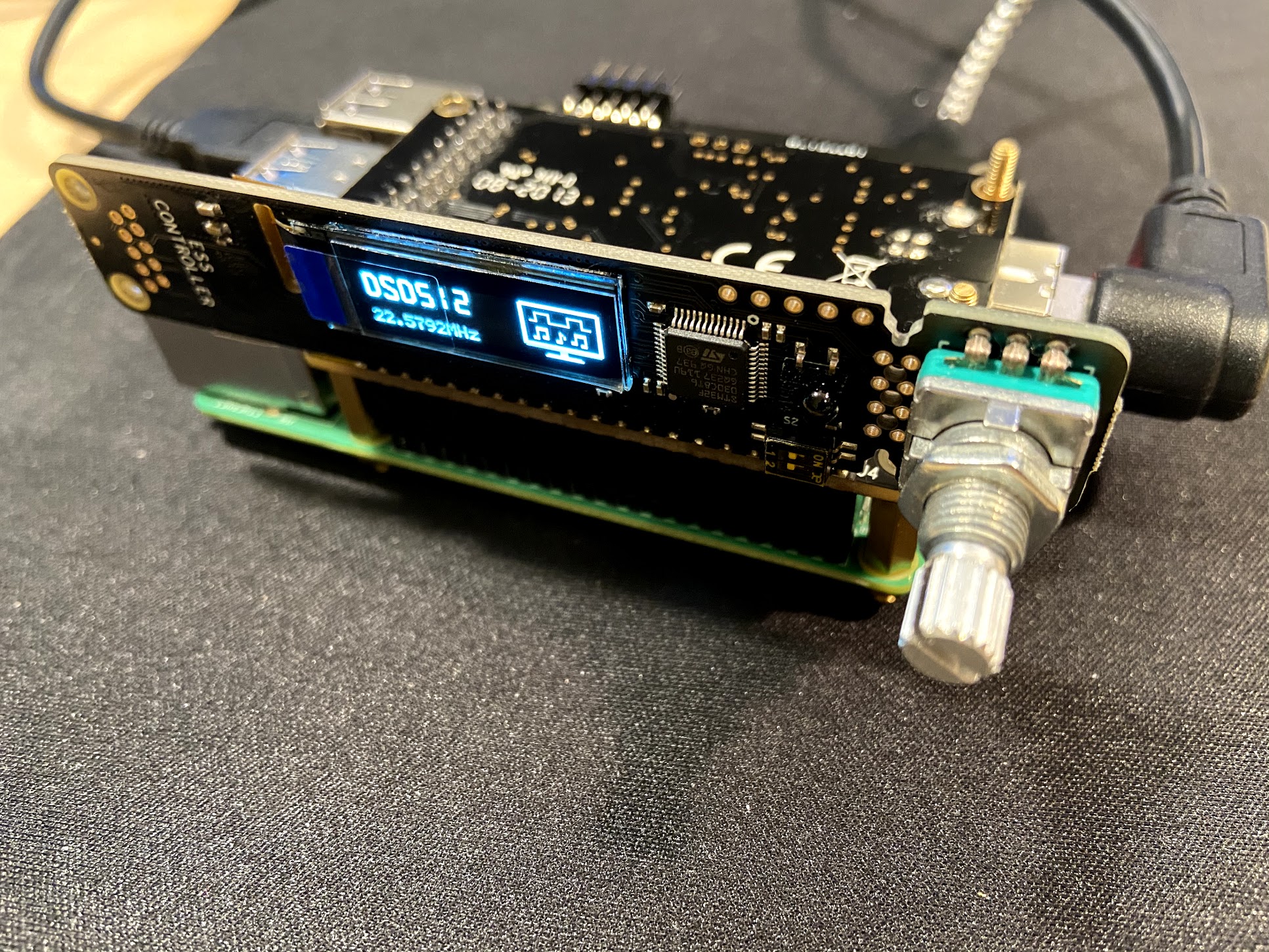

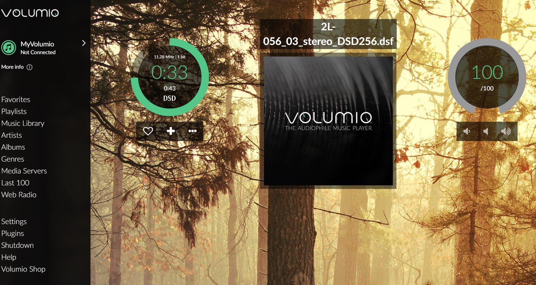

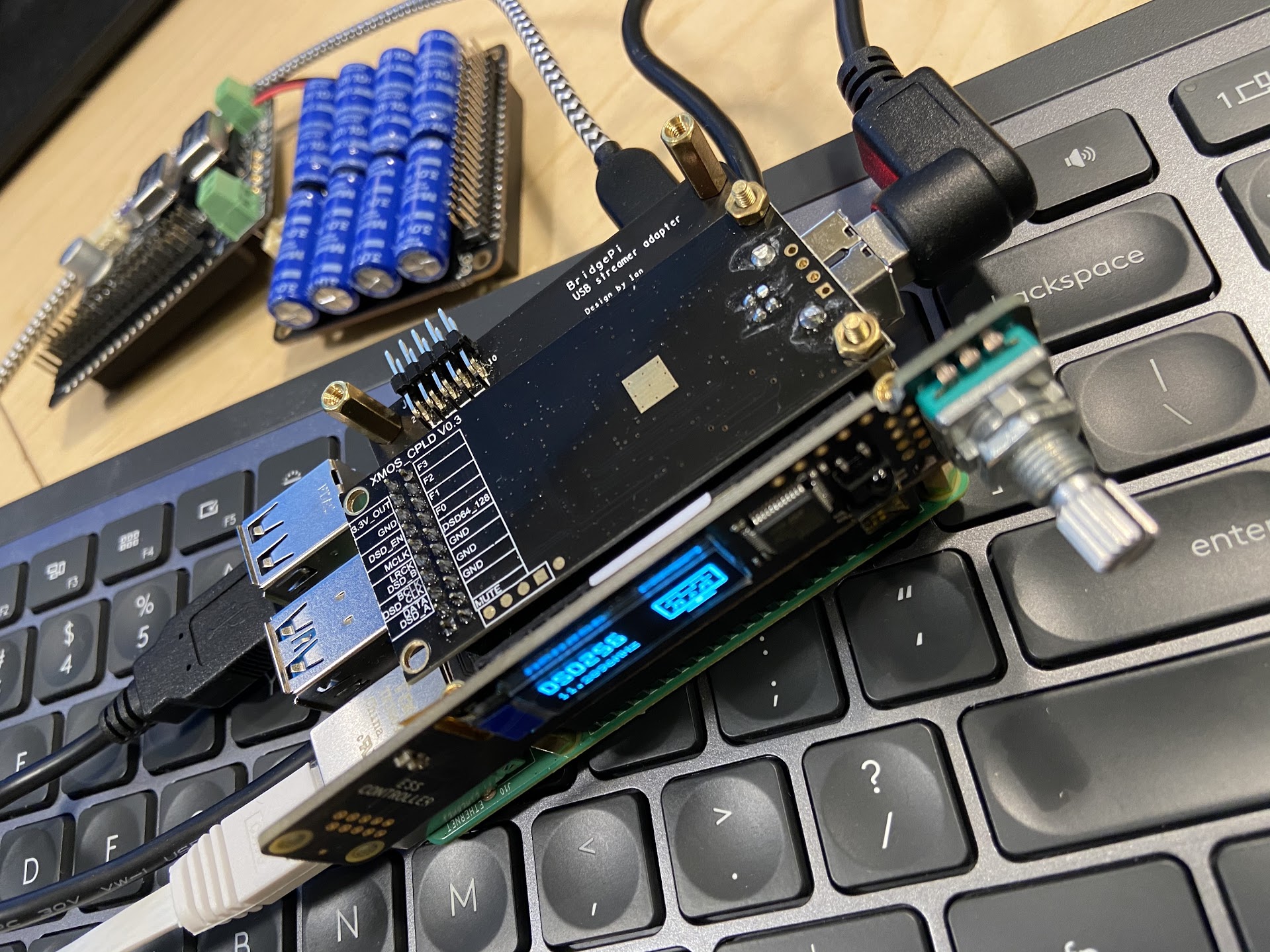

No longer a dream, Native DSD256 over RPi GPIO through BridgePi
It's the first time I got the native DSD256 signal out of GPIO. I use Volumio. BridgePi works great. RPi native DSD over GPIO is no longer a dream. Maybe I can forget the DoP.
USB streamers have a lot of advantages working with Rpi. All Amanero size USB adapters can be used. But my real test shows, under Volumio or Roon plug in, my Amanero can go only up to native DSD128 though they listed DSD512. My another XMOS USB can go up to DSD256. It could be Linux driver issue. I'm trying to find other USB that can go DSD512. Please let me know if you have any information.

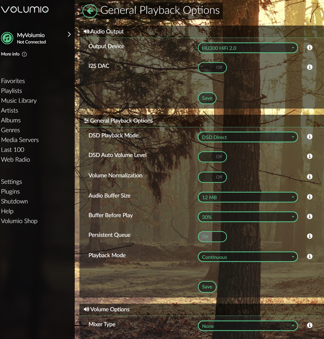

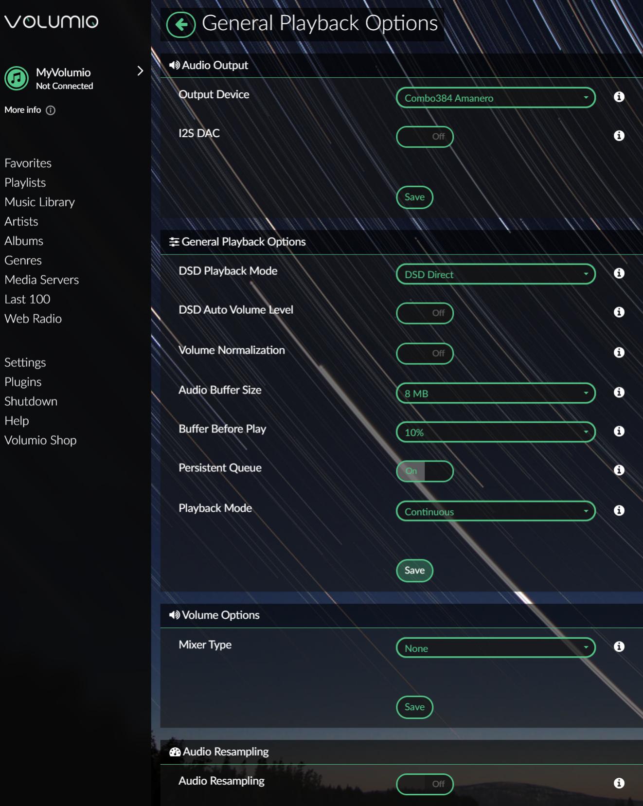

In Volumio settings, please disable I2S DAC with selecting the recognized USB as the output device. Then, select native DSD.
The simplest configuration could be just,
1. RaspberryPi
2. BridgePi with USB streamer
3. TransPortPi or HdmiPi
An Ess controller can also work as an music format analyzer/monitor.

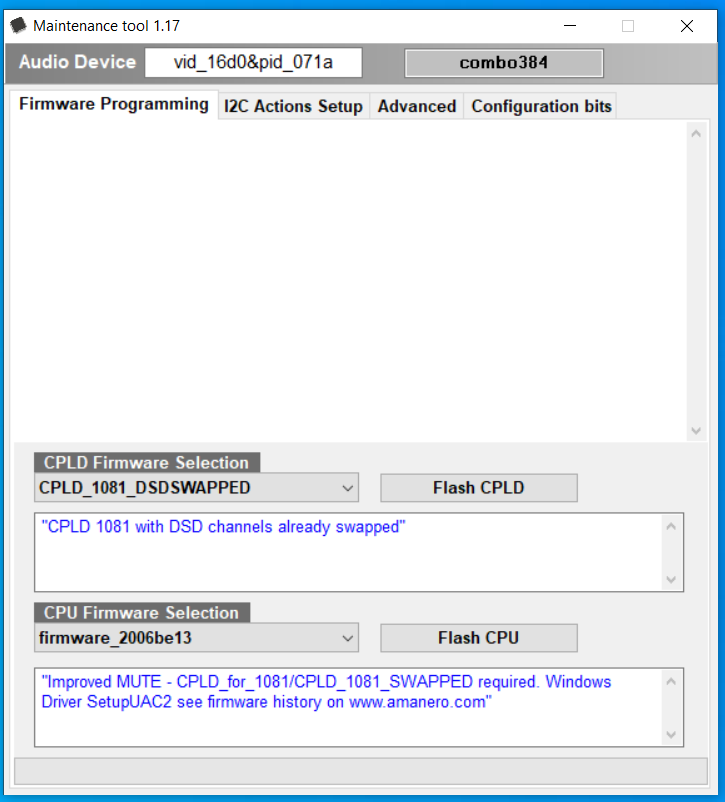

I finally make it! Got native DSD512 from GPIO on a RPi through BridgePi. I use Amanero Combo384 as the USB streamer. Here are the steps:
1. Flash Amanero Combo384 with FW that supports DSD512 & PCM 768KHz
CPLD: 1081_DSDSWAPPED
CPU: 2006be13
2. Install the Amanero Combo384 to a RaspberryPi 4 through the BridgePi. (ESS controller is just used for GPIO signal monitor, for best possible sound quality, FifoPi and ConditionerPi are highly recommended)
3. Volumio setting
Select USB Combo384 Amanero as output device with I2S DAC disabled.
Select DSD direct.
Enable Roon plugin

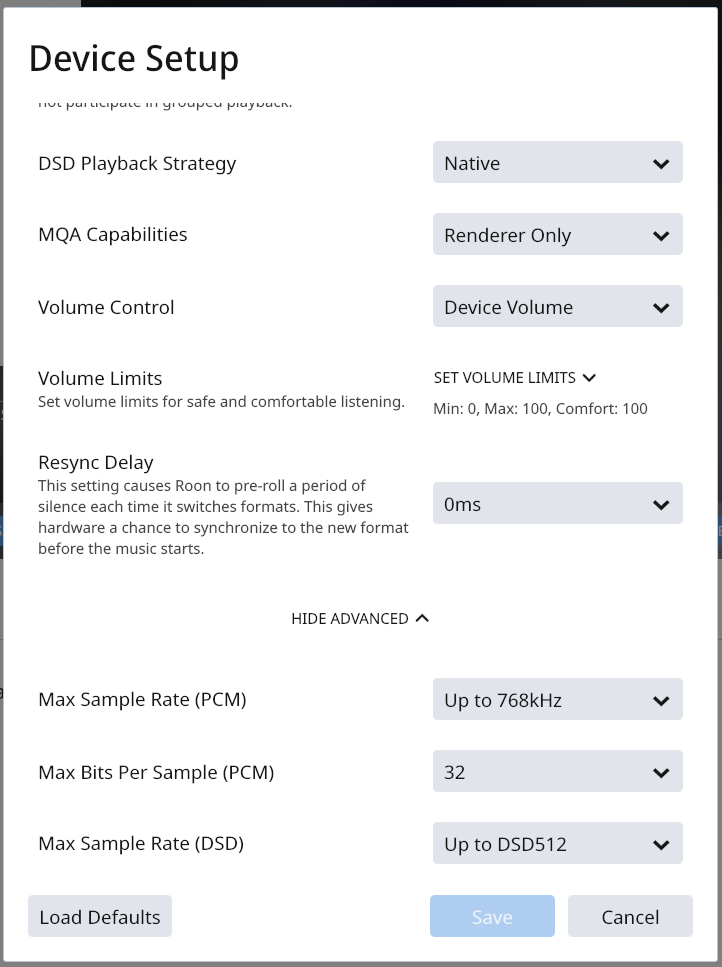

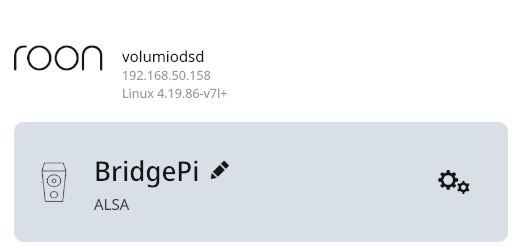

3. Roon setup (optional)
Settings-Audio Enable Volumio as roon device
Select this device as Zone
Select Native DSD and Up to DSD512 and Up to 768KHz
Now I can enjoy native DSD up to DSD512 either directly from Volumio or through Roon.

... and I thought using a BridgePi meant that you didn't need a raspberry pi?
For my understanding,
Native DSD -> RPi USB -> Amanero -> BridgePi -> 40pins GPIO i2s -> DAC HAT
So it's effectively an external usb dac? Just happens to be stacked and powered by the piFor my understanding,
Thanks ricyuyc, that's correct.
Ian
RaspberryPi GPIO has restrict to play native DSD. And DoP is also limited to DSD128 only. So BridgePi is the only solution to play native DSD and DSD512 (as well as all PCM) over RPi HATs. Software and everything else will keep the same no change. The only thing is that you need to select the USB DAC in the software settings.
Of course, it's true it can work without a RPi, So you can connect the BridgePi to a mini PC or what ever else without changing anything. That makes it even more flexible.
Good weekend.
Ian
Please do you get the DSD512 (i.e. 768kHz) from RPi via USB or GPIO I2S? Both are mentioned in your post. Thanks.
BridgePi connects the output of a USB streamer into GPIO (I2S and native DSD).
Ian
