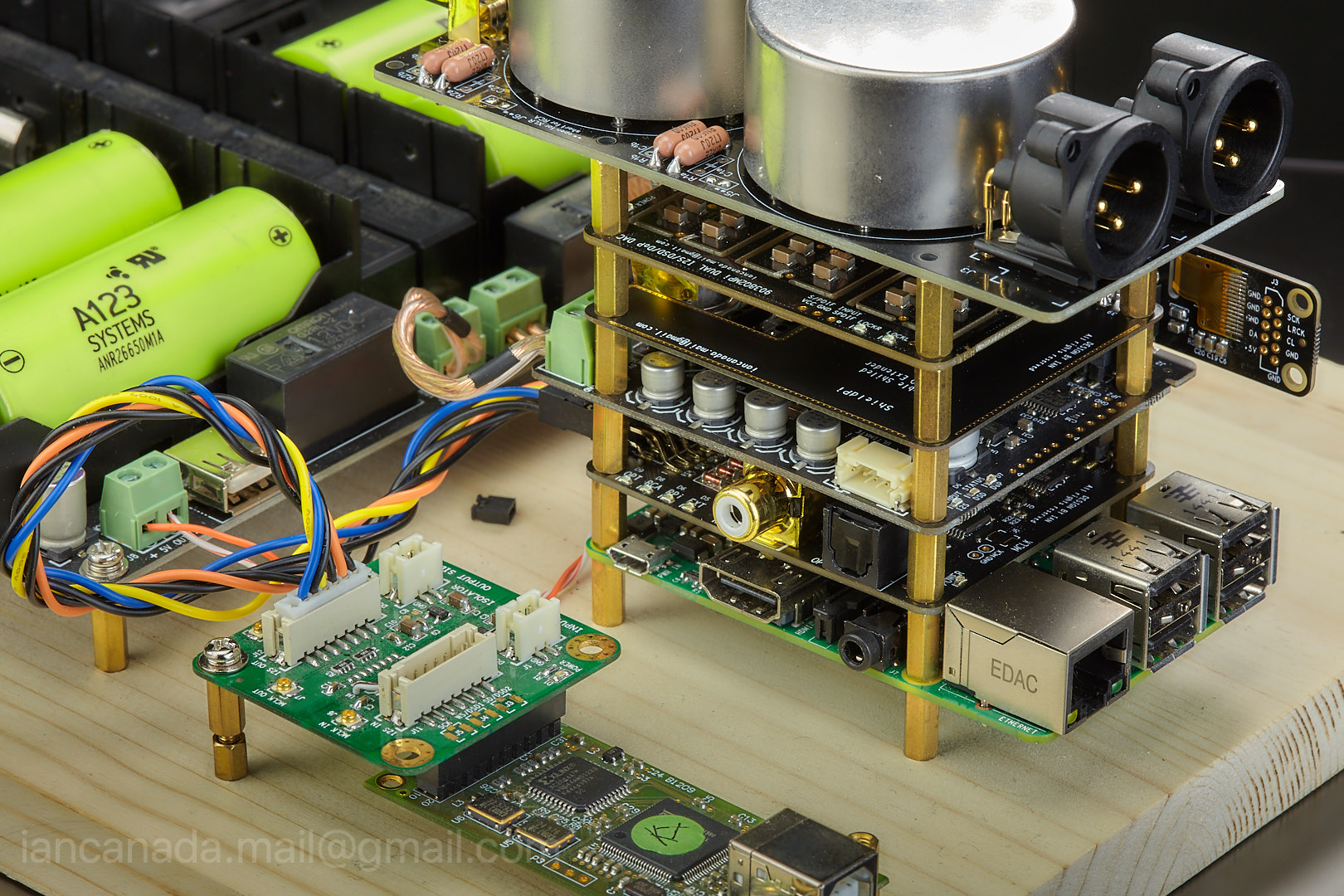

Which is the little board?
Ian
That should be the isolated buffer for USB/I2S, like the Hermes-Amanero from TPA, right?

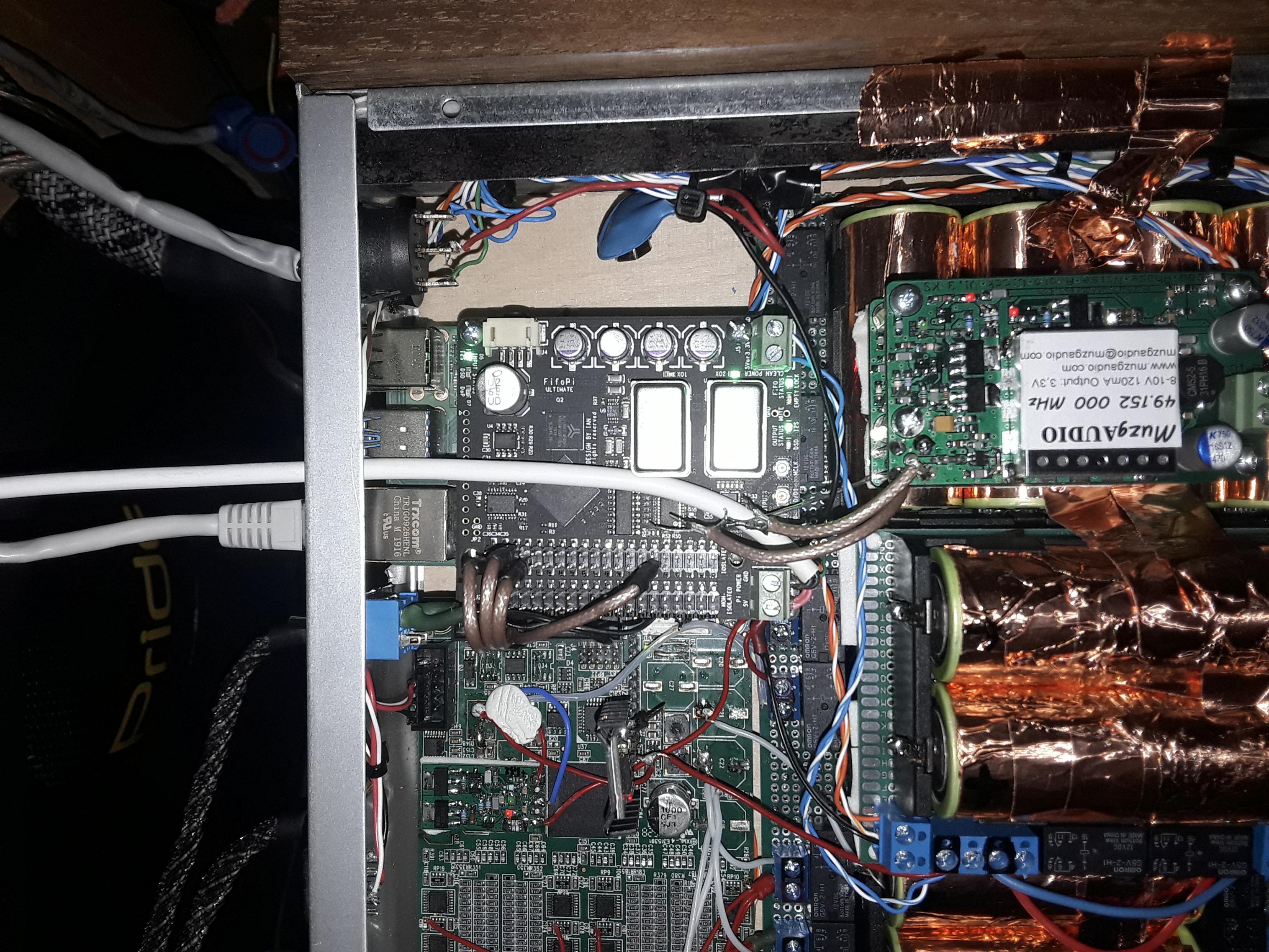

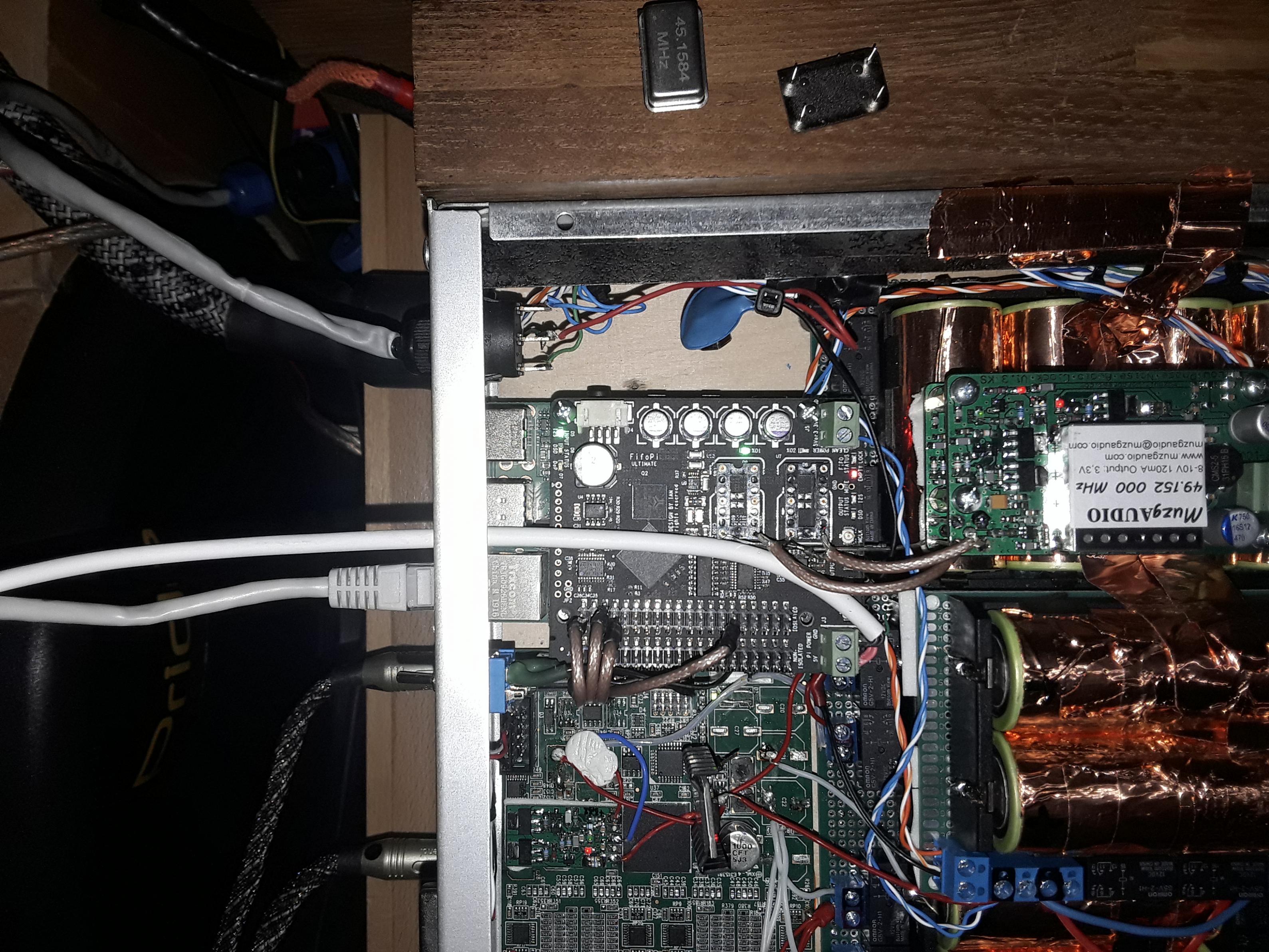

Hello. At last i have my i2s fifopi q2 reclocer from france shop. I have conected to rpi4 and soekris 1021 dam dac and check it work well on org clocks. But i have 45 and 49 absolute hi end muzgs cmos 3.3v output 45 and 49 clocks with their own power suply. and i have connected them. After powering reclocer on board xo leds arw blinking,they dont ses new clocks. Why? I think every thinks is coonnected good. Clocs after measured have 1.55dc ouput. Please help me,why reclpcer dont se clocks? Very thanks
FifoPi Q2 needs XOs having OE control signals. I didn't see you are using them.
(Please see user's manual)
If you clock doesn't have the OE control, please try to use only one at a time for your music frequency.
Ian

Okey i know what is going on with clocks. 45 and 49 mhz clock have same output and pin 1 from 45 and 49 are powering on them.for now i have connected just 45mhz clock. Im thinking to put a 3v coil micro relay and fpr deufalt will be 45 but when fifo fill need 49 it will power on pin1 from49clock and it will put on relay .
Please tell ,e how many mA coil in 3v relay i can use to connect to OE control pin in XO side? I want to connect relay to control changing 45/49clocks.
Hi Bmzmen,
OE is a LVTTL signal. You can not use is to drive a relay coil. And, even you can, the coil will also pick up noice from environment.
Please use one clock for now and wait for my FifoPi Q3, it will be capable for XOs without OE.
Ian

Hi sorry but im starting play fifopi2 and for now im not thinking to change anythink. Mayby i can drive relay by transistor? like this Controlling Relays with Logic signals. it must be corect and siple way to coonect relay or multiplexer.
Not the most elegant solution.. but I manage with one clock by choosing the clock that plays most of my music. In my case almost all redbook so the 45. Then set the player to use SOX resampling to redbook. So when I hit a 96 or 192 it still plays. I really can't hear an improvement in HiRes, so I'm likely alone in my redbook preference. Given this scenario, I'll likely move to a higher Q 5mHz clock when available.
Take a look that link where is some example to use vttl signal to drive relay. I want to check 3v relay driverd by bc550 transistor. I will power relay with another batery, not same that is powering reclocer. And from XO site pin 1 byy 2,2k resistor to bc550. It will be good? Very thanks.
A diyAudio member from HongKong did this months ago. But I don't have his ID for now. Maybe you can ask him for sharing some experiences.
Ian

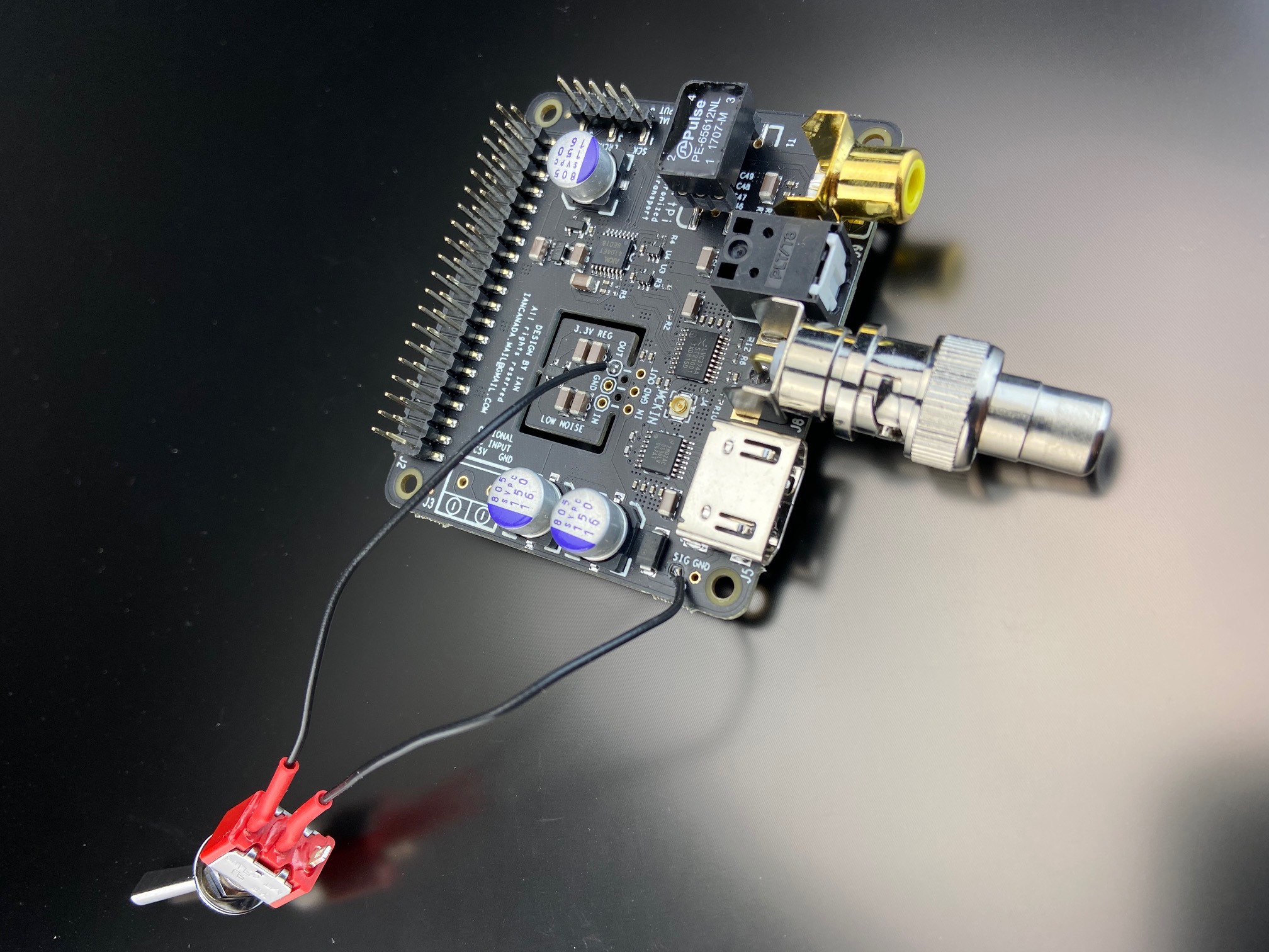

Possible solution for Topping D90 playing native DSD music through HDMI IIS
Some diyAudio members told me that they had problem playing native DSD music on Topping D90 DAC through HDMI IIS input. PCM music has no any problem.
I think the reason could be that the D90 can not detect DSD signal when native DSD was sent through HDMI IIS. So I did some research and found that it's possible to switch D90 into DSD mode manually by setting pin15 of HDMI signal to high.
On the my TransportPi and HdmiPi transmitter boards, I reserved a input "signal" that can set pin15 of HDMI high or low. They are:
J9 for TransportPi
J8 for HDMIPi transmitter
So, if you are using my TransportPi or HdmiPi for D90, the current solution is to connect a switch between the on-board 3.3V output and the "signal" pin. Manually switch it on when you play native DSD over the HDMI IIS. And switch it back to off when you play PCM.
Down the road, maybe I'll consider providing an automatic PCM/DSD switch solution.
Please let me know for any update.
Ian
