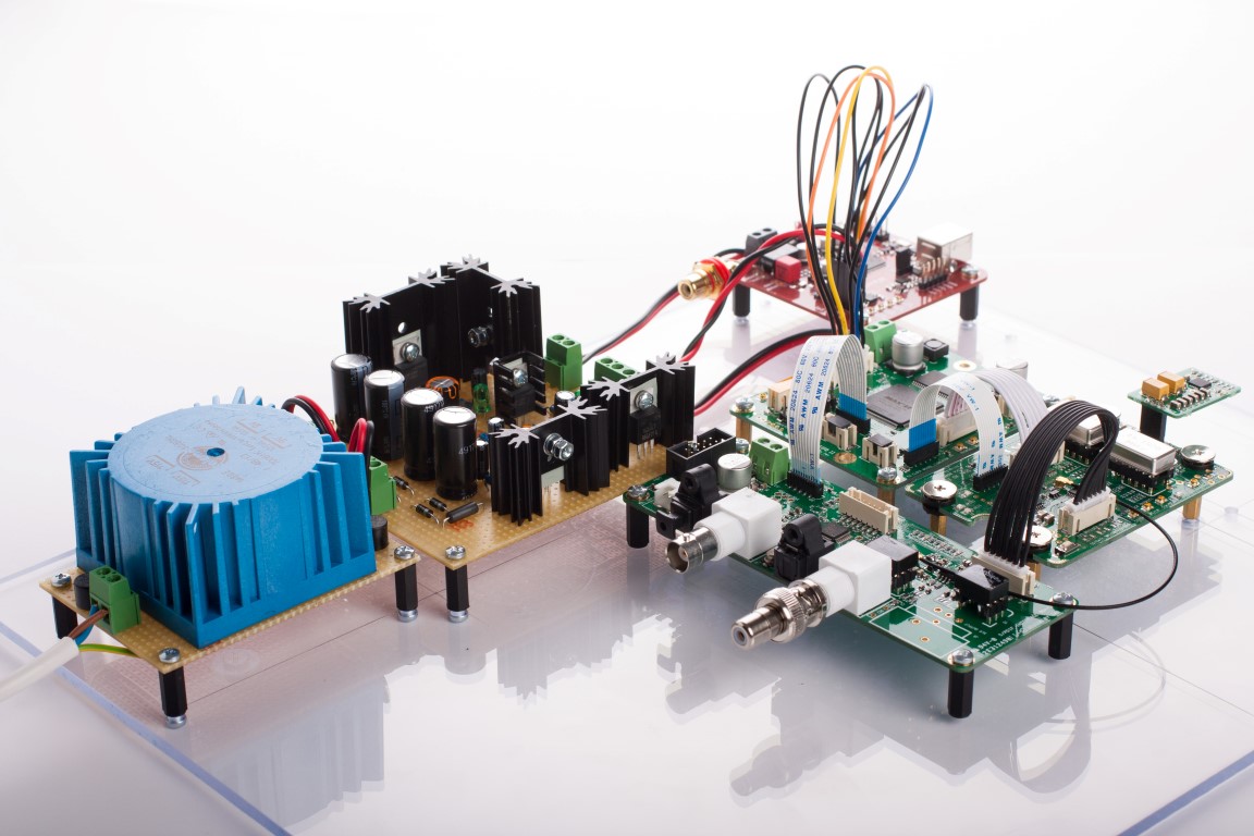

my FIFO runs!
Hi, All,
Finally after receiving the kit and building power supplies, I have my fifo up and running! So far testing/listening with generic clocks; so far I can not hear any difference between spdif out from waveio and spdif out from FIFO. But need to listen more and eventually get proper clocks.
So all in all, I very excited, this is such an interesting platform for experimentation! Thanks, Ian!
There is one thing though that maybe someone can help with. Once in a while sound is getting distorted. After checking cables, etc. I found that it's a BNC to RCA connector that's causing the issue. If I tap very lightly on the RCA cable or BNC adapter, sound get's immediately distorted. Anyone has experienced this?
Thanks,
Alex.

Hi Alex,
Thank you so much for sharing your experience with us. You did a good job! I like your configuration, very clean.
I would suggest you going with 45/49 MHZ CCHD957 or CCHD950 for now. That are not expensive, but far more better than those generic clocks. Both 957 and 950 are excellent on low jitter performance, but they are slightly different on style. For me, CCHD950 sounds a bit more classical.
Besides connecting to S/PDIF FIFO, DACs normally sound better when they hooked up directly to the Clock Board. Because additive jitter might be introduced when I2S signal is converting into S/PDIF again.
Regarding to the RCA cable issue, I'm pretty sure it was connection problem. But I'v never had this issue. Can you please try BNC cable rather than the RCA cable to see if it is fixed.
Have a good weekend.
Ian

Thanks for the nice words. I am indeed very happy that I succeeded in putting it all together. It's been a long time since I did something with electronics and back in those days I was too ambitious and joung so nothing worked :)
The dilemma with clocks is that for now I'd like to keep SPDIF working. Correct me if I'm wrong, but I cannot use 45/49 clocks for 44/48 material, (1024*FS) MLCK is not accepted by SPDIF board. On the other hand, I'd like to be able to have 354KHz sampling capability for FIFO+I2S-PCM+some multibit DAC. Purchasing both sets of clocks is too much. So I guess I'll first develop a DAC (maybe start with simple TDA1543 and then move on to PCM63 and/or AD1862/5). Then depending on the outcome will select clocks. I purchased almost all your boards, so there is enough to play with :)
Yes, I am fully aware of this. Still I like the way my rega dac sounds. So I need to keep it functioning until I develop a DAC that in combination with FIFO will beat it.
Indeed this is unexpected issue. Yesterday I've reinserted adapter once again, and I think it fits well and tight. Then, I changed my more expensive RCA cable for some super no-name el-cheapo one. And guess what, it improved the connection. So I think it's the issue between adapter and RCA plug. The latter probably differs in diameter of outer and inner connectors... I will probably purchase another cable later on, for now it seems OK, at least no distortions while music is playing, only if I touch the cable.
