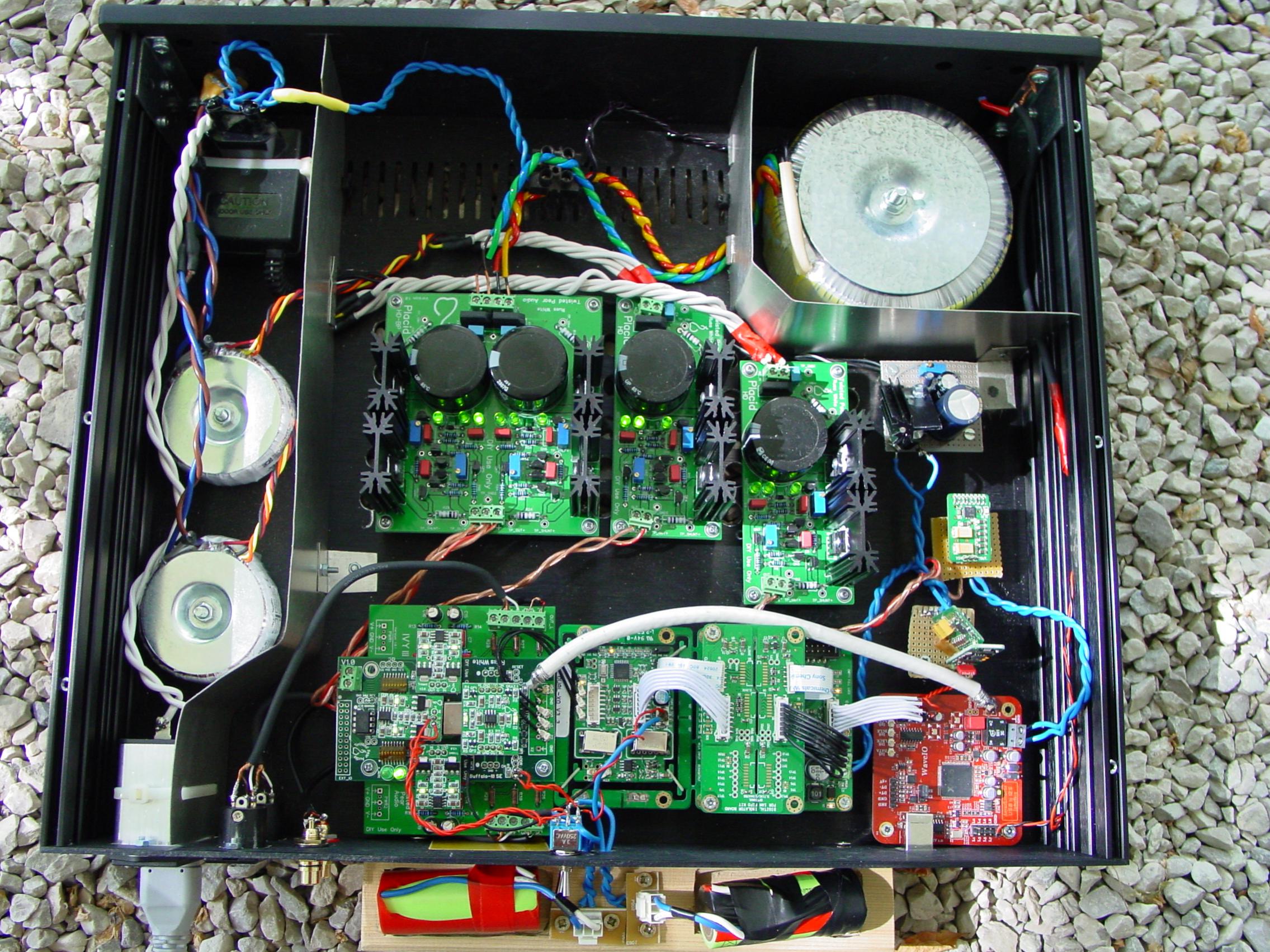

Buffalo IIISE with Ian's FIFO and Luckit WaveIO
Just finished my DAC. As Luckit WaveIO supports two simultaneous outputs, SPDIF and I²S, and Buffalo DAC supports to switch between two inputs, also SPDIF and I²S, I managed to be able to switch between Buffalo onboard Clock CCHD950 (and SPDIF) - and Ian's FIFO Clock CCHD957 (and I²S). Interesting comparison! Furthermore I realized to switch onboard clock between mains/ shunt regulator supply - and battery LiFePO4 supply, indeed an improvement with the latter. FIFO dual XO board is always fed with battery LiFePO4.

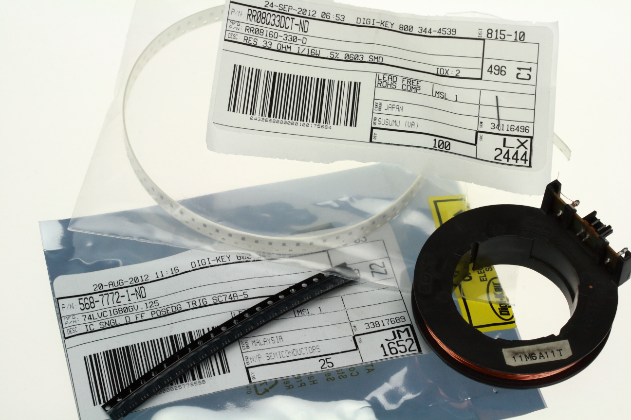

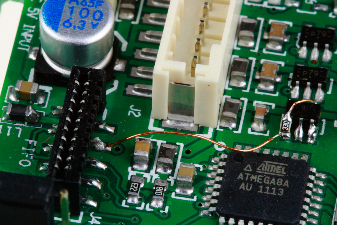

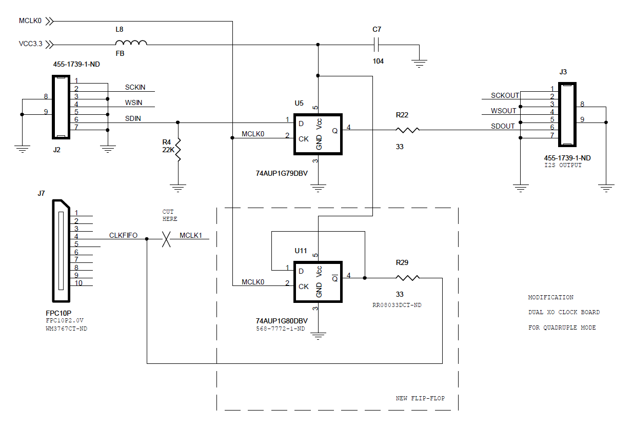

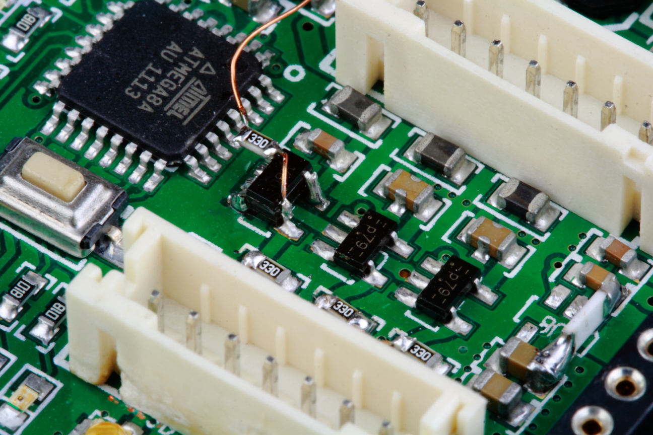

Dual xo clock board modification for 90.3168/98.3040MHz XO
Principle of modification
To run 90.3168/98.3040MHz XOs, dual xo clock board needs to work at quadruple speed mode. Normally, dual xo clock board feeds full speed MCLK into FIFO for single and double speed mode. The new modification idea is that if we feed half speed MCLK into FIFO, the single speed mode will become double speed; and double speed will become quadruple speed. That's what we want.
To achieve this modification, we just need cut the old FIFO clock trace, generate new MCLK/2 by an additional flip-flop and feed it into FIFO. The attached schematic shows the details.
Dual xo clock board can support 90.3168/98.3040, 45.1584/49.1520, 22.5792/24.5760 MHz XOs with this modification, . Firmware in both FIFO and clock board will keep no change.
Material
1. 1G80 flip-flop in TSOT23-5 package
2. 33 ohm 0603 chip resistor
3. a small piece of wire (I use 0.1mm coil wire)
Steps of the modification
step1: Cut the old clock trace at bottom side of dual xo clock board PCB before R28;
step2: Stack 1G80 on top of the last 1G79, band pin 2,3 and 5 of 1G80 down a little bit (be careful of break off), bridge the three same pins down to the 1G79 buy solder;
step3: solder a wire to jump pin1 and pin4 of 1G80 together, and then solder one pin of the 33ohm 0805 resistor to either of the pins or to the jumper wire;
step4: connect the other pin of the 33 ohm resistor to the pin4 of J7 with by a wire;
Now you can enjoy your 90.3168/98.3040MHz XOs. Pleas look upon your XOs as half of its frequency for settings according to previous documents.
