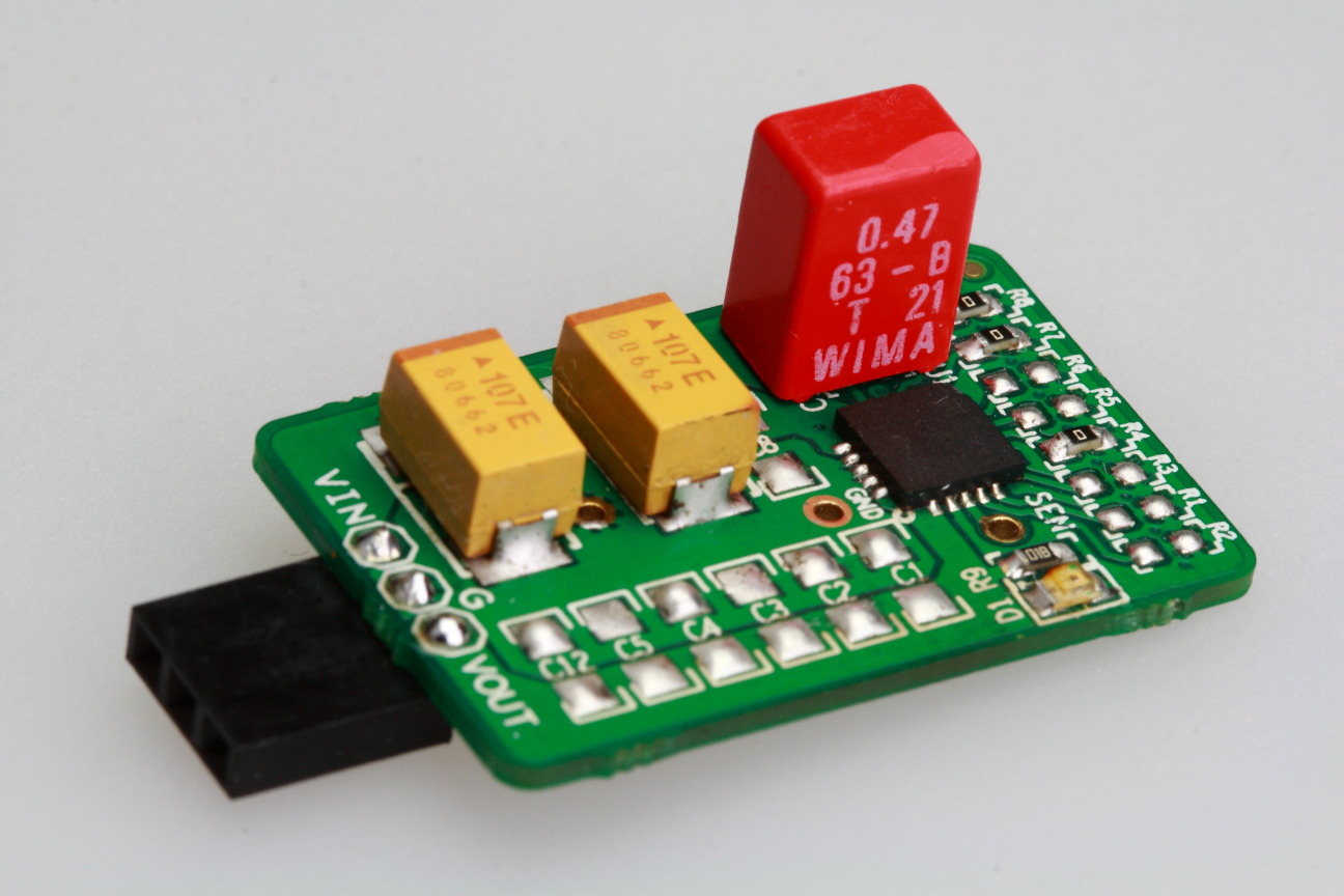

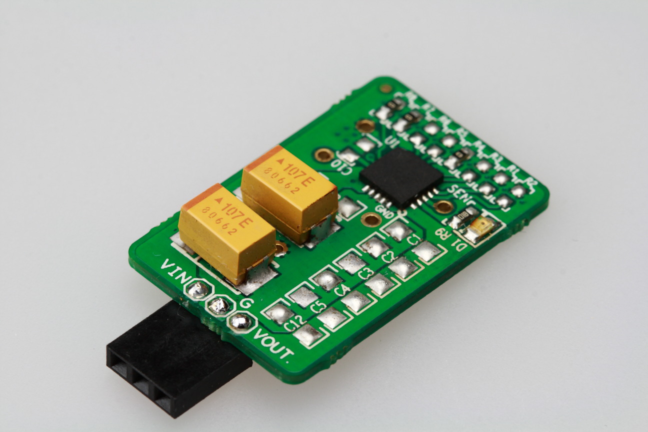

Modding TPS7A4700 low noise regulator
Based on powering Si570 clock board form a 3.2V LifePO4 battery direct as a reference recently, I found there still some space to improve the performance of TPS7A4700 low noise regulator.
1. Upgrade the noise reduction capacitor CNR
The first priority is to upgrade the noise reduction capacitor C10 to a nice film capacitor. Remove 1u MLCC C10, replace it with a WIMA 0.47u/63V capacitor on C11 position which was especially reserved for this purpose. The one I use was:
WIMA P/N: MKS2C034701C00KSSD, or
Mouser P/N: 505-MKS2.47/63/10.
This capacitor works as a filter of the control loop of the internal voltage reference, so it will decide the noise performance of TPS7A4700 itself. Though the MLCC is good at high frequency, but it’s not as good as a nice film capacitor at low and middle frequency, together with the piezoelectric effect, film capacitor is no doubt the winner for this position.
The result is quite positive. Improving on sound quality of the Si570 clock board was very obvious. It worth to try different candidates or large capacitive to find out which one is the best of best.

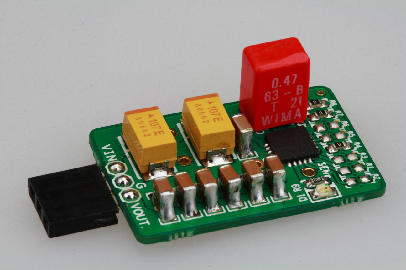

2. Upgrading the output capacitors

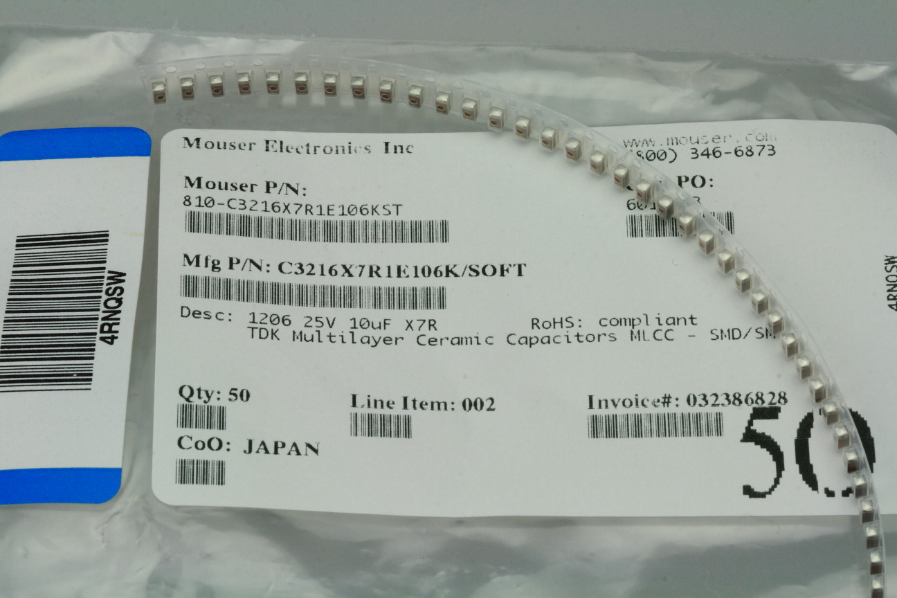

I found TDK has a new technology ‘soft termination’ series 10u/25V 1206 MMLC. Comparing with normal MLCC, it’s expected better on reducing the effect of vibration and shock (piezoelectric effect). They are only available on Mouser.
TDK P/N: C3216X7R1E106K/SOFT
Mouser P/N: 810-C3216X7R1E106KST
I replaced all 10u MLCC: C1,C2,C3,C4,C5,C8,C12 with this now technology capacitor, the result is also positive, but not as much as replacing the CNR.
Or, you can stack the new capacitors on top of the old ones. It will sound a little bit different.

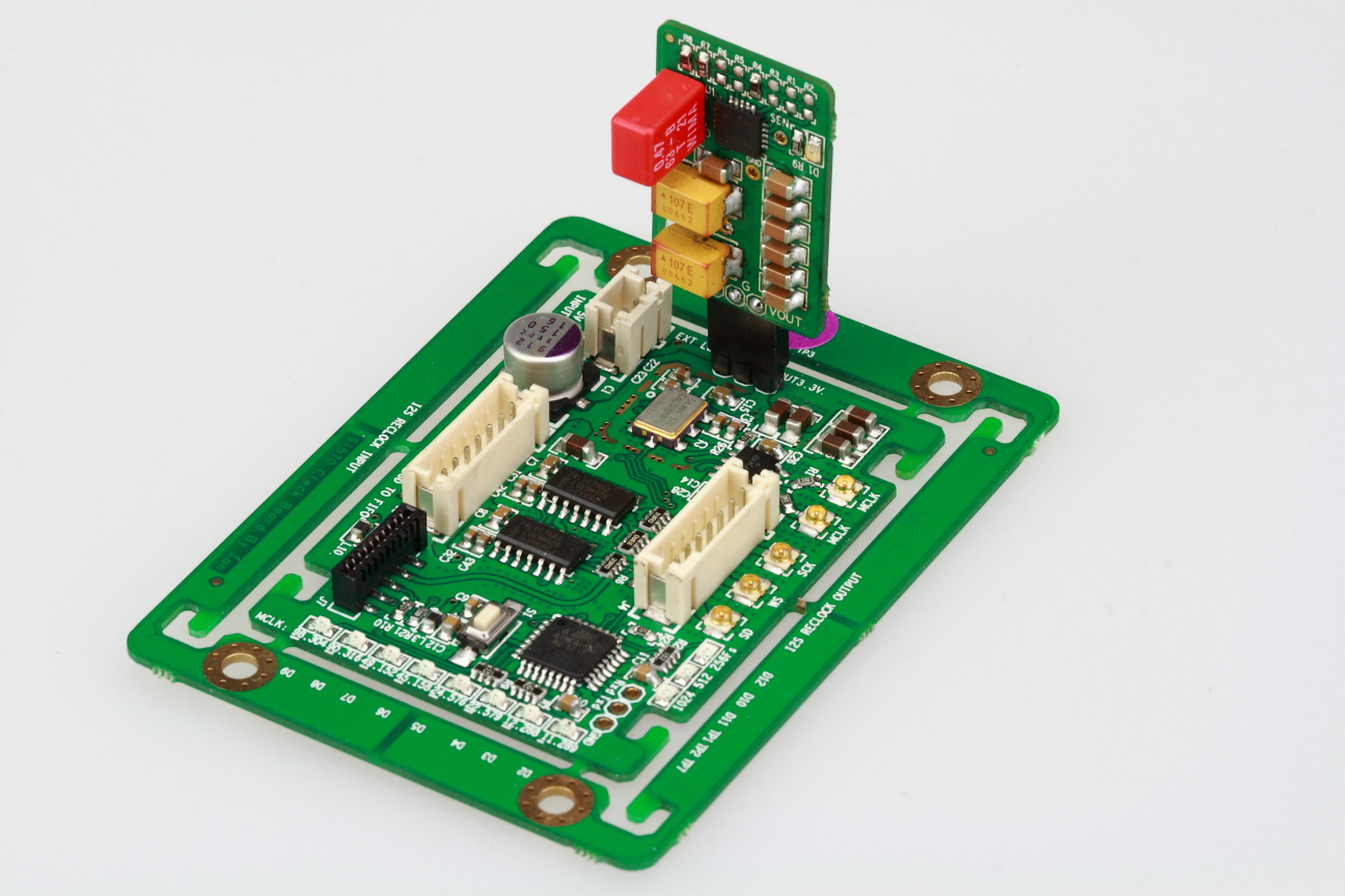

All this sounds very encouraging but i have a more pragmatic question: does the Si570 board, powered from batteries, sound subjectively better that the dual clock board using Crystek oscillators with the on-board regs?
I guess i should get off my *** and try this out myself. The caps will obviously still matter, even with batteries...

Hi analog_sa,
The phase noise performance of Si570 is not as good as CCHD957. But it might be the best 98.3040MHz/90.3168MHz clock sources we can touch so far, except you can order OEM CCHD950 or OEM low phase noise OCXO.
Si570 draw around 110mA current, 4-5 times more than traditional XO, together with some dynamic load response, it will ask for more from low noise power supply. So, to maximize Si570 performance, the real challenge is the power supply. Any improvement on noise performance of power supply will result in improving on sound quality.
I suggest you stick with dual XO clock board if you don't need 98.xxx/90.xxx MHz frequency and the inverting MCLK. Otherwise, it worth giving a try.
Ian
