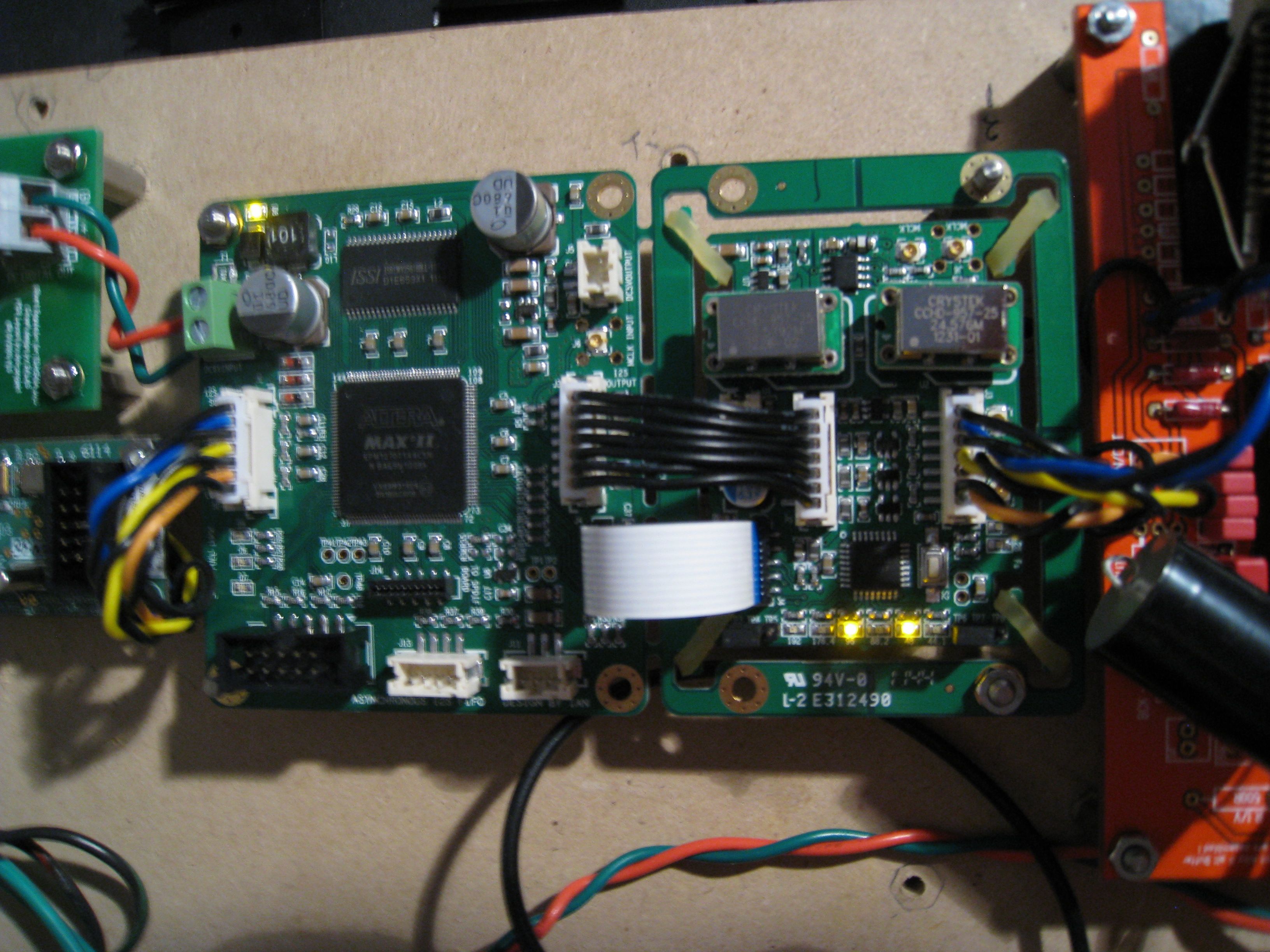

I'm finally getting around to trying the Dual XO board with the Crystek clocks.
There's a problem somewhere as I get 48k and 96K led's lit, but no Fs and no sound. Can someone offer help? All my music is 44.1k.

Your FIFO didn't get clock signal from your clock board. You can see all of three LEDs are off. Check the 10P FFC/FPC cable, or get back to the original XOs just to see if it's working.
Ian
I put the original clock board back in and it works fine.
I had purchased another Dual XO board from the last group buy. Installed and working perfectly! BIG difference in the sound....
