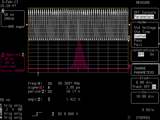

Si570 Clock Board GB version V3.5(6) – Jitter measurement result
Yesterday, I received a finished GB version V3.5 Si570 clock board sample from my SMTA supplier to confirm. The first thing I did was measuring the real jitter performance. I think this part is what you are interested in the most.
Here is what got:
Period jitter RMS: 3.85 ps
Period jitter peak-to-peak: +-12ps
Jitter distribution: Gaussian
Frequency: 98.3097MHz
N = 10,000 cycles
Sampling at 8GS/s
Please see the attached jitter histogram plot for details
Please note, my oscilloscope comes with 2ps RMS jitter floor. If we take other factors into account, such as testing environment and calibration, the total jitter floor could be even bigger. So, if we exclude those numbers, the actual testing result we can figure out is not bad, very close to the period jitter specification from the official datasheet.
Again, measuring jitter in time domain is not the best way to evaluate a clock. Because we can see jitter from statistics only, but the spectrum. The best way is measuring it in frequency domain by a phase noise analyzer.
However, if we get testing results compared, it still tells a lot of secret. Please find the jitter testing result of the generic XO I posted weeks ago, you can see what is the difference in between.

Thanks Ian, I think that looks great and seems devoid of the spurious noise some expect from such a device.... where is it guys? most seem to forget, or do not know that the clock is generated by an internal crystal.
for a speed of 98MHz I think this is very good, even if we do not consider the additional advantages of this multiple frequency clock. we can set it to be running at the ideal/preferred FS multiple for each sample-rate.
Looks like a good result, even if Ian is right when saying the phase noise should be the best measurement.
BTW, the measurement should be done at 11.2896MHz, to directly compare to the generic XO measurement, and theorically (I repeat theorically) the noise in frequency domain should be better an so I expect improvement in time domain also.
Is there any post with the generic XO jitter measurement?
If yes, its jitter is around 6ps or lower?
I assume there is no period jitter measurement of the generic XO (stand-alone, not in the clock board), that could be very useful for to understand where the jitter come from.

It's a great measurement result!
N = 10,000 cycles
Sampling at 8GS/s
Would you reply to my primitive questions?
Please feel free to ignore those. I know very well that you are too busy.
1. In an example datasheet of oscillator devices, like this,
7311S-DF-255R(Fixed Communication)/Simple Packaged Crystal Oscillator (SPXO)/NDK
here we find such a description;
> Phase jitter (RMS) Max. 1 ps(12kHz to 20MHz)
Does your measurement give the frequency range condition as well?
The reason why I ask this is that I want to apply an apple-to-apple comparison.
2. Does the "N = 10,000 cycles" mean that your histogram and statistical calculation results are based on 10,000 sample pulses?
How many raw sampling points of which sampling frequency are used for the internal calculation in your LeCroy digital oscilloscope?
3. When we look at phase noise measurement charts, dBc/Hz values within 1-100 Hz range show big differences in general. Is your jitter histogram equivalent or does it cover the same frequency range?

Would you tell me the difference between a period jitter and a phase jitter in spite of the same unit [ps RMS] if you have enough time or you know a good web pages that explain the difference in plain words?
Bunpei
Bunpei, you may review this: Jitter Specification: a Summary H i F i D U I N O :) (I don't claim this is definitive, just based on my limited best understanding)
I think phase jitter RMS = 10 x period jitter pp, but pp needs to measured for a larger sample according to industry standards...
Correction: 10,000 is industry standard...
So phase noise jitter RMS=2.4psec (pp being +/-12 or 24)

I think that the phase jitter measurement of ps order covers quite a different range from the phase noise 1-100Hz range.
To glt,
Is the following expression correct?
phase jitter RMS = 0.1 x period jitter pp
Bunpei
Joined 2004
Without knowing the composition of the jitter/phase noise you really cannot arbitrarily map one to the other.
Also cycle to cycle jitter, which is very relevant to moving data may not show any low frequency components. I have tried measuring jitter on an FM modulated signal (+/- 100 KHz on 10 MHz and got less than 25 pS of jitter.
For DAC/ADC clocking you really need to look at the spectrum from 100 Hz (AES or really 20 Hz) to the max bandpass of the system. Beyond really doesn't matter much. The best way of course is in the audio output since that is what really matters.
