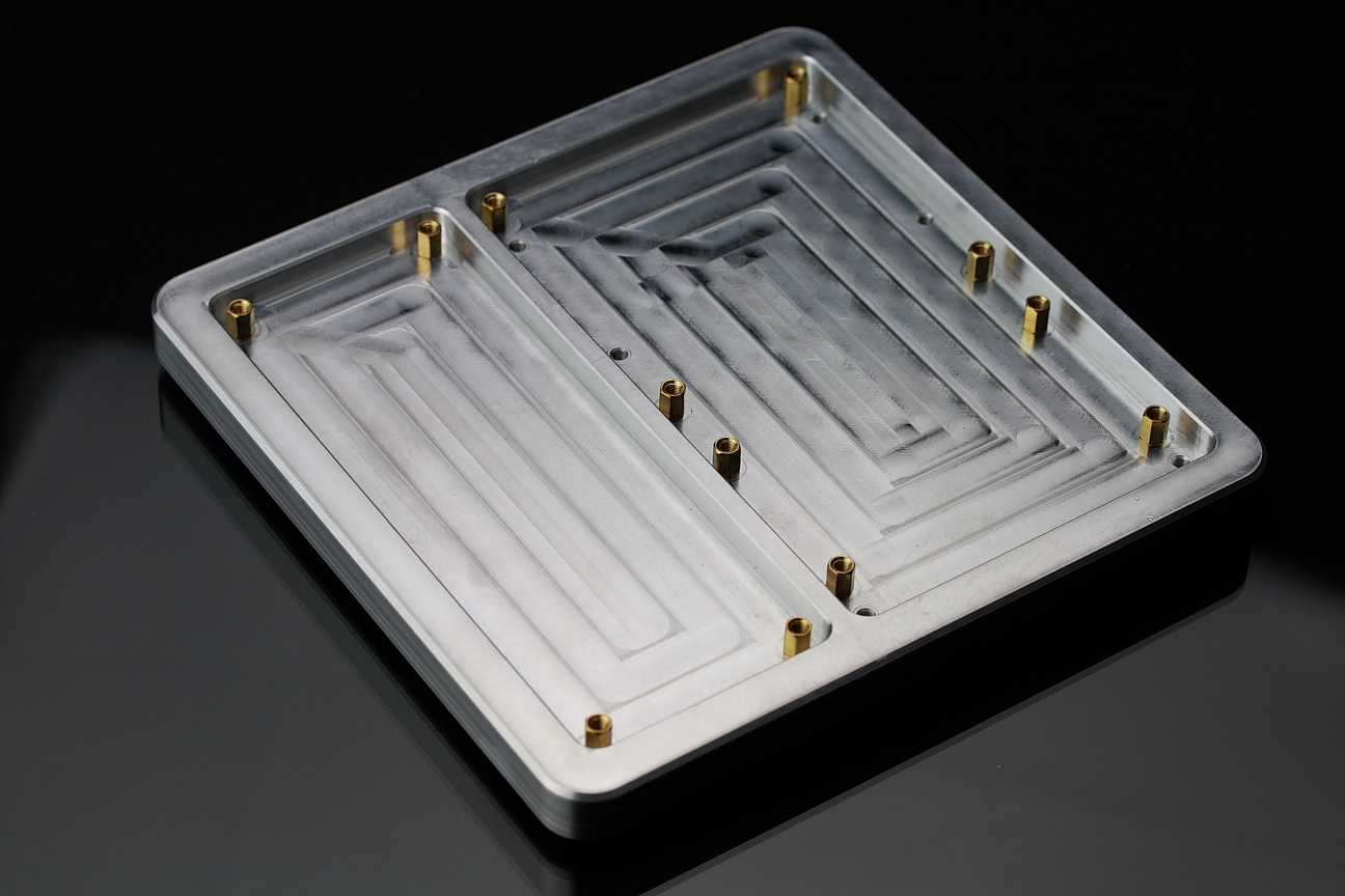

Metal base integrating everything together

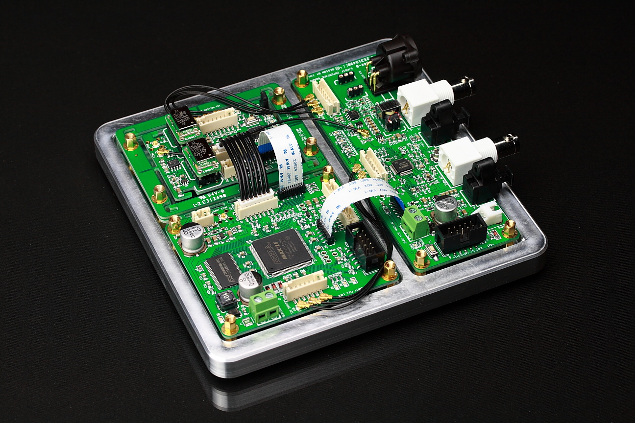

I designed a very simple metal base by Solidworks trying to integrate everything together. A friend of mine machined it by a CNC for me. Although this one is not as good as a real case, but it’s already much better than the wood base.

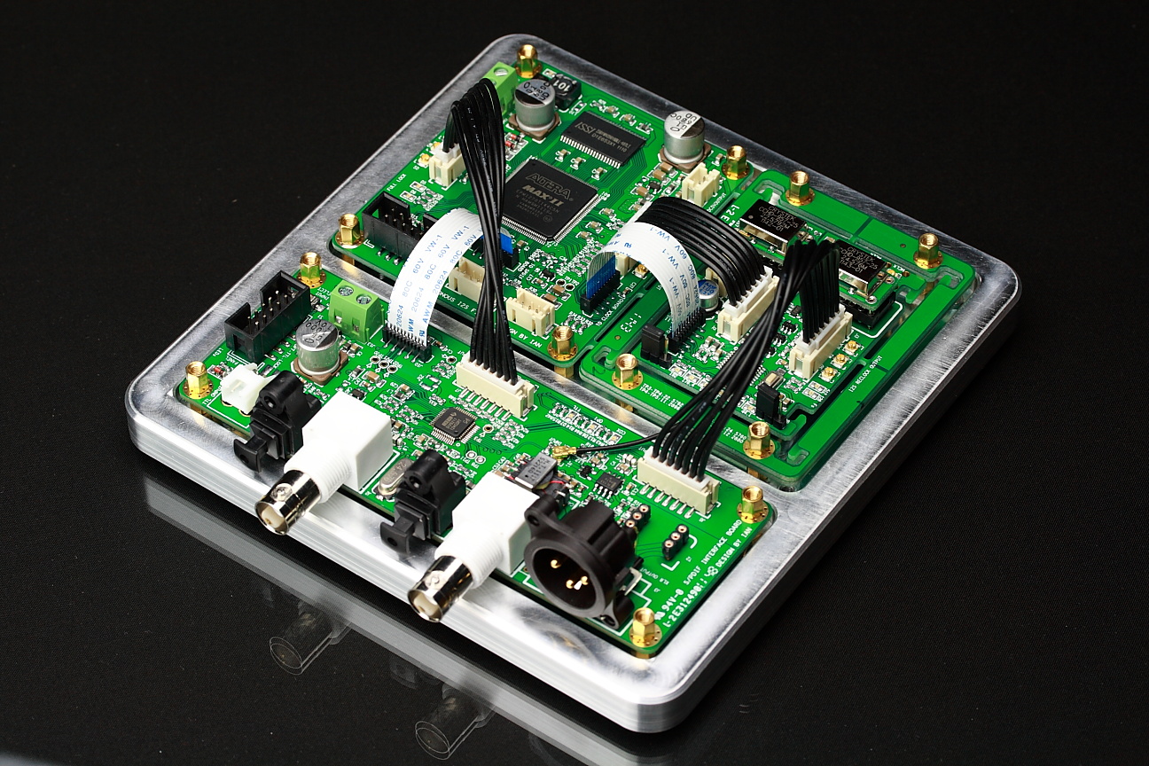

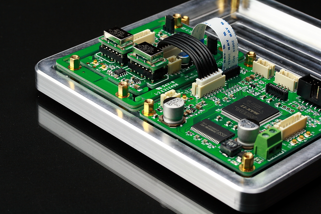

With the FIFO board and the double XO clock board hooked up on the metal base, it become a I2S FIFO with possible low jitter secondary clocks and automatic Fs switching function; And by adding another S/PDIF interface board, it become a working S/PDIF FIFO.
The S/PDIF interface board on the picture is a new upgraded version with balanced AES/EBU XLR output, because I found connecting the output of the S/PDIF FIFO into a DAT or other professional digital audio devices is very interesting. But personally I like the coaxial cable a bit more.
Connections of the I2S input and output bus between the FIFO board and the S/PDIF board could be either 7 pins PH2.0mm cables or U.FL cables. I like using U.FL cables connecting I2S buses because they come with better signal quality (also bit more expensive), although some DAC is only sensitive to the jitter from the master clock.

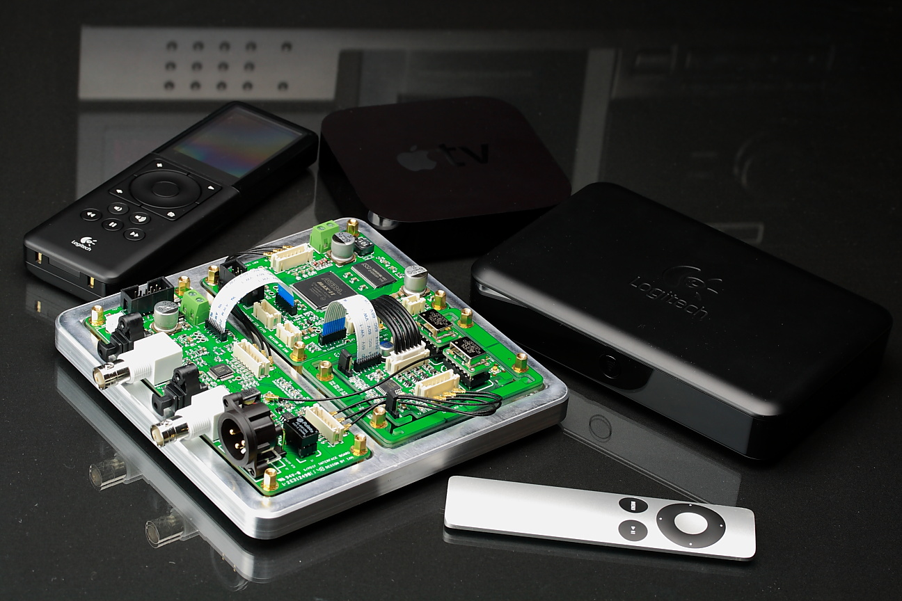

Now, I’m trying to integrate my other digital audio sources with the S/PDIF FIFO into my system, such as Squeezebox Duet, Apple TV II, Foobar2000 and Mega CD storage. Those are very pleased experiences. For example, by buffering the digital output of the Squeezebox Duet with a S/PDIF FIFO which equipped with CCHD-957 low jitter clocks, the Squeezebox is no longer the one it uses to be. I think this is one of the best ways to boost the audio quality without opening and modding those devices.
