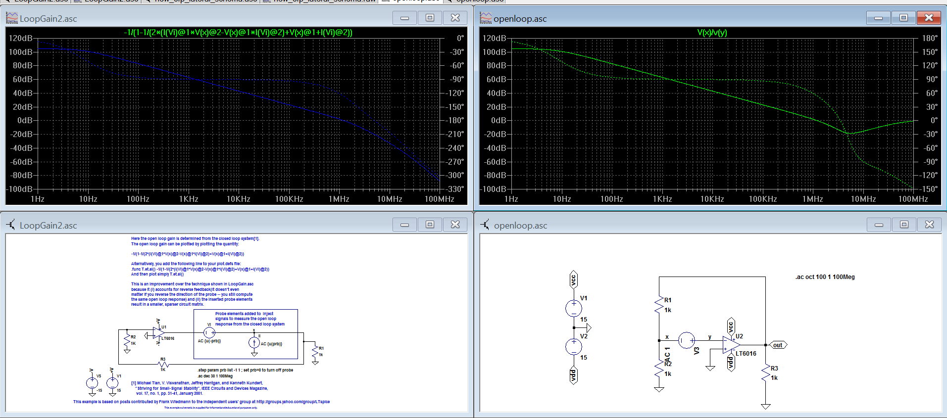

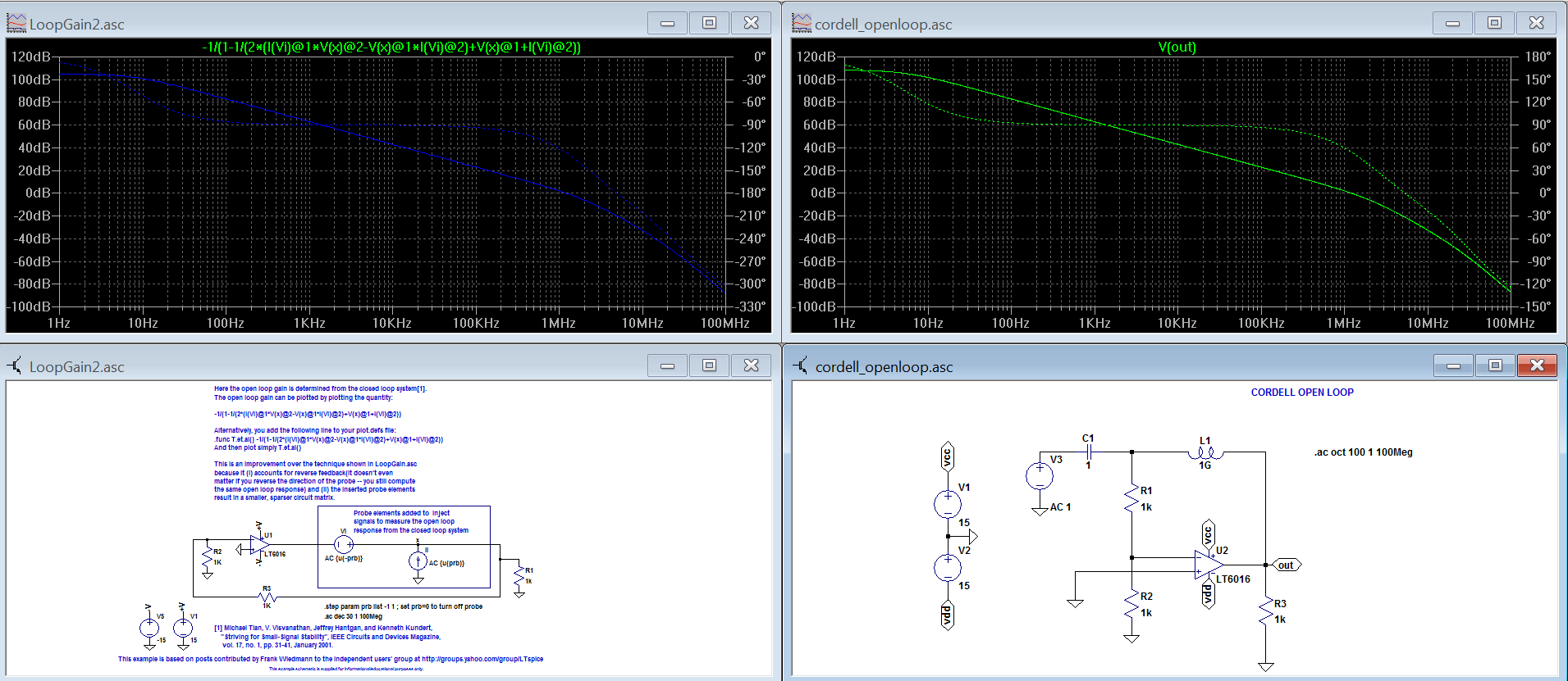

To simulate the open loop gain I resort to the simple approach of inserting an a.c. voltage source into the feedback loop and then plotting the ratio of the voltage on one side of it with respect to the other side as a function of frequency - you are effectively injecting a signal into the feedback loop and measuring the gain and phase. Somewhere around there there's a good link to see how it's done but I can't remember where it is - there may actually be an example file in the LTSpice examples folder. Edit: try here: Solutions - LTspice IV: Stability of Op Amp Circuits
This method is very simple and I also use it, but is not very accurate, the best method is the TIAN probe but very complex. I also like the Bob Cordell method, it is very simple and intuitive, and give results similar to the Tian probe as long the open loop impedance of the amplifier is relatively low (that is the case of almost every audio power amplifier).
this images represent the 3 methods with the same circuit.
the first image is the tian method vs the bob cordell method.
the second image is the tian method vs the method apresented in the video that Bigun posted. As one can see the difference is huge and can lead to not so good conclusions.

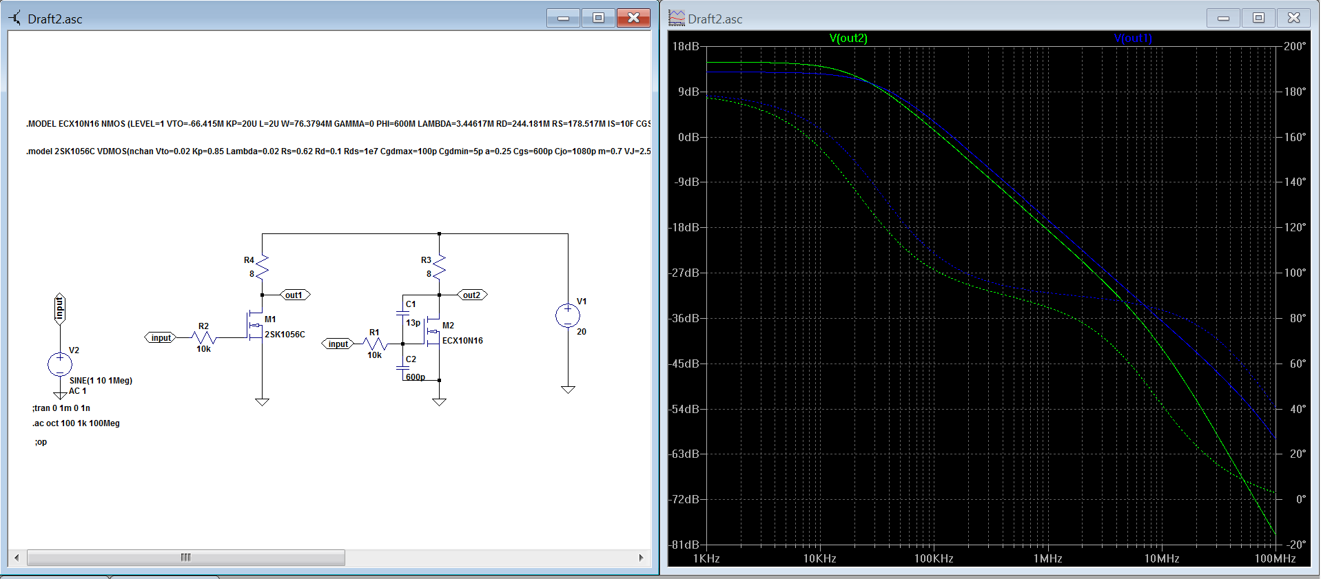

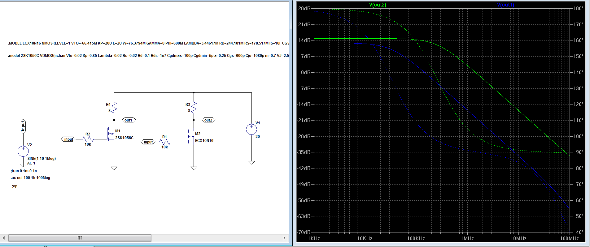

So in the last attempt to explain what is the problem with the models post in #210, I made a simple circuit with the cordell model of the lateral mosfet and the model post in #210. this circuit use a 10k gate resistor to slow down the mosfet.
as one can see the first image shows that the #210 model is ten time faster that the cordell model, and that happens because the #210 model does not include the parasitic capacitors, in the second image is added Cgd and Cgs to the #210 and now the bandwidth is similar to the cordell model.
but the capacitors in cordell model varies in capacitance as the Vds varies, as a real mosfet will do.
Using the #210 model to simulate the stability of the amplifier is not advised and the result will be much different that the real amplifier . So... again my advice is to use the Cordell models.

Exicon. magnatec , semelab, renesas lateral mosfets are clones of the hitachi famous lateral mosfets, and are essential the same.
the parasitic capacitance's in a semiconductor are not static, they varies with voltage, for example the EXICON datasheet indicates a CISS of 500pf at Vgs of 0v but the renensas 2sj162 datasheet indicates 900pf at Vgs of 5v , but if you look at the graph on page 4 you will see that at Vgs=0v the 2sj160 have also 500pf of CISS, and if you look at page 3 of ECX10P20R , the CISS at Vgs=5v is 1100pf.
The semiconductor manufacturers can play a bit with datasheet numbers to make believe that their product are better than the ones offer by others.
The Crss in the Cordell model varies like a real mosfet do, and at Vds=30V will be 10pf at 100v will be 6.5pf and at 10v will be 20pf.
the Cgs is static at 600pf for the 2sk1056c.
The cordell model is not perfect, but will be more usable for simulation.
