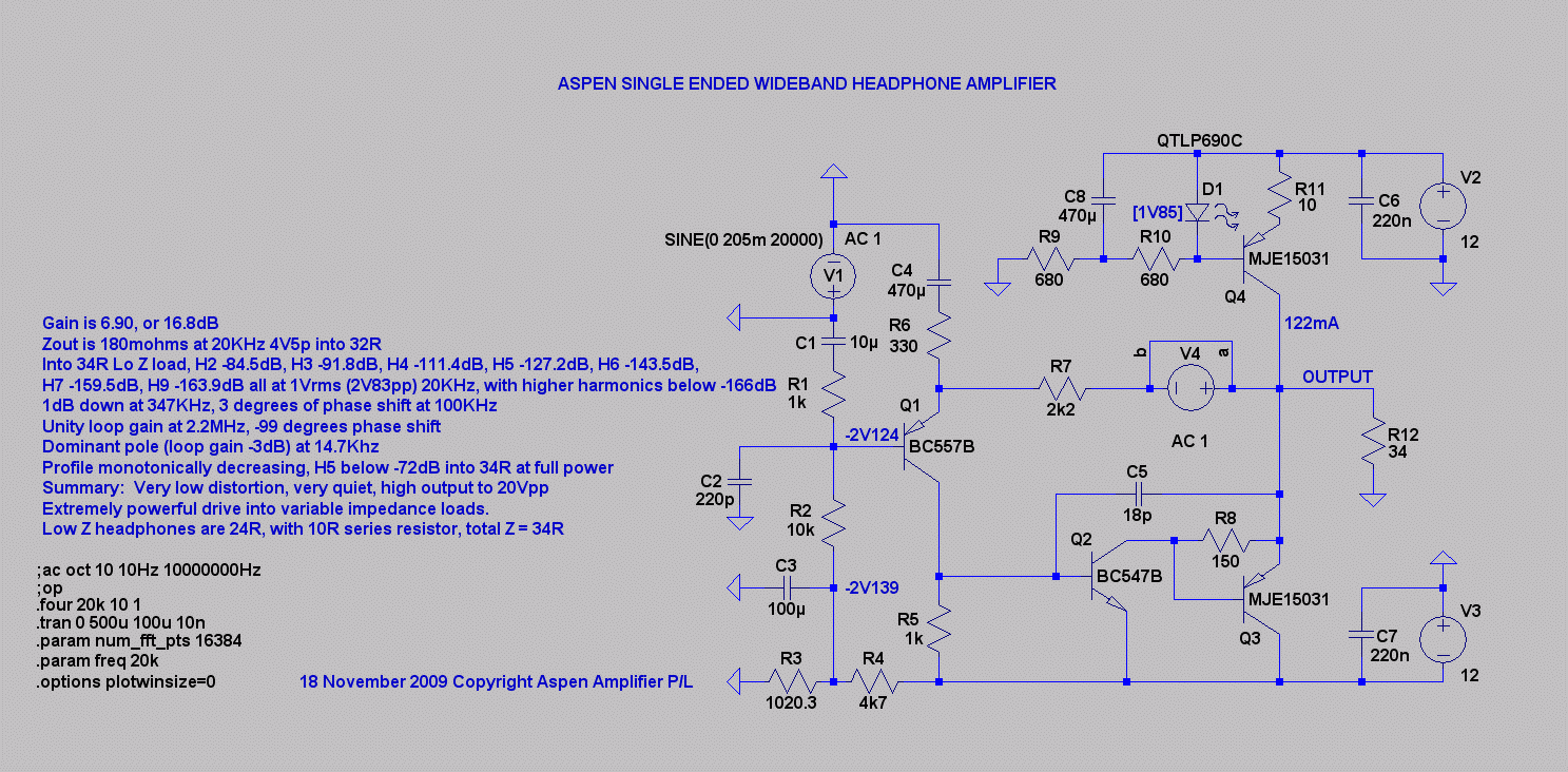

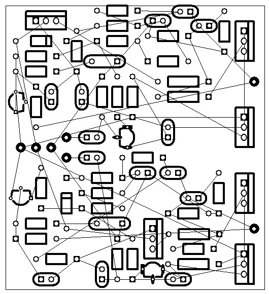

I'm very much interested in building this amp. I've gone ahead and started building a boardlayout. I've gotten to the point of connecting all the via's. It's based off schematic in post #1.
Don't mind the mess, I've got a long way to go :p
