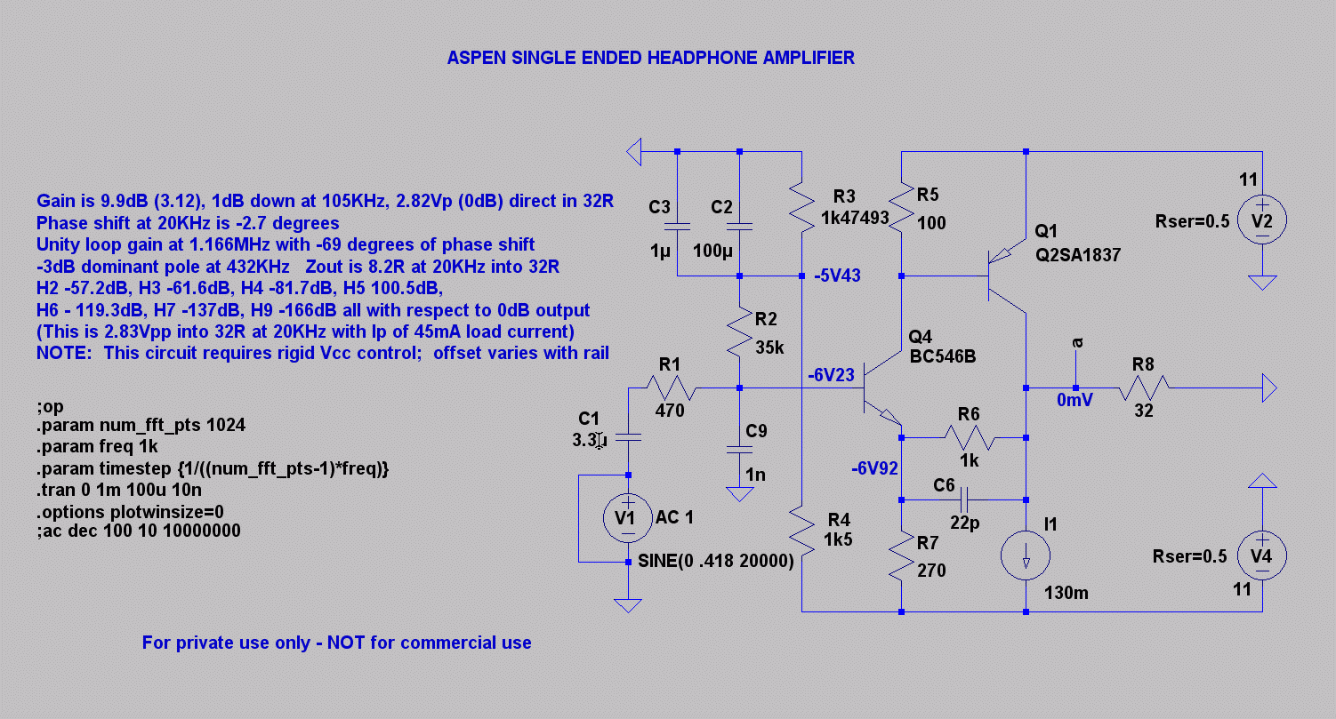

This amp is offered only for the purpose of CHOICE. We can have either, but a choice must be made and you play a big part in that.
I have refined it further by halving current through the master device of the CFP, amending bias points and making more measurements. It's now down to a respectable 0.14% H2 (-57.2dB) at 0dB output into 32R, less into high impedances. I have changed the compensation after reviewing the Bode plot, and it's lookin' good, with less phase shift overall, only 2.7 degrees at 20KHz.
The distortion profile is classic monotonic decreasing, with H7 at -137dB, which is pretty good. Output impedance is now 8.2R, a bit better than before. This would work well, BUT, it will give a very different sound to the push pull circuit, a more organic, tubey sound.

Here it is, with simulated measurements:

Hi Hugh,
I suggest the 22pF is unnecessary. This amp is very wide bandwidth, distortion is not an issue (0.14% at 2.4V pk) and remains unchanged to about 200kHz before starting to get worse. Phase change at 100kHz is an impressive 0.22 degrees, 0db occurs at 12.5 MHz. This is a nice amp.
I would make the output capacitively coupled with single stabilised supply at 24V, then the bias is not that important and the offset can be a couple of mV here or there.
I used BC547C and BD140-16 in my simulation, I used a 100 ohm resistor as current source, it did not make much difference in the THD at all.
This amp has the potential to be a great amp and I think it is going to be your best sounding amp that you have ever made Hugh.
I will build it up on the week-end when I am home and report back. It is simple enough that anyone can just space wire and try it. Even though I have not heard it, what I see encourages me to ask the guys to sit tight until the week-end. I have a good pair of cans and it does bring out the best in an amp.
I think it will be worth the wait because I can compare the one amp against the other using real live recordings we have made.
Kindest regards
Nico
Nico,
This is uncharacteristically rhapsodic, are you absolutely sure there is nothing in your baked beans?
Interesting that your simulator, a bought one, gets such different results to mine. I see about 9dB of loop gain at audio frequencies, no more.
I don't have any cans, that's how well set up I am..... we await with knitted brow......
BTW, I use this circuit block in my tube hybrid preamp. The CFP gives voltage gain (4, in this case) while the pentode output stage is configured as a cathode follower. It sounds pretty damn good.
