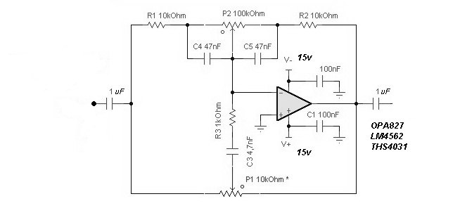

Hello Nico
As an old geysers, I've try few type of bass/treble control, passive type was not good, the treble booster I've post in another thread was good but I've redone a sim with this last bass/treble control circuit using an op-amp.
There is many op-amps who can be use, OPA627, OPA827, THS4031, LM4562, and OPA637 but you would need to boost the circuit gain to more than 5 for this last op-amp
My Tina simulator are easy to use but limited, so maby Hugh, nico, bigun or KT could come out with a better circuit.
So here is the schematic.
Bye
Gaetan
As an old geysers,
I think the word you want is geezers. Geysers spout water or steam. Geezers spout off.
As an old geezer with declining hearing, I actually set my stuff up fairly flat, or even rolled off a bit over 10k. True, I don't hear much up there, but then I don't hear much up there when I listen to live music. So a flat setting sounds most realistic to me - which is what I think Hugh was referring to when he said we compensate. Some day, I'll have to compensate with a hearing aid. At that point, headphones with boosted HF would allow listening w/o the aid to replicate everyday hearing.
I'm not arguing for or against tone controls here.
Sheldon
