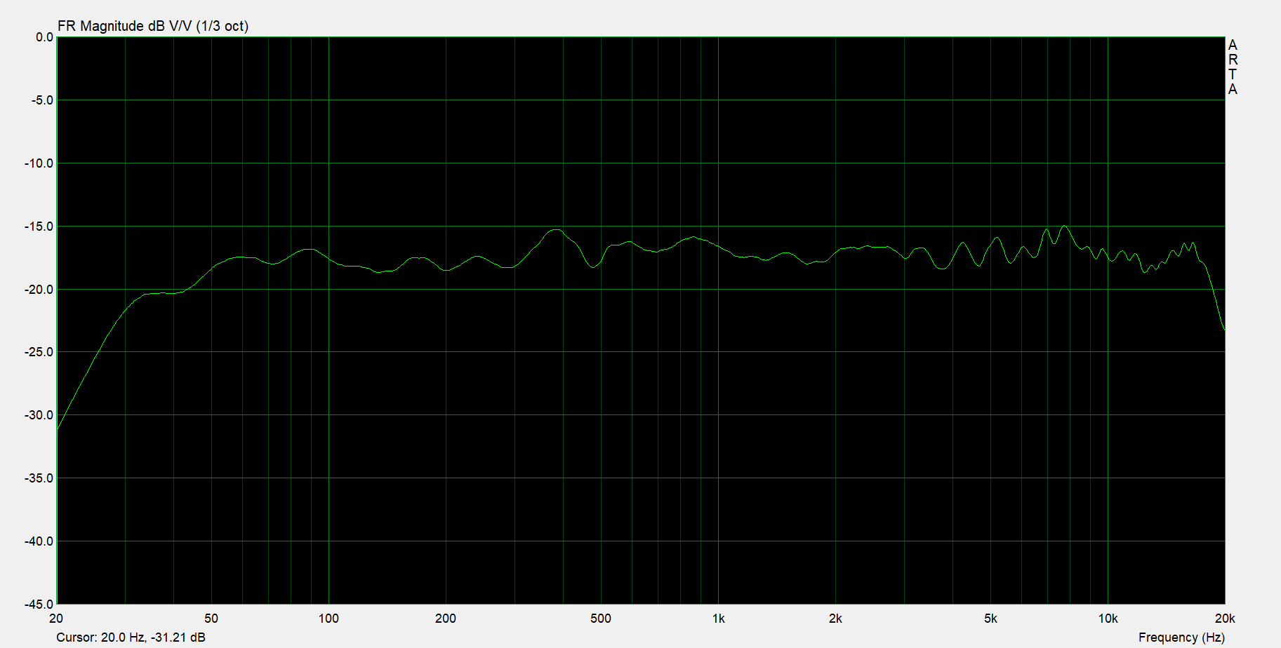

This is the part where I "stumble" a bit, at least relative to what has been posted (graphically from Arta) with regard to the latest discussion.
Classically with respect to the 1-2 kHz octave you've typically got two centered "columns" between 1 and 2 kHz plus half a "column" on either side of 1 and 2 kHz.
In the picture below, between 1 and 2 kHz, I'm seeing a degree of oscillation between about 1.2 kHz and 1.9 kHz that at least to me does not represent what I know as a classical 1/3rd octave-band representation.
https://www.diyaudio.com/forums/attachments/multi-way/790186d1572000390-arta-arta-response-png

I do not see "oscillations". What I see is 1/3-octave smoothed response.
It is not band representation, as in RTA, which you can choose in Graph Setup dialog by setting combo box Frequency Axis-> Type to "Octave bands"

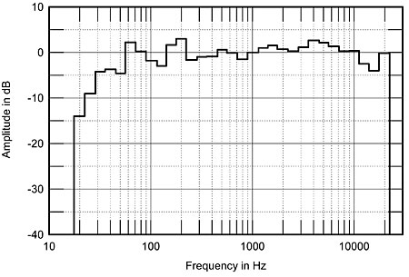

That is what *I call "classic octave-band" (either vertical bar chart or the less known stepped chart) - and it's what I would expect (in a smoothed variation) for a given octave representation.
*and I don't think I'm alone on this after having done a search on: "classic octave-band".
Below is an in-room 1/3rd stepped (..in reference to Martin Colloms). Note that it still only has 4 different pressure levels between 1 and 2 kHz. Though very fine in detail, that's not what I see when looking at the Arta graph previously mentioned.
