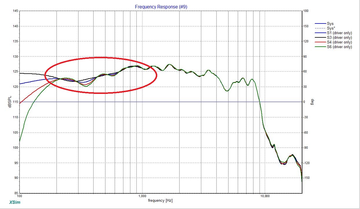

Can anyone help me with the following issue I'm having with ARTA:
I'm trying to take gated measurements of a Woofer. I performed 4 measurements with the mic on axis with the woofer.
For all 4 measurements, no settings were changed: The mic location was kept the same, the speaker location was kept the same, same gating, same software settings....same everything.
However, my low-frequency response changes with every measurement. Anyone know why this would be the case?
