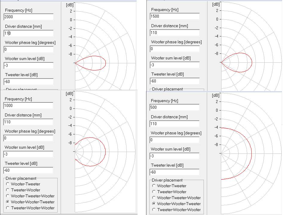

Got you. Playing with xDir it seems if I choose MTM and set driver distance to 100mm and set the tweeter very low in gain, then the M-M distance is 200mm. So I opted for MMT and used a midrange to midrange distance of 110mm to simulate the horizontal dispersion of a vertical array built with two 4" drivers side by side almost edge to edge. So an array of maybe 4V x 2H, or 3V x 2H. Below is the simulation at 500Hz, 1, 1.5 and 2kHz.
What should be my interpretation of this? I'm thinking at 2kHz dispersion is 60 degrees, at 1.5k it's about 70-80 degrees, and at 1kHz it's close to 180 degrees.
Hence if I insisted on using the horn in the TPL I could use a vertical array 2 drivers wide to get close to 80 degree horizontal dispersion at the xo point. Correct?
And if I decided to go without the horn I would be better off using a vertical array 1 driver wide to better match horizontal dispersion at the xo point. Correct?

Set the woofer level to 0 in XDIR then you can read the beamwidth off the graph as 2x the angle where the red line crosses the - 6db line. Make small changes in the driver distance to fine tune the beamwidth. I found that with 140 mm, I got about 80 degrees at 1300 Hz, which is where the TPL waveguide loses control, IIRC. If you space the drivers out too far or you will get lobing at HF, but this won't matter because of your low pass filter, so you can fine tune the directivity this way.
ScottG made a good point in his most recent post about directivity not mattering far enough away from XO. XDIR shows us increasing lobing at XO as driver to driver distance increases. But as we use ever steeper crossover filters, the frequency range over which these lobes occur gets smaller. If they get small enough, they become inaudible (psycho-acoustic filtering). If we used brickwall filters sound would switch instantaneously from one driver to the other as frequency rose and there would be no behavior at XO to worry about. Steep XO filters in DSP are the subject of other threads but they are how you deal with CTC great enough to cause lobing.
I agree that the 2 driver wide array is the way to match the horizontal directivity of the waveguide. I haven't thought about system design without the wavequide but its unlikely to require or benefit from a 2 driver wide array. To that extent I agree with you.
I assume that w/o the waveguide, the directivity will be entirely different and that the XO will need to move up since there is no longer any horn loading to support it at the low end. Sensitivity will be lower from lack of horn gain. Without the waveguide, you no longer have controlled directivity and so in room you will have more reflections to deal with. Such a move might be out of the frying pan and into the fire. You will get a smaller CTC but there will be other issues to deal with.

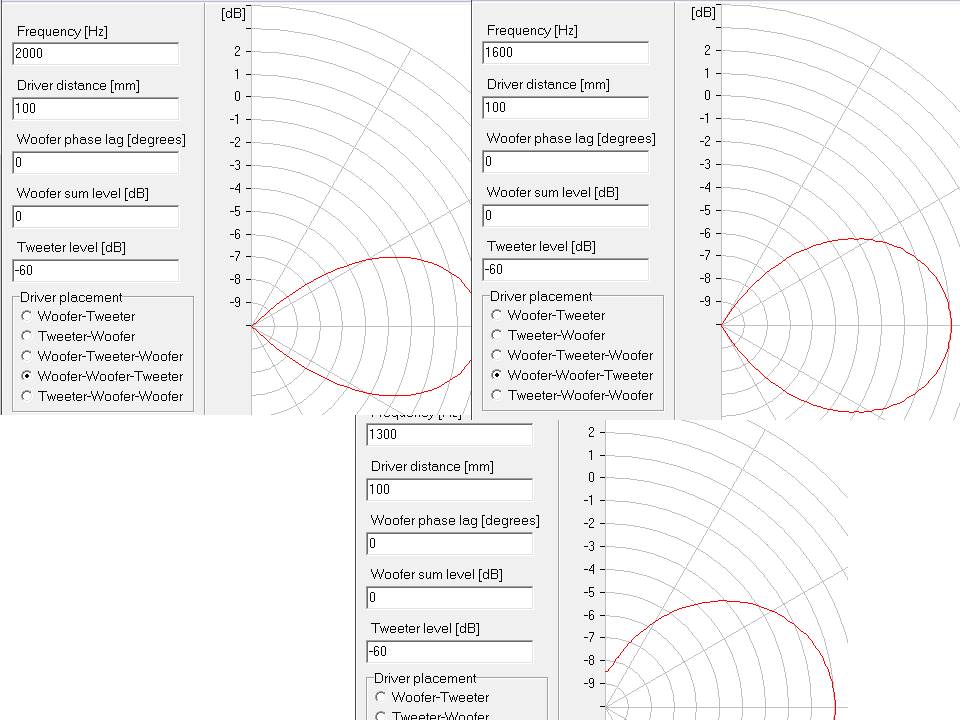

Thanks for telling me how to read it. A new run, now at 100mm woofer c-t-c (4FE35 edge to edge).
At 2kHz the -6dB is about 70 degrees. Maybe a bit more. Probably close enough to the TPL horn 80 degree.
Lowering XO to 1.6kHz would be on the safe side in terms of horizontal dispersion match to the horn. By 1.8kHz it's somewhere 80 to 90 degree at -6dB.
So going down this path I envision an MTWW, with the TPL using the horn and where the M represents and array of 2-wide by 3 or 4-high 4FE35. Not saying I'm sold on this design, but horizontal dispersion control would be the benefit of an array of 2-wide.
What are the downsides of this path?

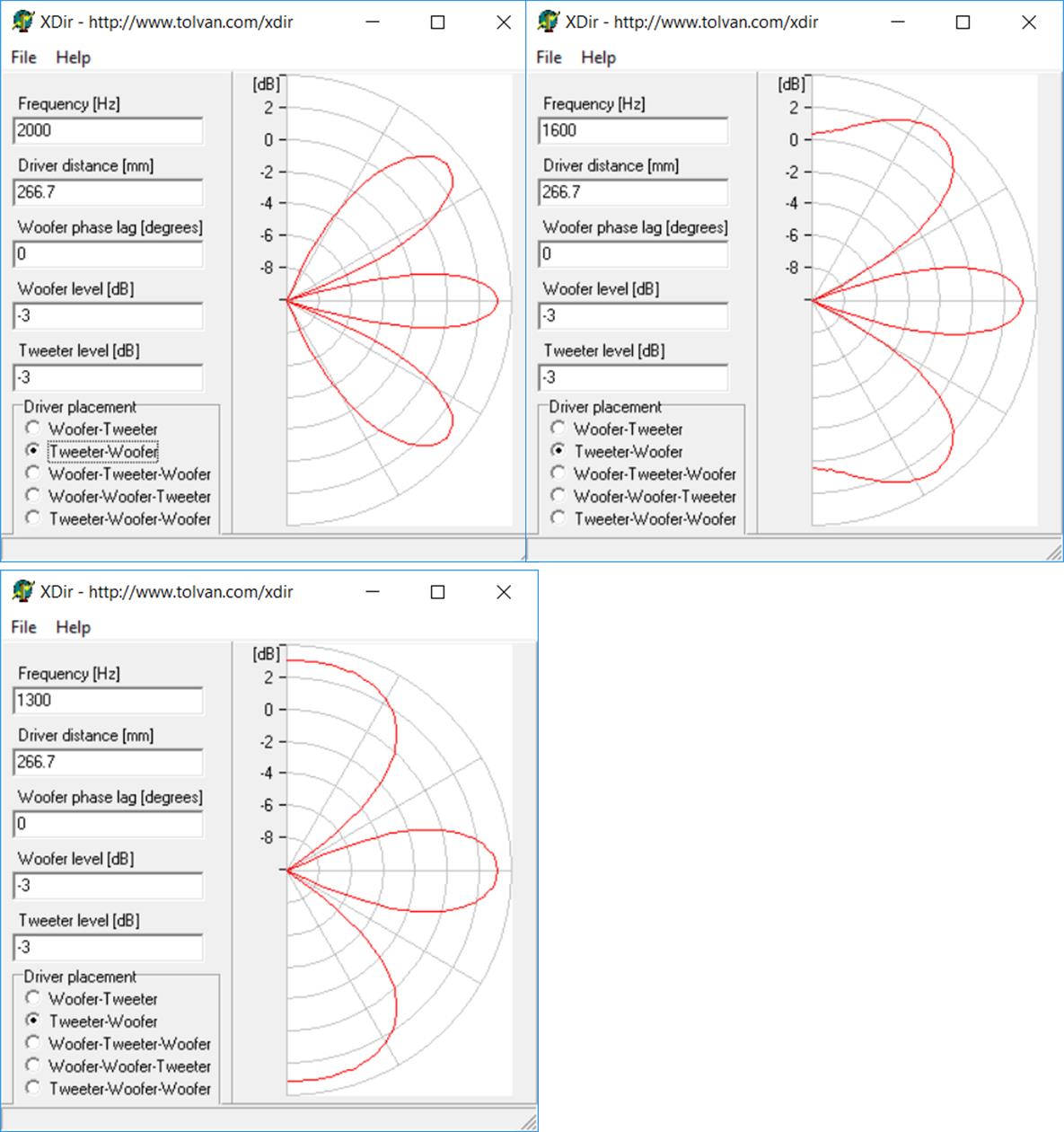

The vertical center to center distance from the 3 or 4 high array of side by side 4FE35's is measured from the vertical midpoint of that array so its going to be greater than for 8" mids, if, as you implied, the array of mids is above the T. This will give you pretty severe lobing, as shown below for 3x2 MT.
attachment.php
These lobes are at angles where they can reflect down to the LP and perturb the frequency and phase response, perhaps even causing nulls. But if you have floor and ceiling treatment you may be able to ignore them.
You would get less lobing using MTMWW or WMTMW with the 8PE21's as M. The center to center distance with this is less than the tall array of 4FE35's and should also have a good horizontal directivity match. You should use steep XO filters to minimize lobing effects and as low an XO frequency as you can get without hearing strain on the T.

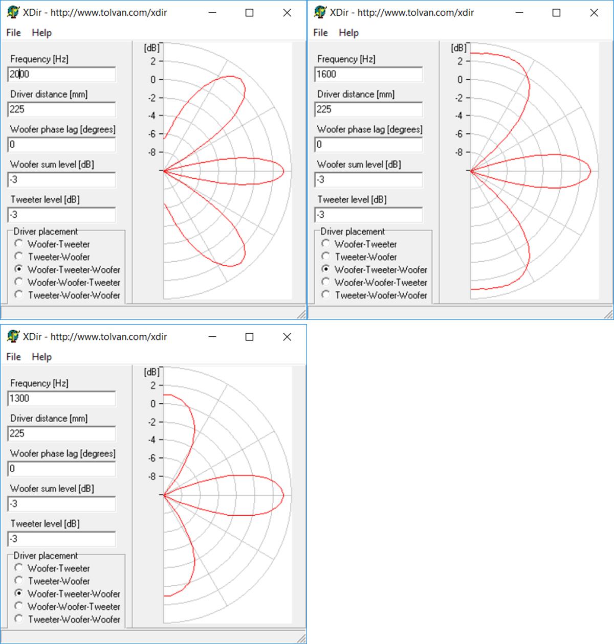

Here is the XDIR vertical directivity for MTM with 8" mids at 2000, 1600, and 1300 Hz XO.
attachment.php
The MTM with 8" drivers is only marginally better until we get down to the 1300 Hz crossover. There the lobes are narrower and point more directly at floor and ceiling where it will be easier to absorb them or keep them away from our ears.
