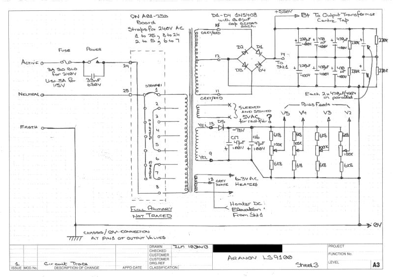

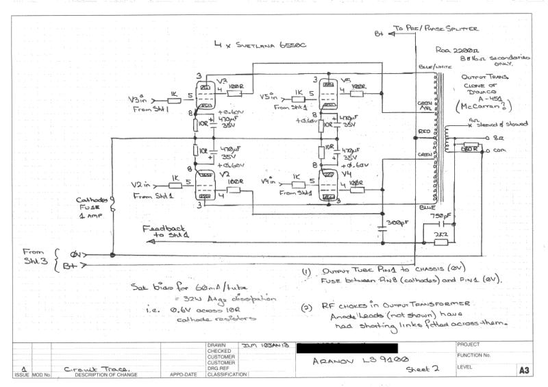

OK I promised the LS9100 schematic trace - here it is, I delayed posting until I had one monoblock fired up so that I could put typical voltages on it.
Ian
Ian

More info. The unit I traced above has been modified.
Mod #1 - Power Supply beefed up considerably, of all the electrolytic capacitors shown hanging off the rectifier, ONLY C8 to C15 shown on sheet 1 are original. All those "extras" shown on Sheet 3 have been added.
Mod #2 - The single output tube bias control has been replace with individual controls for each tube. Original looked like the Dynaco 120W circuit from here:
http://www.the-planet.org/dynaco/Misc/Transformers.pdf
This mod is poorly done in that the 100K adjustment pots are too high a value and very fiddly to try to adjust. 20K pots with the bottom fixed resistors adjusted accordingly (to say 82K) would be much better.
On ething which "pushed one of my buttons" was that the amp which had blown up had a 2.5 Amp fuse fitted in place of the normal 1 Amp which shows that the last guy to work on them was seriously "dodgy". He then had the cheek to put "Professionally Serviced by ***** " stickers on the rear panels. That is not what I wouild call professional.
Ian

Well they are finally both back together. New set of Output tubes for the blown up unit. Due to the grid leak resistor values (270K) I biased them very conservatively at 60mA idle each tube.
Both 6AN8A had weak triode sections (the concertina phase splitter) so put new RCA 6AN8A in both monoblocks.
Ran them for 2 hours on my system for a final confidence test.
