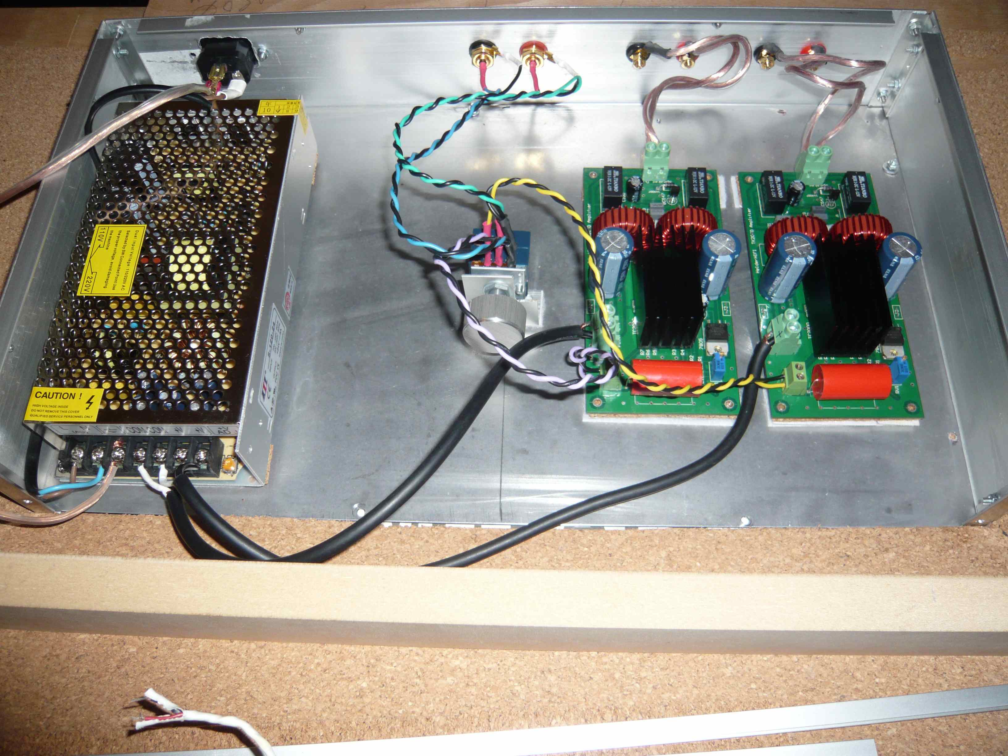

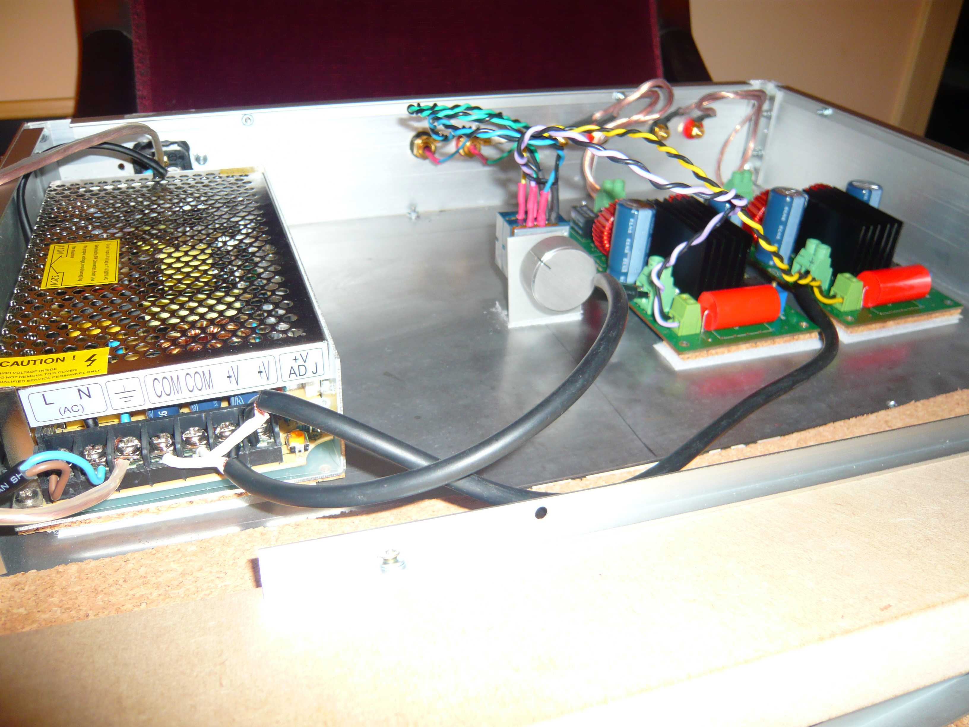

Here is picture from the amp with chassis. Just for testing. Connections supposed to be OK. Arjen has seen this picture also.
Still the amp turns on, or at least it makes the noise from the reles (like a quick double click) But no sound at all. Tested with my new fostex speakers also, and no sign. I've tried with out volume pot, strait connection from boards to RCA's, but nothing either.

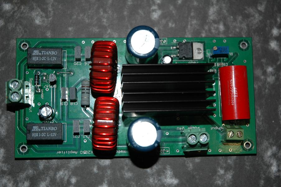

I can tell that the "flat resistor" (on the right of PCB, between "little blue box, Heatsink and big cap) is really hot after a few minutes. Well, it gets hot early. Don't know if this means anything to you.
SMPS measures OK, it's set to 24V. I've tested with multimeter as recomended in previous thread.

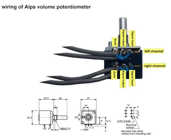

Juanito, can you post some closer pics? Would like to look at your volume pot wiring.
Also, set your new multimeter to VDC and with the amp on, place your probes on the two screws of the power connector on each board and let me know what you read. Just want to make sure you are not set to read AC on the multimeter.
If you are feeding the boards too much power (over voltage situation), the relays will click but there will be no sound coming at all.

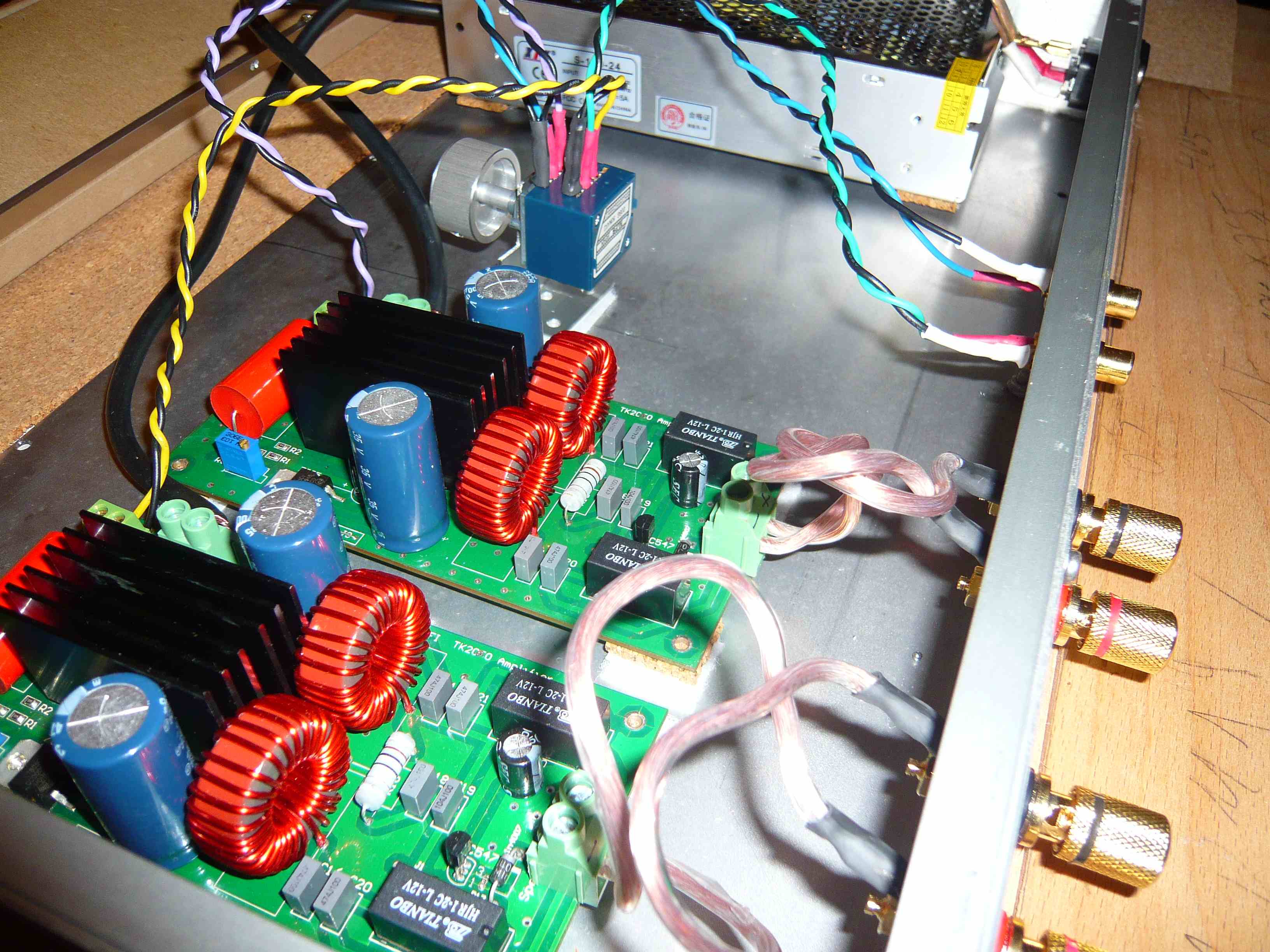

Here are the pictures, hope that you can see them well.
I tried the amp with out "chassis". So I hooked the loudspeaker cables strait to boards, and also I screwed spare RCA's out of the chassis, so there is no connection between them at all. RCA's are hanging out and PCB as well. Everything on top of a flat wood. Result: now one PCB makes a little pop to the speaker, but no sound at all. It moves the speaker out a little bit and it stays there, but noting else.

Set your voltmeter to the 0-2 DC volt range, put the probes where the speakers would be, turn it on and see where this voltage goes. If this (DC offset) is too far off, it may keep the amp chip from coming on (not sure, been a bit since I read the datasheet). Anyways, the idea is to set this as close to 0 DC volts as possible using a small screwdriver and turning the little brass screw on the blue pot near the corner of the board. You will see the voltage move with the screw, at least when things are working that is.
