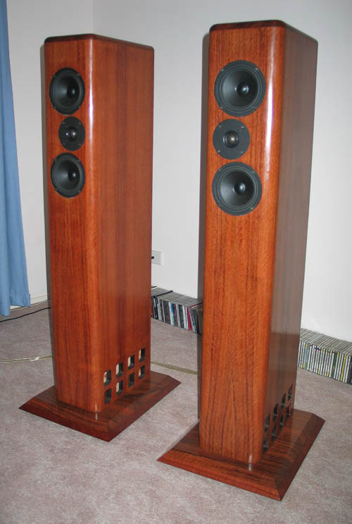

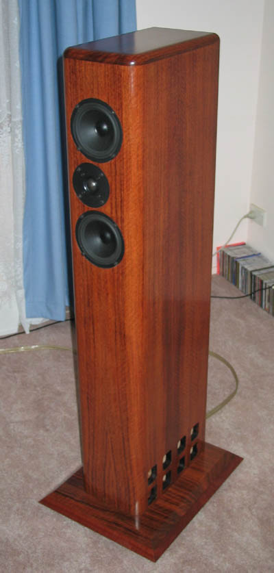

Well, it has taken more time than I had imagined… Just after the last post I made, I was informed by my landlord that he was selling the house I was living in and that I would have to move! Took me a couple of months to get my workshop set up again, but the good news is that I have finally finished my speakers. I have finished them as I had stated in my previous posts, but put on a final coat of wax finish. I am happy with the results.
As for final impressions? The plans called for a solid MDF top. I figured that since I was going to veneer the speakers, trying to veneer the top would be difficult due to having curved faces joining the top, the sides and the front. I thought the easy solution would be a solid wood top. As the top portions of the enclosure were separated from the transmission lines, I theorised it would make little difference acoustically. When I glued the ¼ inch ply to the top it sounded like a drum when you tapped it! I thought that gluing ¾ inch solid hardwood to it should quiet it down. I was wrong. When the speakers were finished I noticed that when playing music, the top of the cabinets were not acoustically dead. Hmmm, what to do? As I had made a removable back section for the crossover components (not sure if this contributed to the problem), I figured I might try to fill the compartments with dry sand. Well, this did the trick! To fill the compartments took about 6kg of sand for each speaker. The result is a much clearer/cleaner sound. Final listening impressions? I am very happy with the final result. Since adding the speaker base and filling the upper compartments with sand the speakers are very well behaved. Some have noticed a lack of base with these speakers. There definitely is not the same amount of base as the speakers they are replacing (Bose 901), but the base is much more well behaved. I do not feel that there is anything “lacking” when listening to music. I do intend, however, to build the matching stereo sub woofers described by Lynn Olson (for movies, and for the fun of building them). Hope that this thread has been of some interest or help to those considering this project.

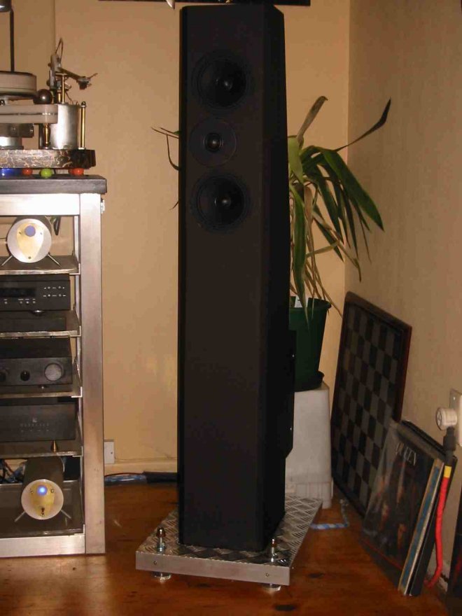

Someone just pointed me to your thread because of you excellent woodwork, beautiful job! Anyway, had a thought regarding the lighter bass you are getting. Try spikes, get some longer steel spikes (parsexpress.com, etc.) and be sure they penetrate your carpet down to the wood. This will make a big difference in the sound your getting. If you've already done this, ignore this post. Just thought I'd throw this out there.

One1speed, thank you for your tip, but yes I do already have spikes. I have tested the response with a tone generator that goes down to about 50hz and the speakers dont appear to have any problem going that low. I am in the process of building a four channel gainclone amp with an active crossover at 80hz to feed stereo sub woofers. Unfortunately the sub project will probably take a few months as the project requires four Scan-Speak 25W/8565-1 drivers, and these are around $320 each here in Australia.
