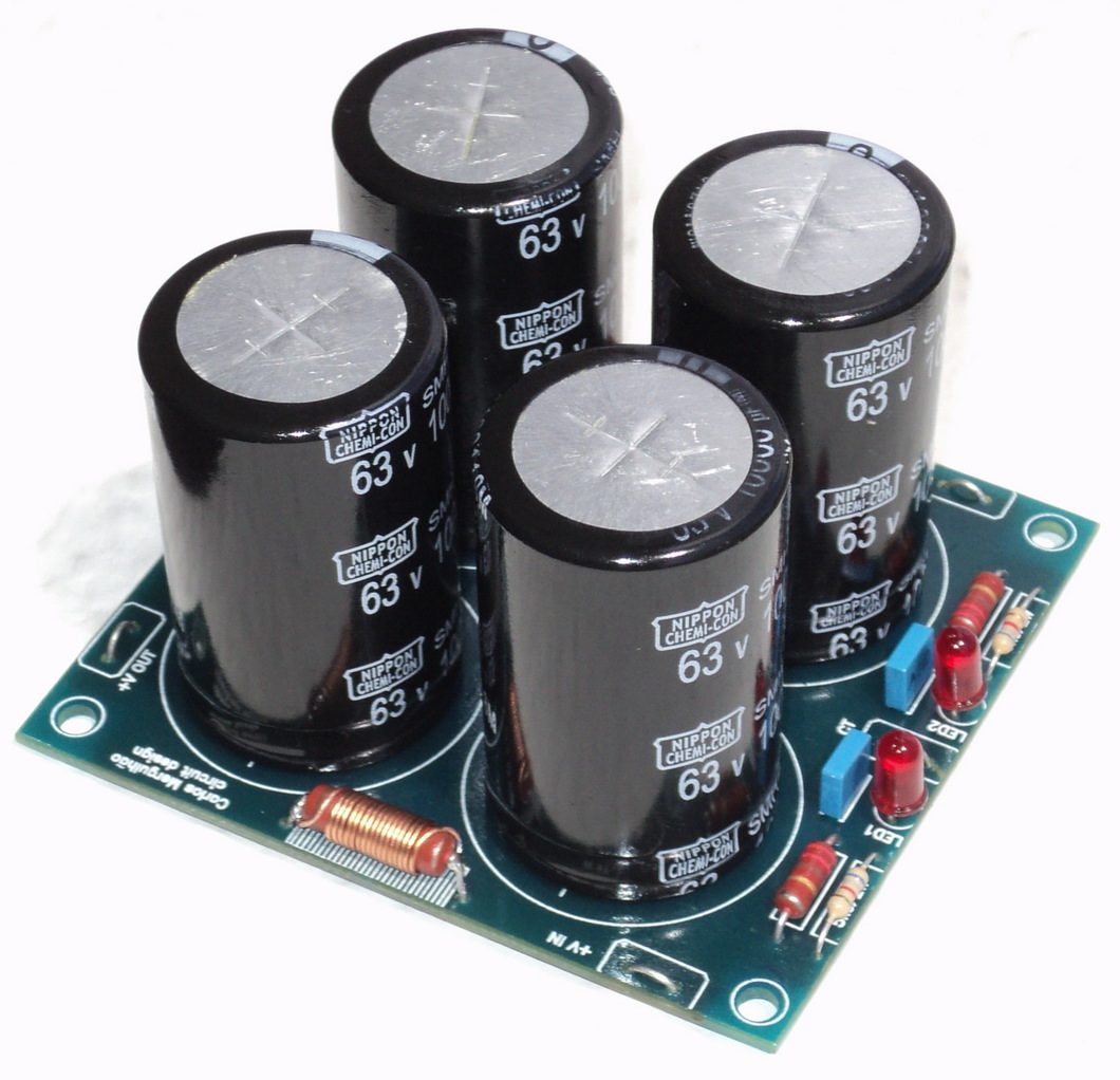

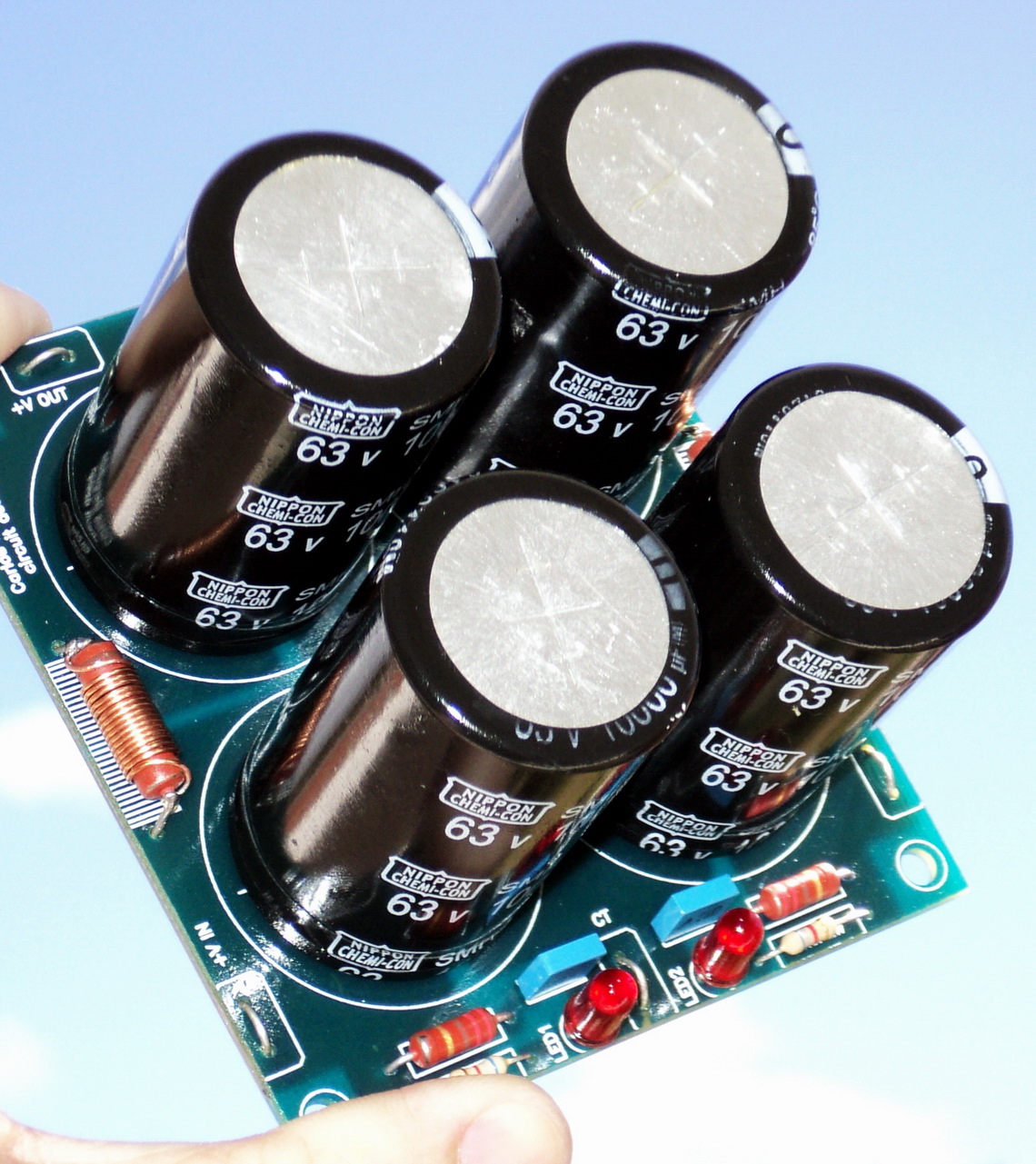

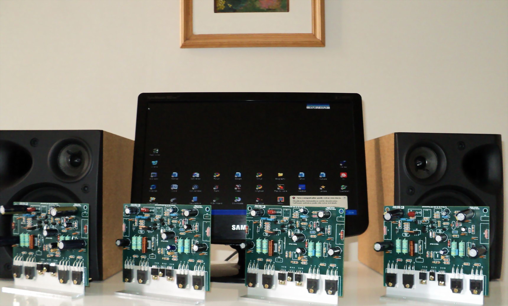

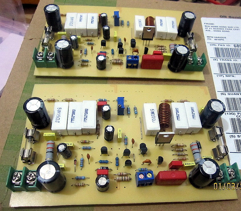

I am building the Supercharged.... doing it slowly as i have
...ordered some misd 1N4148 and i am waiting them arrive:
YouTube - Building the Supercharged - on the go
regards
Carlos

Output coil..... i have made tests with a different output coil and resulted good
Internal diameter - 5 milimeters
External diameter - 7 milimeters
Wire diameter - 1 milimeter
Coil length - 17 milimeters
Number of turns - 15 plus half and plus half...this represents 16 turns
Inductance - aproximatelly 0.692 microhenries (692 nanohenries)
Resistance in paralel was increased to 15 ohms, 18 ohms or 20 ohms / 5 watts... can be a coiled wire resistance.
During tests i have used the coiled wire resistance of 18 ohms and 5 watts...some inductance is provided by the resistance windings.
Blue boards have holes into the coil position, that accept 1 milimeter coil wire without problems.

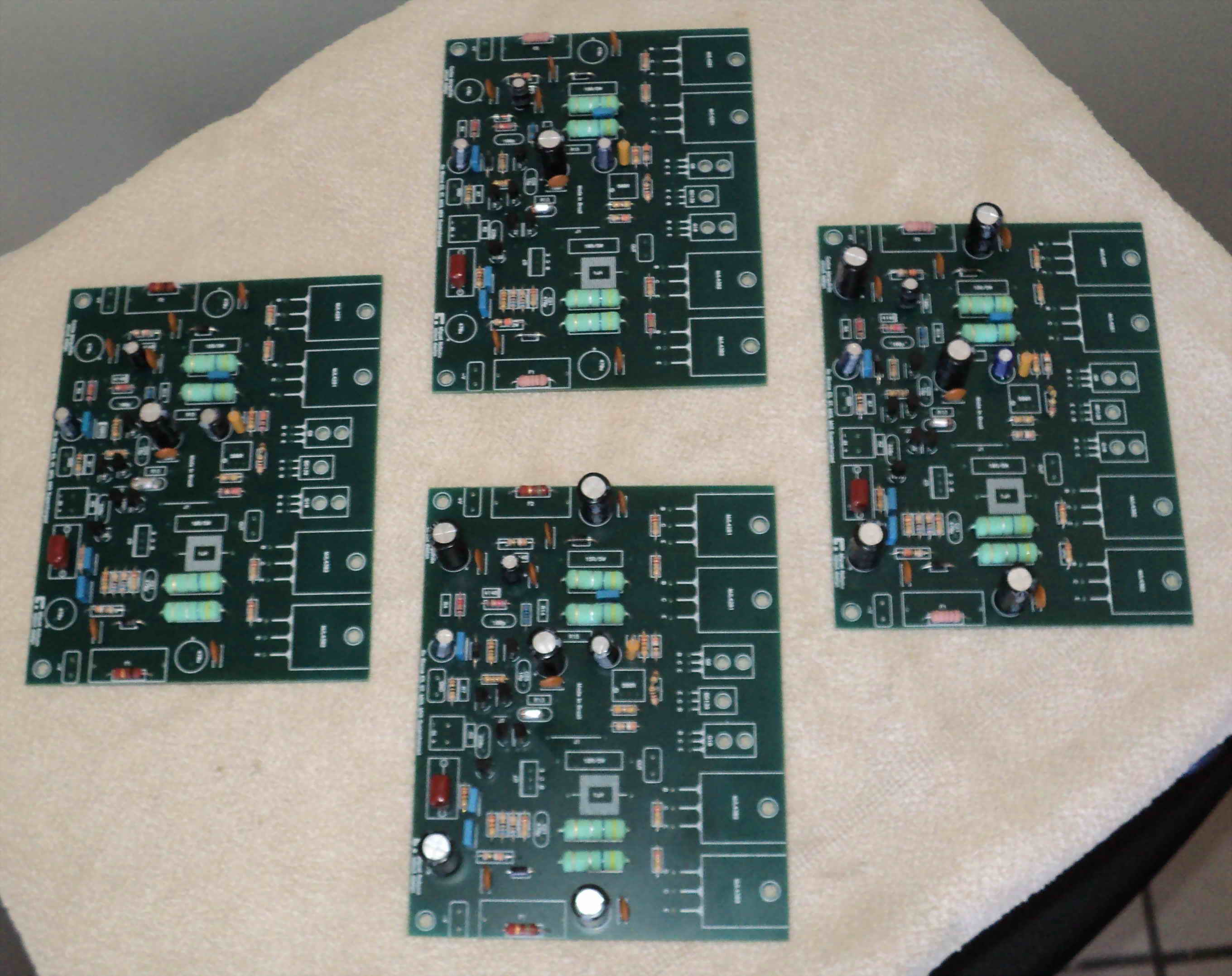

Joined 2009

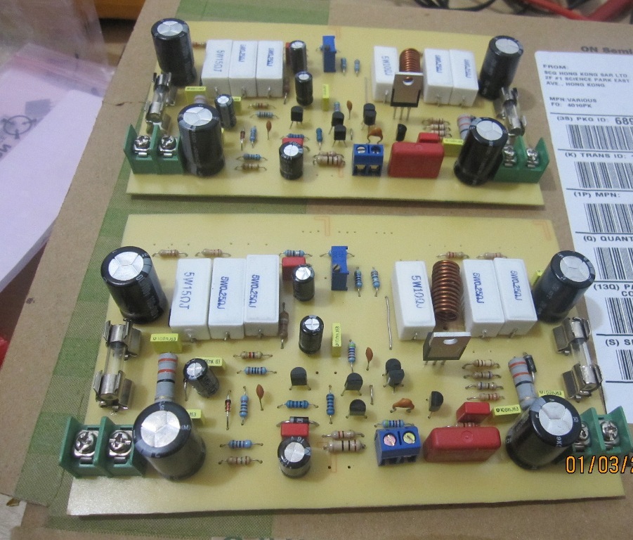

I am waiting some parts boys.... some parts installed will be substituted
by others...more watts in some resistances.... and other details...insulators was missed too... bias trimpot and other things.
I have just made the metal work (boring)
regards,
Carlos
regards,
Carlos

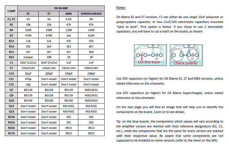

There's an error into the Supercharged bias circuit
R20 should be increased... watch here:
http://www.diyaudio.com/forums/grou...harged-groub-buy-interest-10.html#post2423837
I am sorry...my mistake.
Carlos
