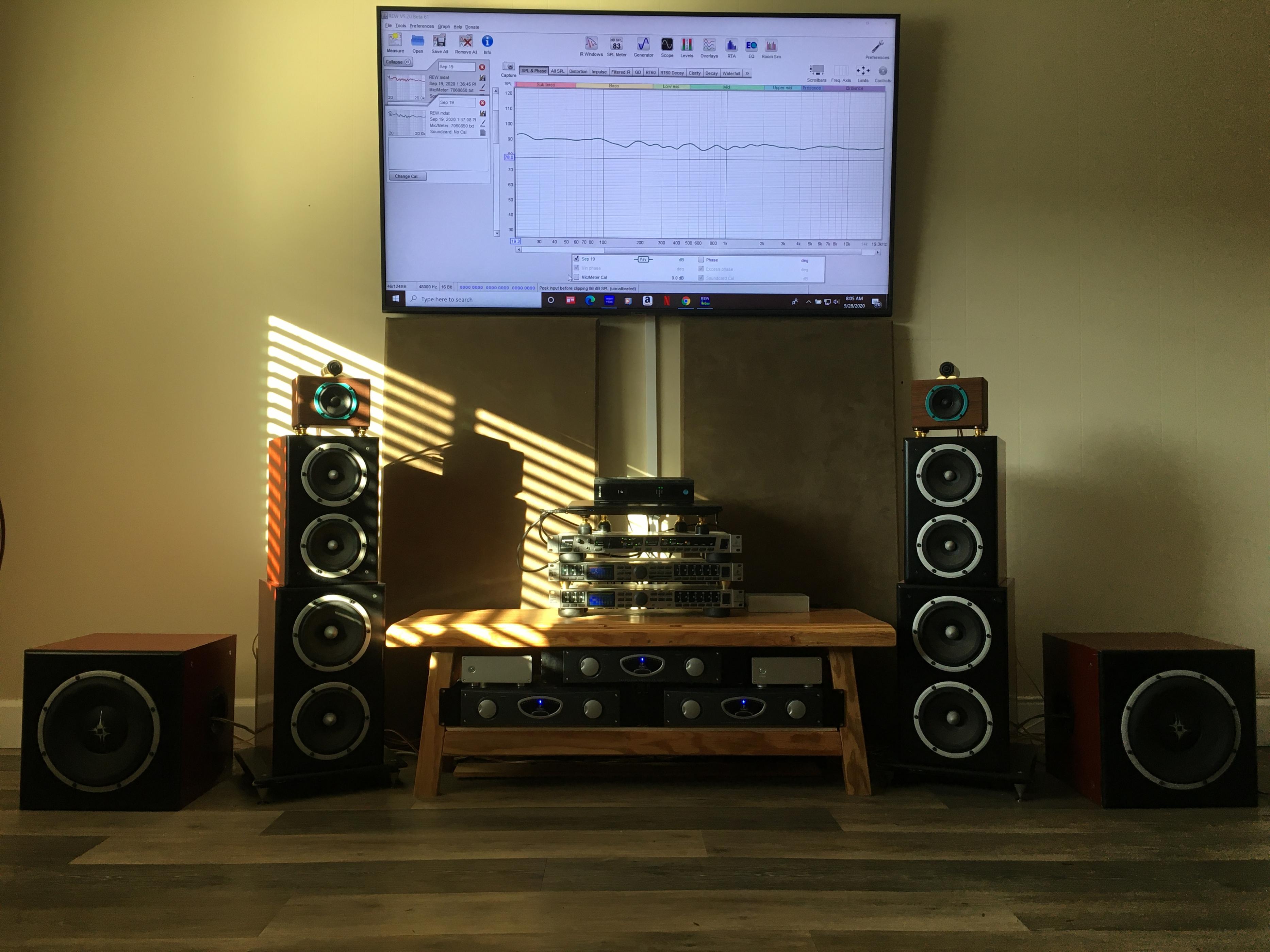

Four way, 100h, 400h, 3kh. LR48
Streaming only system, 24/96 from computer to amps. Icepower class D on mids and tweets. TV monitor shows system response at listening seat

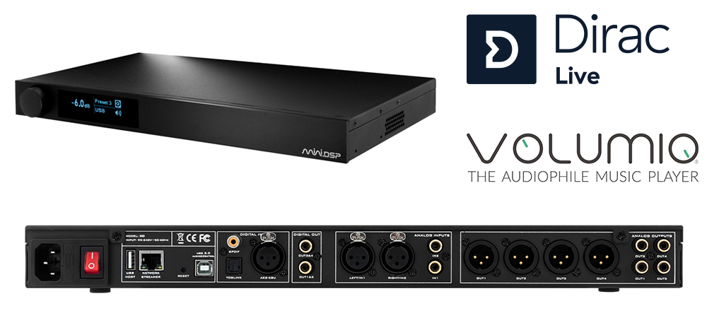

This is the only MiniDSP product I'd consider buying:

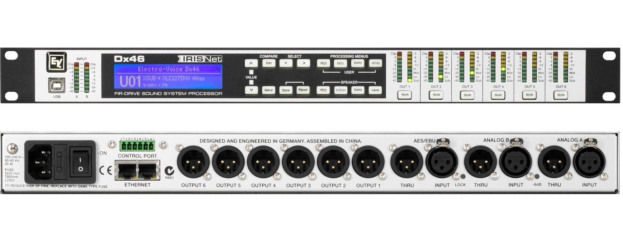

Especially in the US, one of these oldies can be bought second hand for a couple of hundred bucks.

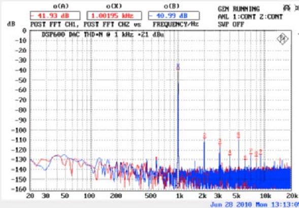

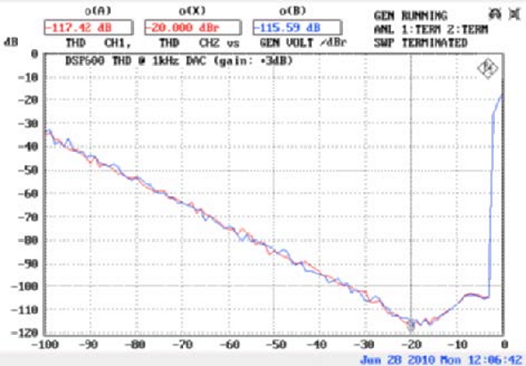

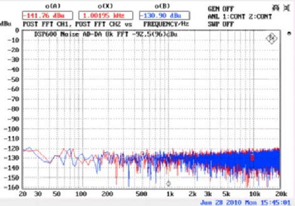

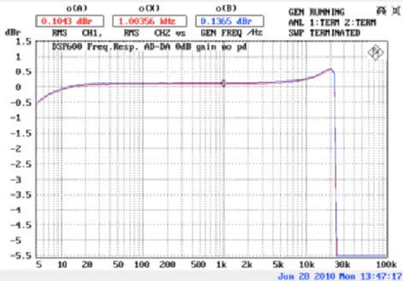

These are OK wrt measured performance and sound quality:
THD+N at 1 kHz from digital in to analog out with 0dB gain and +21dBu output_DSP600.jpg168.9 KB · Views: 125
