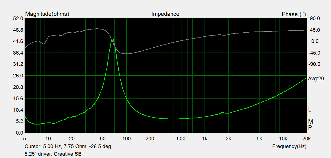

Yes, the bottom end below 40Hz is of little interest in most measurements but it was preventing me from calculating the T/S parameters. Now, that's a bit of a show-stopper for speaker design, isn't it? [emoji2]

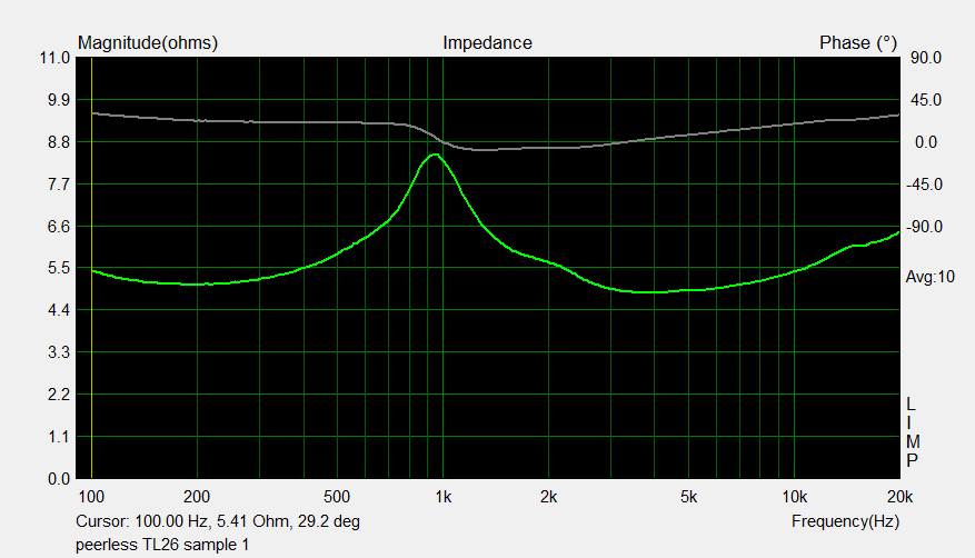

Not correct. You can only depend on some manufacturers to publish accurate figures, and maintain manufacturing QC tight enough to retain consistency of parameters over the years. The woofer I'm working with is quite the opposite. I took up a project to design a couple of inexpensive speakers with Indian drivers, and those drivers don't have trustworthy published data. In fact, I bought a tweeter from the same manufacturer with published Fs of 596Hz, and I'm getting measured Fs clearly around 1KHz. Read all about the whole scoop here. I'd measure every Tang Band or HiVi driver I use, if I ever use them.You can measure stuff yourself, or just go to the published speaker specs. I'd generally expect the manufacturer to know more than you do about Thiele-Small bass performance.

No, it's about 55Hz. (A few posts back, I'd posted graphs of two drivers, a 5.25" with an Fs of about 63Hz, and a 6.5" with an Fs of about 55Hz. Please ignore the 5.25" graph.) I agree that 39Hz would have been nicer, though.It seems to have a fairly high basic Fs resonance. Around 70Hz.
