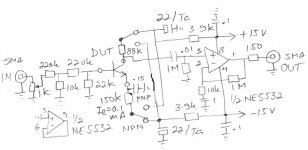

However I wanted to comment on the test circuit from Regenpack. If I read well the source resistance at the base of the transistor is in the order of 20 Kohm, so at 100uA bias you will mostly be measuring the resistor noise, not the transistor contribution (unless you have a very lousy transistor with poor gain and terrible flicker noise, which can happen)
Low noise transistors are characterized by having a very low value of base spreading resistance (rbb). For a "good" 2SC2440 it should be somewhere between 30 and 50 ohm, which helps keeping noise down with very low source impedances (e.g. MC cartridges, microphones etc) at sufficiently high bias currents (say 1 to 4mA, where collector shot noise is no longer dominant). Now if you measure noise with a 20k ohm source impedance at 100uA bias you will never be able to find out if the transistor clone is really low noise or not.
But if your application indeed foresees such conditions, then your best bet would be a high gain low current device like 2N5088 or BC550C. Such transistors have rbb in the 500ohm - 1kohm range (i.e. they are not properly "low noise" devices) but if your source impedance is 20k then it doesn't matter. Just check that flicker noise corner is low enough to not degrade the source noise further at the bottom of the spectrum

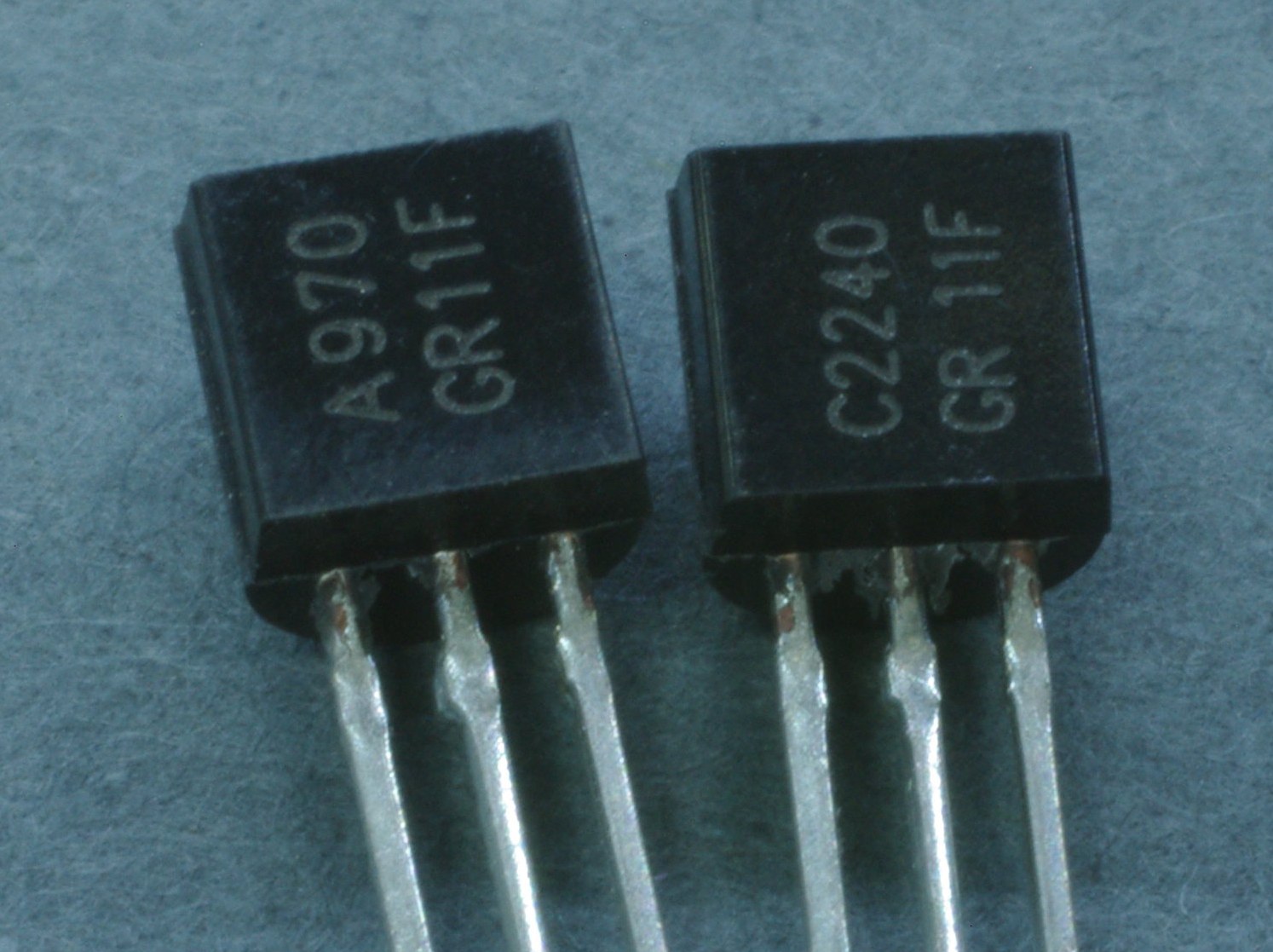

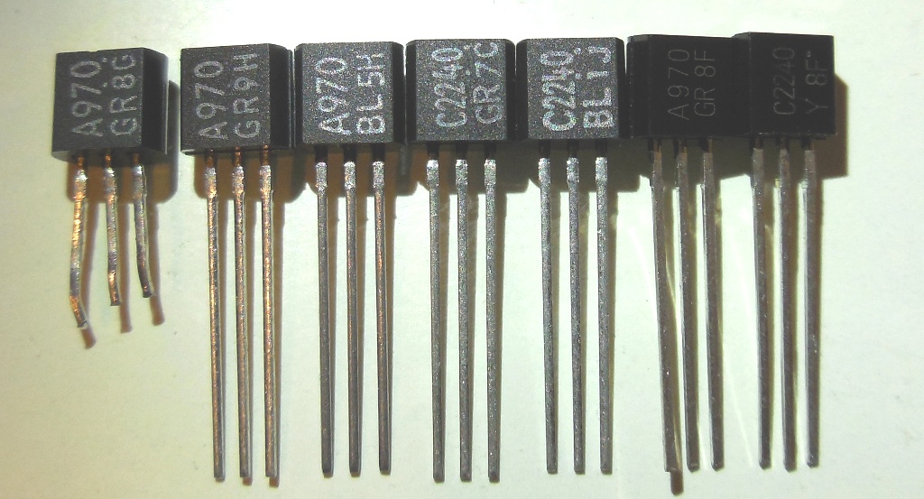

2sa970 and 2sc2240 are Japanese Toshiba devices. There are no Chinese types. Everything that's not Toshiba is fake, and therefore could be anything - there's no way to know. Only one thing is certain: it is junk.
Right on the nail. That`s what I have been trying to say many times to no avail.
