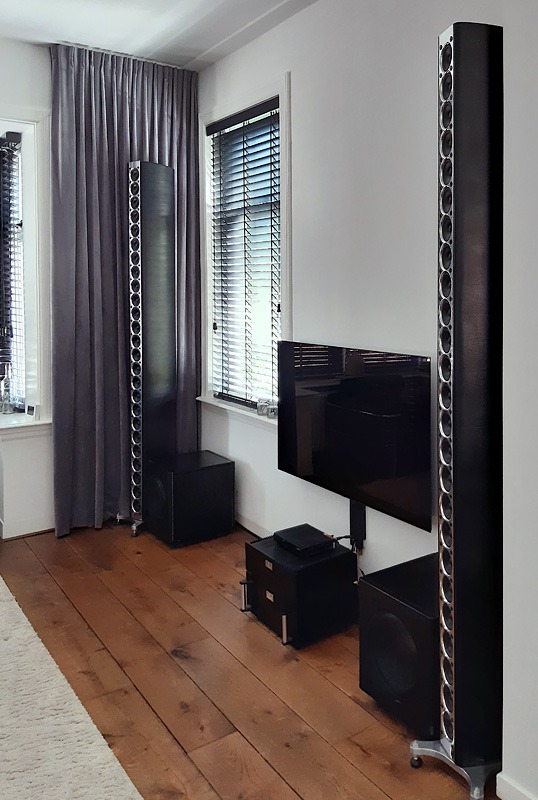

C. simple fullrange-driver speaker of comparable cost to B
D. high-end fullrange driver in competent cabinet

but im building a speaker using 12" + 4" wideband, xo around 300hz. I expect this system would make a few 3 way run for cover
I have one of those but twin 6.5” drivers. Makes most 3 ways duck.
