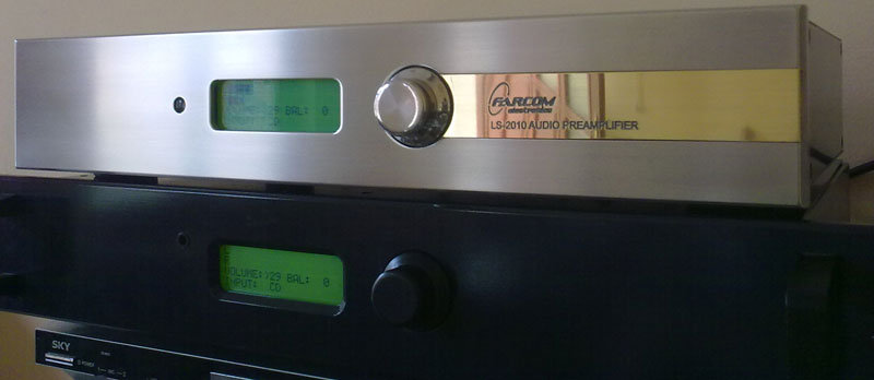

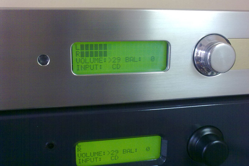

Hello everyone, and - thank you for this gorgeous project!
Couple of years ago, my (ex) colleagues and I did something similar to this, but it was PIC based, and LDRs had to be paired. That project was actually never 100% finished, had some bugs regarding remote control etc, and was eventually put to sleep. In the images attached you con see how it looked, back in time.
I always wanted to build one for myself (it was meant to be a commercial product, those ones we've built were sold), and just when I thought it was time to have this project awaken, I saw this thread, and now I'm completely hooked to build this version of preamp and forget about PIC, since this is the right way to do it
I'm not the programmer, though; I can see what's happening in the code, but I cannot write it on my own. So, I'll be learning along the way, and I have some questions, so be kind:
1. I have some fancy 4x20 LCD with white letters/black background, but it's not I2C, so I was wondering can it be used with your code as-is, I saw that there are some adapters for Arduino (PCF8574)?
2. Neb Zdr, many thanks for your contribution, I like your OLED version very much, did you think of implementing a VU meter, since it looks like there would be enough space on display for this feature?

Thanks! I2C is a must due to limited number of GPIO pins. I2C bus is used to control both port expander and display. You could add another Arduino on I2C bus just to control display, but that would be an overkill if you just want to reuse your old stuff. These big OLEDs are 20eur, so not worth it IMHO.
I am not too excited to have VU meter in there, so it won't be coming from me. Foobar is doing that already
Pozdrav.
Of course, I know all this.
Perhaps you misunderstood my question a bit, let me rephrase - could I use hd47780 display IF I put the I2C adapter chip (like this ) and use your code as-is, without changes? I have noticed that most of the 4x20 displays you search on AliExpress, for example, actually use exactly this board, so I thought - if they work, why wouldn't this...
And, this is just because I already have some displays I'd like to use.
I guess that my final version will be with OLED, but I wouldn't want it less than 2.42"
I guess that should work, i2c adapters are cheap.Of course, I know all this.
