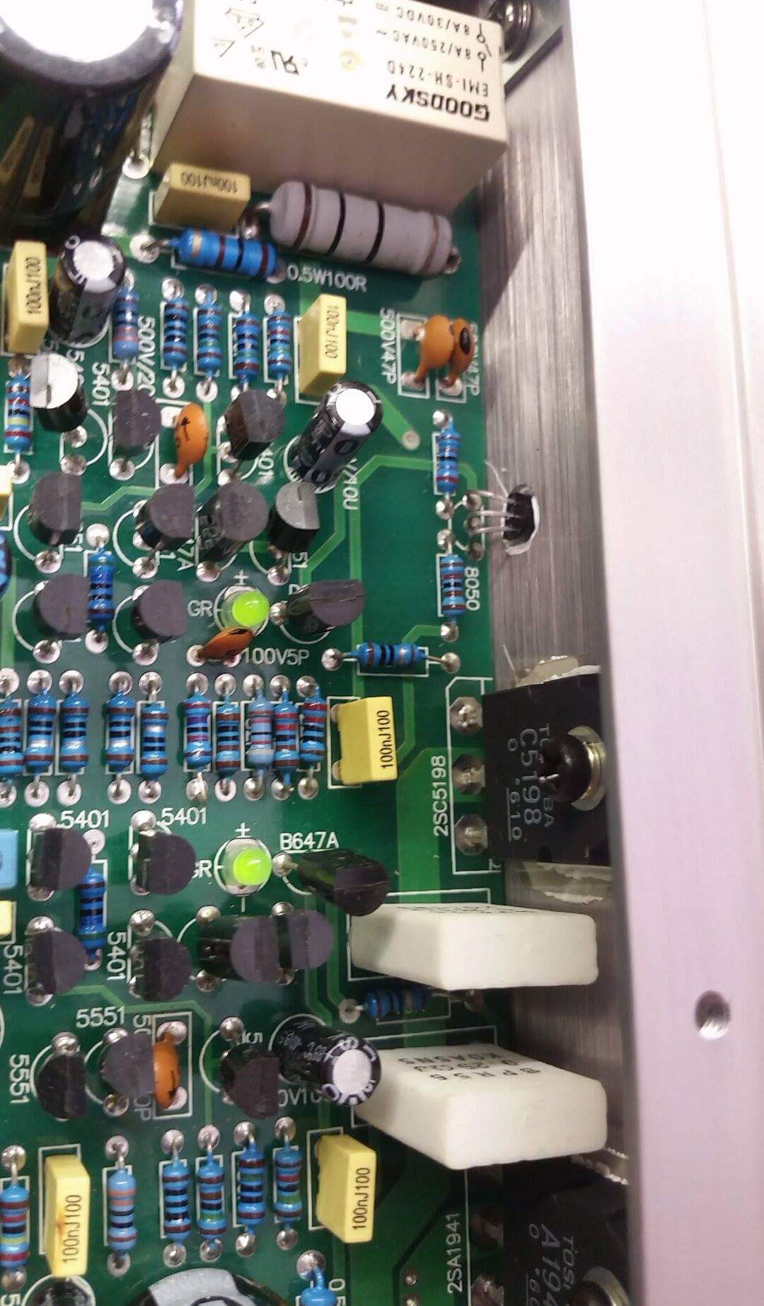

Then i noticed that it did not get warm at all.
So I opened it up and confirmed bias to be 0. Class B

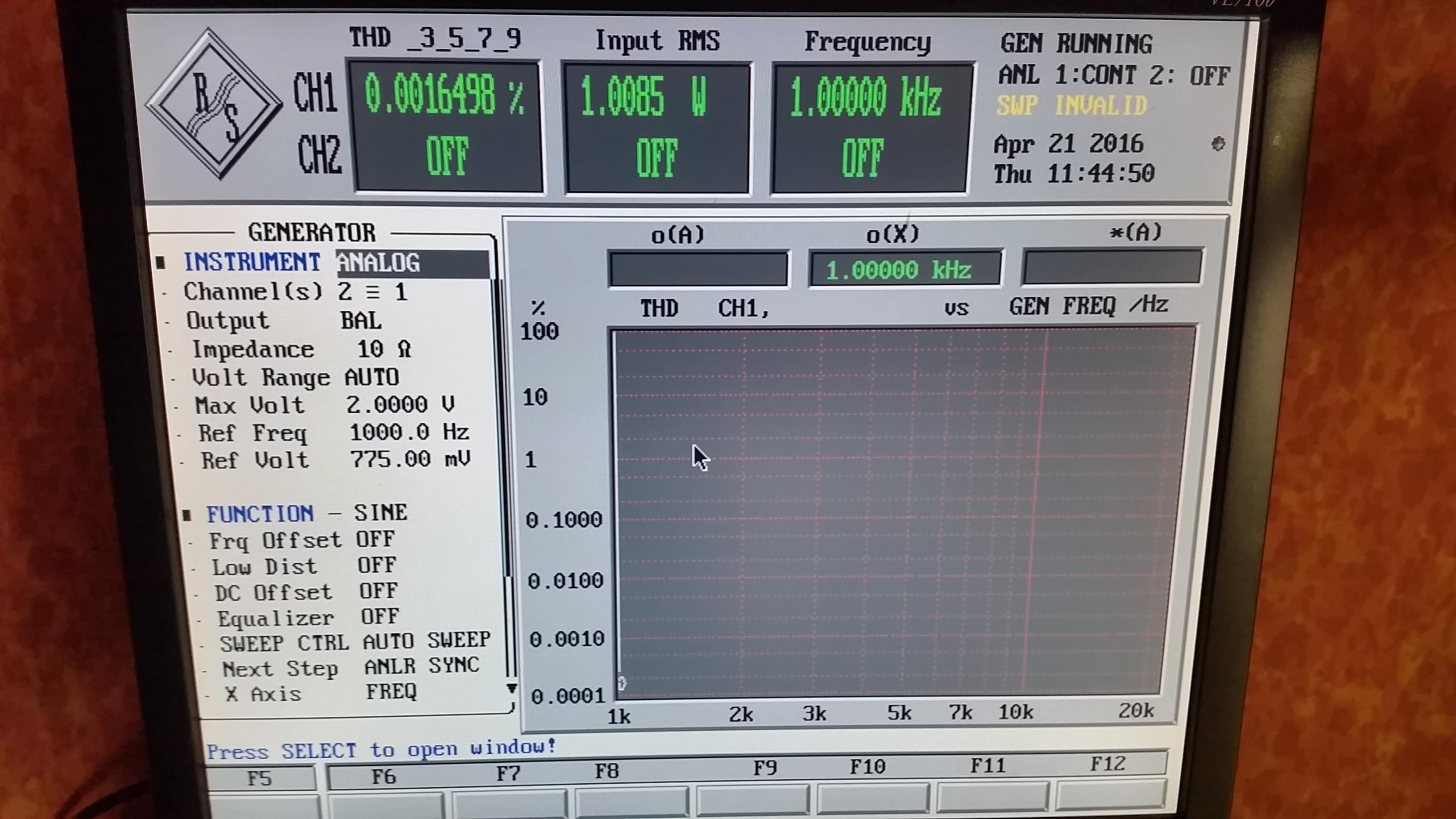

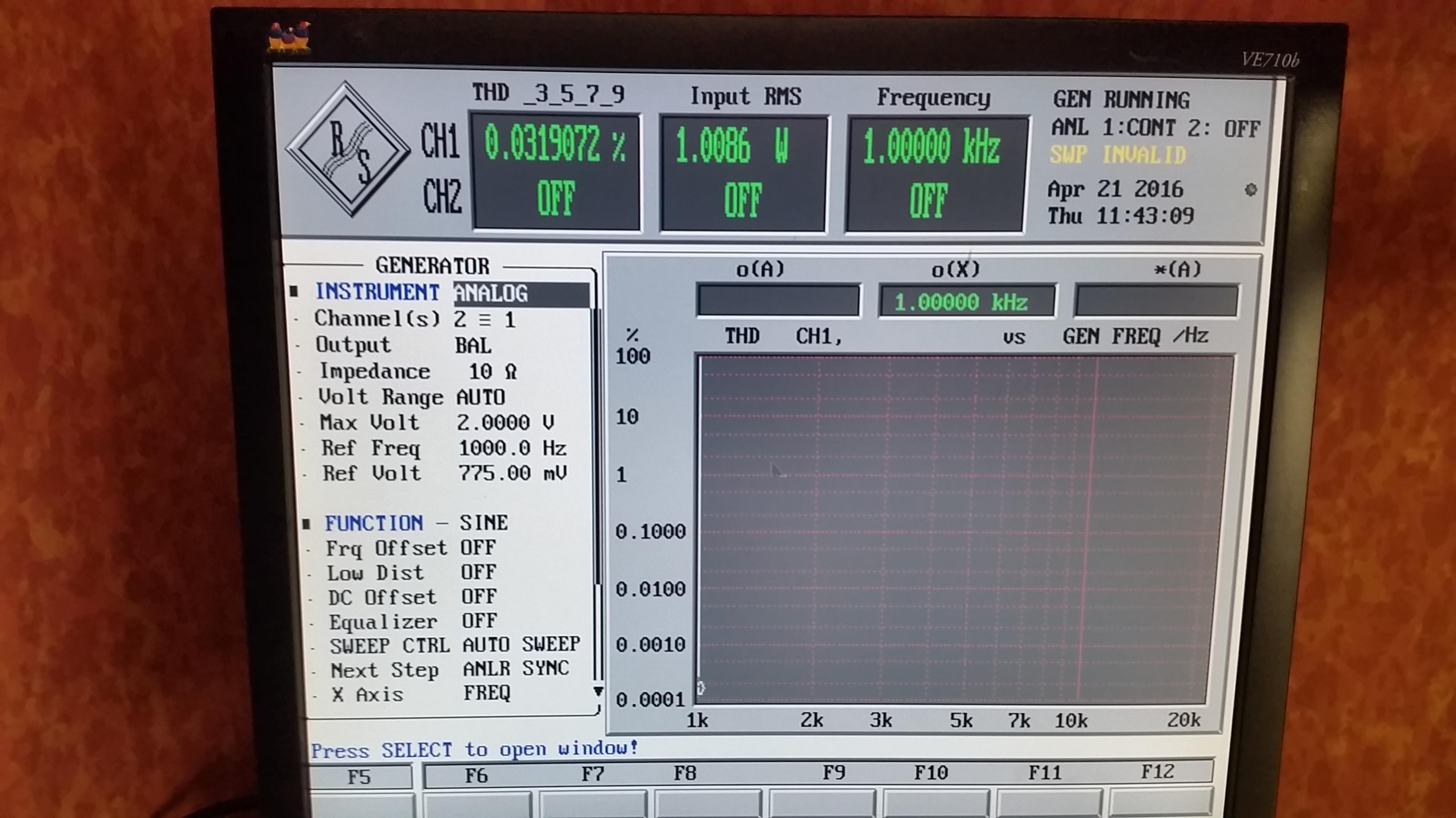

Also distortion was several hundredths of a percent (odd harmonics measured) and I believe spec is 0.002%

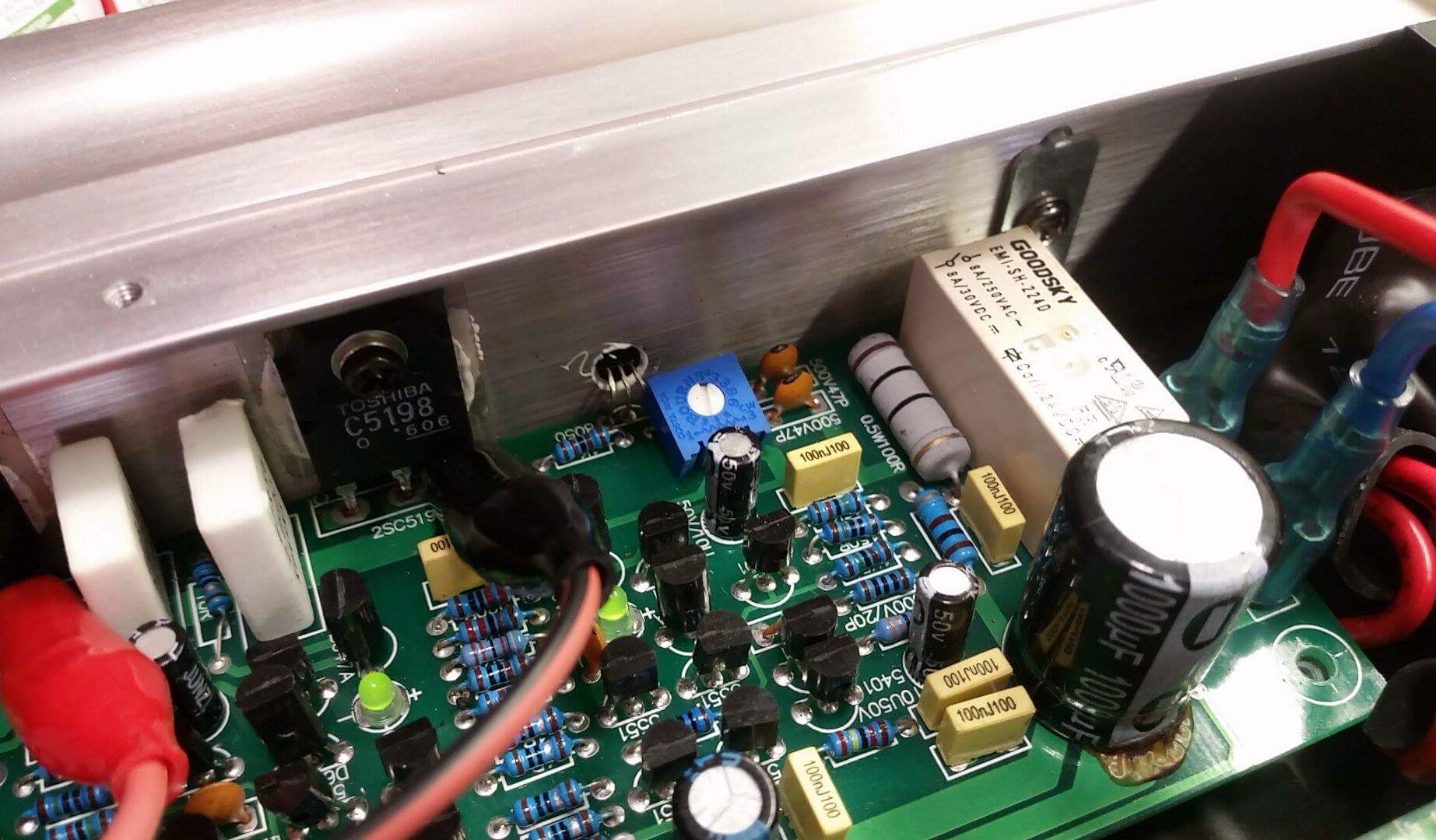

I changed the 2.7k resistor next to the bias compensation transistor for a 10k pot and at slightly above 5kohm I had 18mA of bias and good distortion values. I then changed the pot back to a fixed resistor to increase reliability.
I did not yet listen to it. Now it warms up slightly. Bias is very stable. I have loaded amp for hours with 1W, it heats up but bias does not increase.

Photos show left channel with trimmer and right channel with original resistor.
Measurement results speak for them selves.
