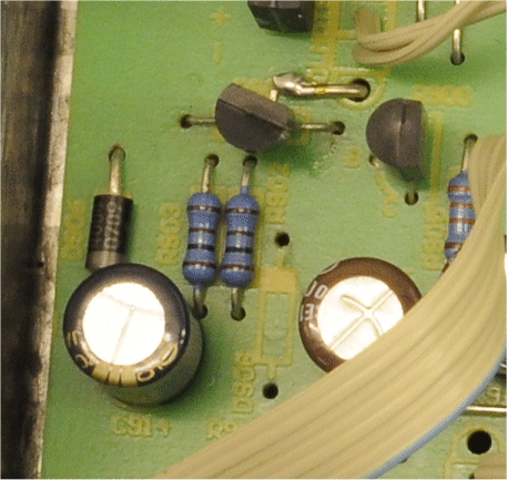

I thought it would be worth closing out this thread for the benefit of anyone else who experiences a similar problem. The fault in the end was the microcontroller (Z900).
Having disconnected the 9V AC winding from the transformer (at the socket on the left hand side of the pcb) and replaced it with a bench supply I found that the microcontroller circuit appeared to work. Back to the AC supply and the led flashed/output relay chattered again. The difference between the two - the level of ripple. The AC is half wave rectified by D906 and filtered through C914, this is followed by paralleled R902/R903 (to share the current and avoid overheating). These resistors supply a zener configured as a simple shunt and finally an RC formed by R904/C915. Although the schematic shows the zener as 5.1V, a 5.7V had actually been fitted to the amp. There is only around 20mA drawn from the +5V supply so if you discount the charging current for C915, R904 (10R) only drops 0.2 volts. The microcontroller is specified for a 2.2-5.5V supply (although nominally 3.3 or 5V). With less current drawn the voltage will be even higher than 5.5V. I am not sure why Arcam decided to change this zener and run the microcontroller at the absolute upper limit of its working range (in fact overvoltage when you factor the supply ripple and varying current demands of the circuit). This just seems like a poor design choice imho. I can only assume this has something to do with the PROT signal from Z101 (TA7317P). The microcontroller datasheet specifies a 'low' input below 0.3 times the supply. The TA7317P datasheet states that the output ON level is typically 1V but can be up to 2V. This output is connected to the microcontroller through a 1N4148 diode (D132) so as the output from the protection IC switches ON the input to the microcontroller will track down 0.7v lower - it is 1.4v on my amp. 5x0.3 = 1.5v which doesn't really give any head room for variation in component tolerances. Perhaps there was another reason but a zener shunt with no fixed load to ensure a maximum voltage = bad idea.
Anyway I'd found that when the microcontroller was fed from a 5.5V supply it worked but if this supply was taken below 5.45v it shutdown. What was happening with the AC supply (with the supply ripple) is that the micro was constantly starting up and shutting down, starting up and shutting down which lead to the flashing led and chattering relay. I can only assume that it must have been damaged in some way by the long term over voltage it had been subjected to.
Having replaced the microcontroller with a new one I have also removed R904 and D908 and fitted a 5V regulator (TO92 style 100mA) wired across R904 with the ground wire going down through the adjacent hole and onto the ground plane under the pcb. R903/902 can remain as there is still enough headroom for the regulator to operate even at the minimum AC input and dropping a bit across these resistors means less across the regulator. I've replaced the caps with the same value Panasonic FC. I did consider fitting another 220uF in-place of D908 to form a CRC filter but decided it was unnecessary. The output from the protection IC is now connected to the base of a surface mount PNP mounted under the pcb at the microcontroller which pulls the PROT input down to 0V so no more worries about the 'low' 0.3x threshold. Whilst I was there I also improved the decoupling on the motor controller Z905, decoupling each half of the motor drive circuit to 0V as recommended by the manufacturer's datasheet rather than to each other as Arcam had decided to do.
Even with the AC source the supply is now a much cleaner 5V and everything works again !
Finally I can investigate the effect of varying the bias level on the distortion of the Sanken transistors which was my reason for purchasing the amp in the first place ...
I thought people trying to following what I've done might find this photo useful. D908 and R904 were removed and the 78L05 regulator (TO-92 package) fitted instead, the wire on the centre pin goes through the pcb to the ground plane.
