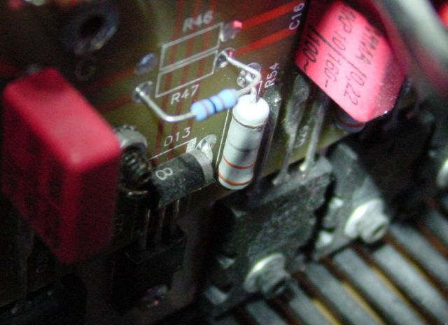

The Re resistors are actually marked as 0.32ohm (orange:red:silver:gold).

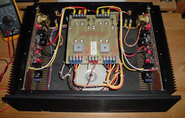

Current draw @ 15mv bias Re:
Left channel, positive rail : 206mA
Left channel, negative rail : 160mA
Right channel, positive rail : 161mA
Right channel, negative rail : 162mA
Voltage offset at speaker outputs: Zero! (both channels)

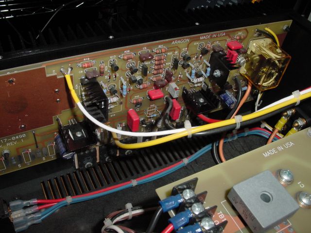

Here's a couple shots just for those curious~...

xformer--->bridges--->big electrolytics--->fuses--->jump point to channel board
There are two medium size 100uf 100v (will confirm) electrolytics on the channel boards. I had thought it might have been one of those. All look perfect. All others are wima film.

Ambient room temp 21c, measuring Re per transistor on left channel:
2sc3281
6) 14.3mv
5) 15.0mv
4) 14.5mv
2sa1302
3) 15.0mv
2) 14.5mv
1) 13.1mv (the leaker I presume??)
Back to the question... Is this worth pulling apart half the amp to replace? Though I'm guessing it could also be the contributor to that intermittent low-output breakup I had noticed. Then it would be worth the effort.

Assuming exactly 0.32 ohm for all emitter resistors, you'd have about 137mA of bias through one side of the output stage and ~133 mA through the other side.
The Re's have a +/- 10% accuracy, which means that two of them can be off by 20%.
The figures actually look very good.
Not surprising, because those Toshiba numbers are known to have a close parameter spread straight from the box.
You could measure the Re value of the 13.1mV device, exchange it for a better suiting one if the bias through that one is too far off.

Can try to test the value of that one Re, however, had been mentioned earlier that multimeters are noticeably unreliable at those values. Considering I was getting values of .5 ohms for the good ones (marked 0.32). Will go back and try anyway to see if any variation.

now that you have confirmed that there was no load connected, then the upper and lower Ibias MUST be balanced.
The the difference totals you have measured are down to resistor tolerance. The individual Vre are the result of resistor tolerance and Vbe variation.
It is not worth chasing this any further. They are close enough, unless you are prepared to replace the two sets of triplet Re for matched sets.
