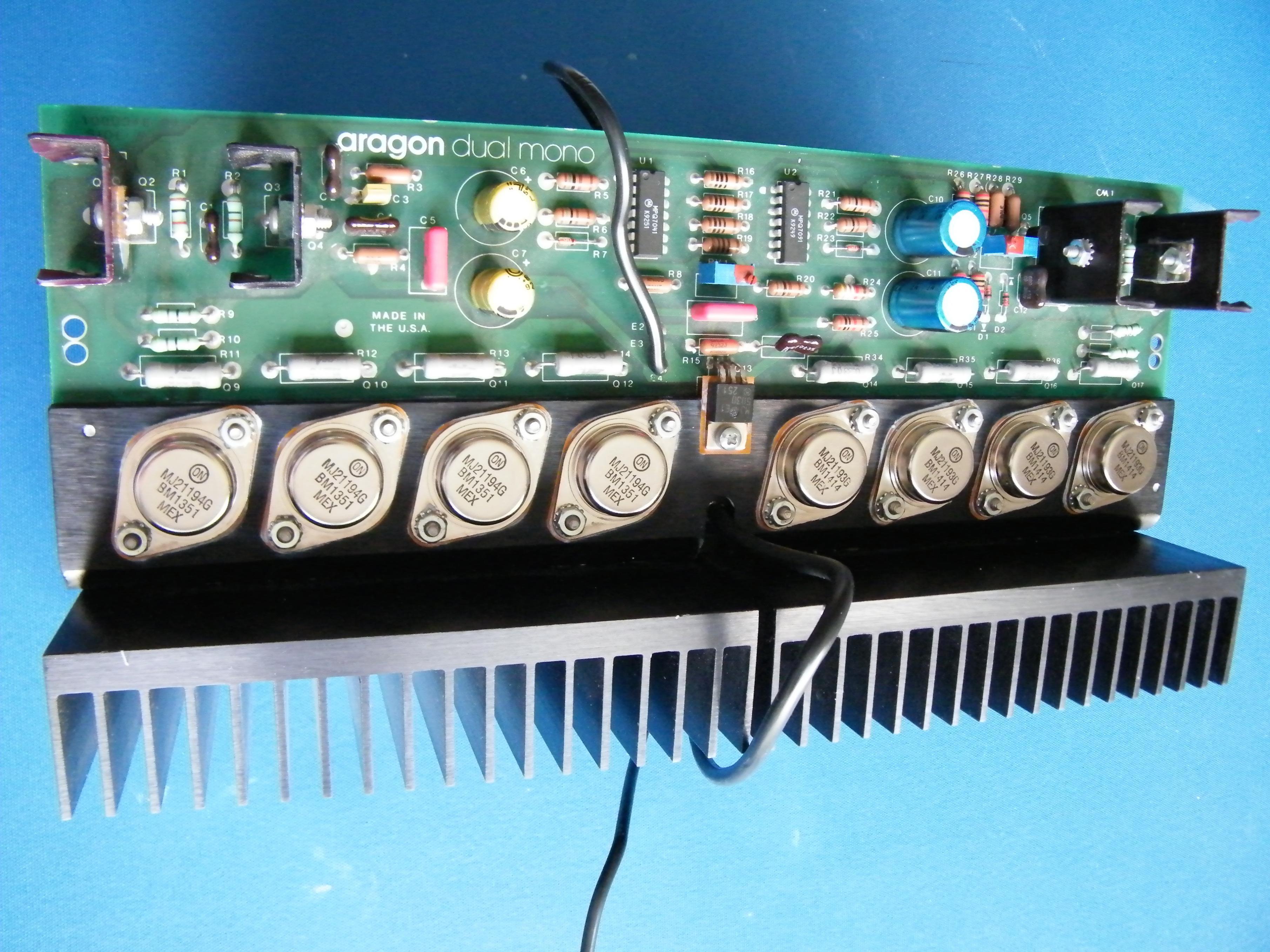

I put the Aragon Mark 2 on the workbench to check out a faulty right channel. Two power supply fuses blown, and, on DC testing the output transistors, three of them short-circuit.

The first thing I noticed about the output transistors was that the thermal grease had dried out and was very patchy. So I will be dismounting all the transistors, cleaning off the old grease and applying some new stuff, probably the Unigrease 3000 product. When thermal grease deteriorates it's no surprise to find failing output transistors.
Secondly the two resistors on the ground board (R201 and R202) had lost their metallic paint coating due to the regular heating. They test fine at about 10 Ohms each but I will be replacing them.

Here’s the amp during an initial inspection and before laying down a decent electrostatic protection mat:

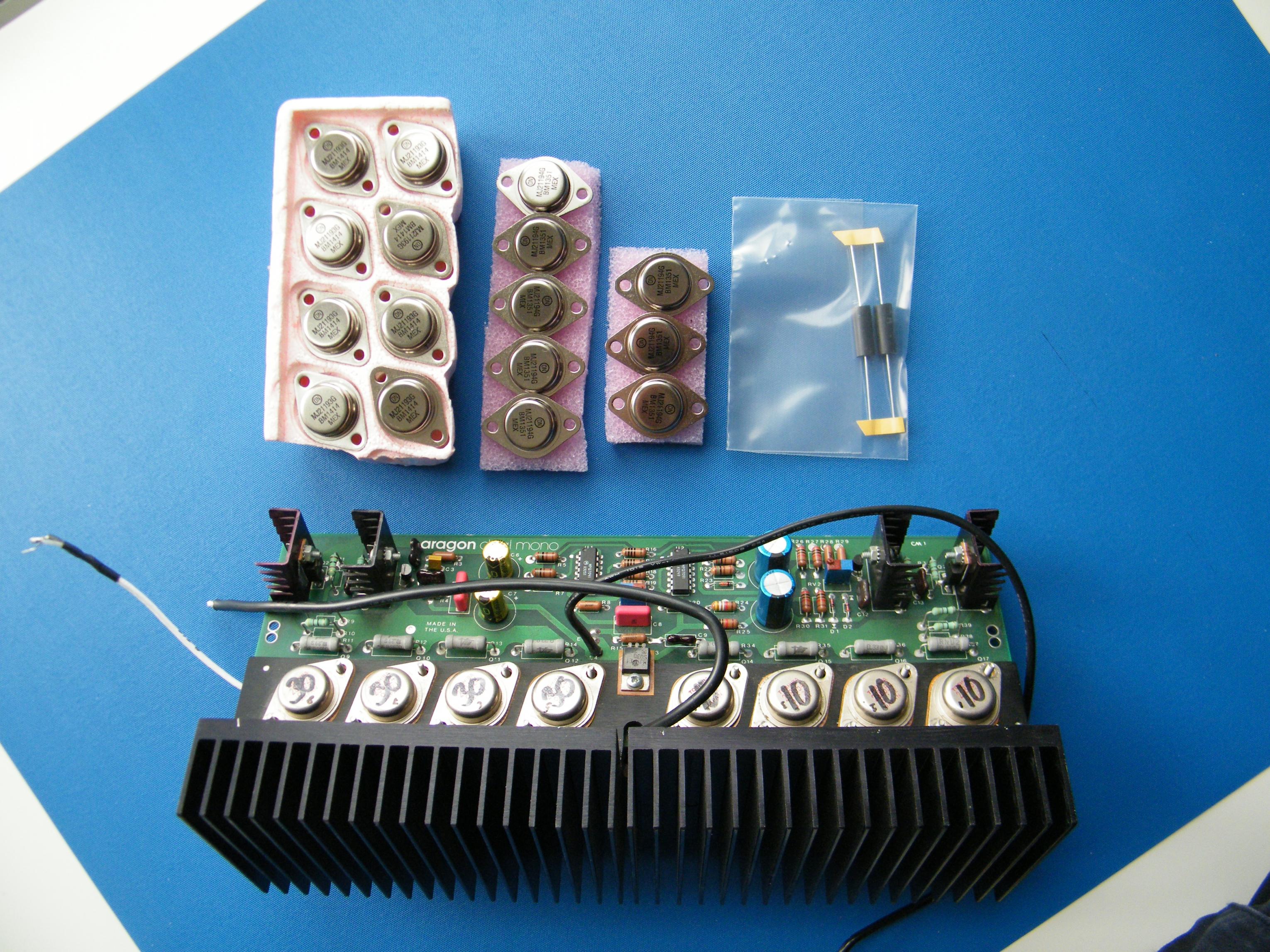

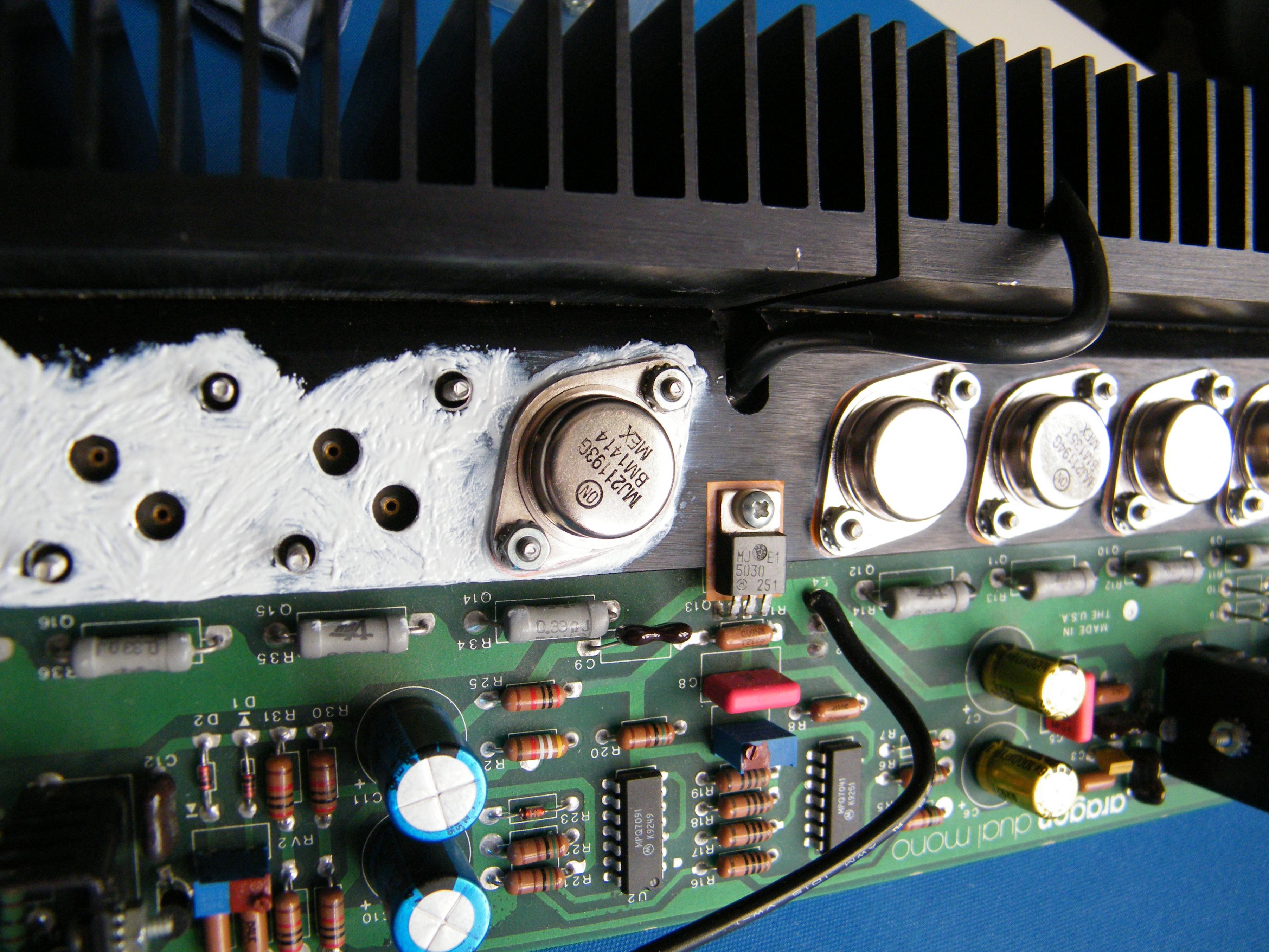

Before starting, here's what I had on the bench, the right channel module and the new parts. Transistors as discussed earlier in this thread supplied by DigiKey (excellent service) and thermal grease supplied by Unigrease (excellent support as well). Also present are the replacements for resistors R201 and R202.

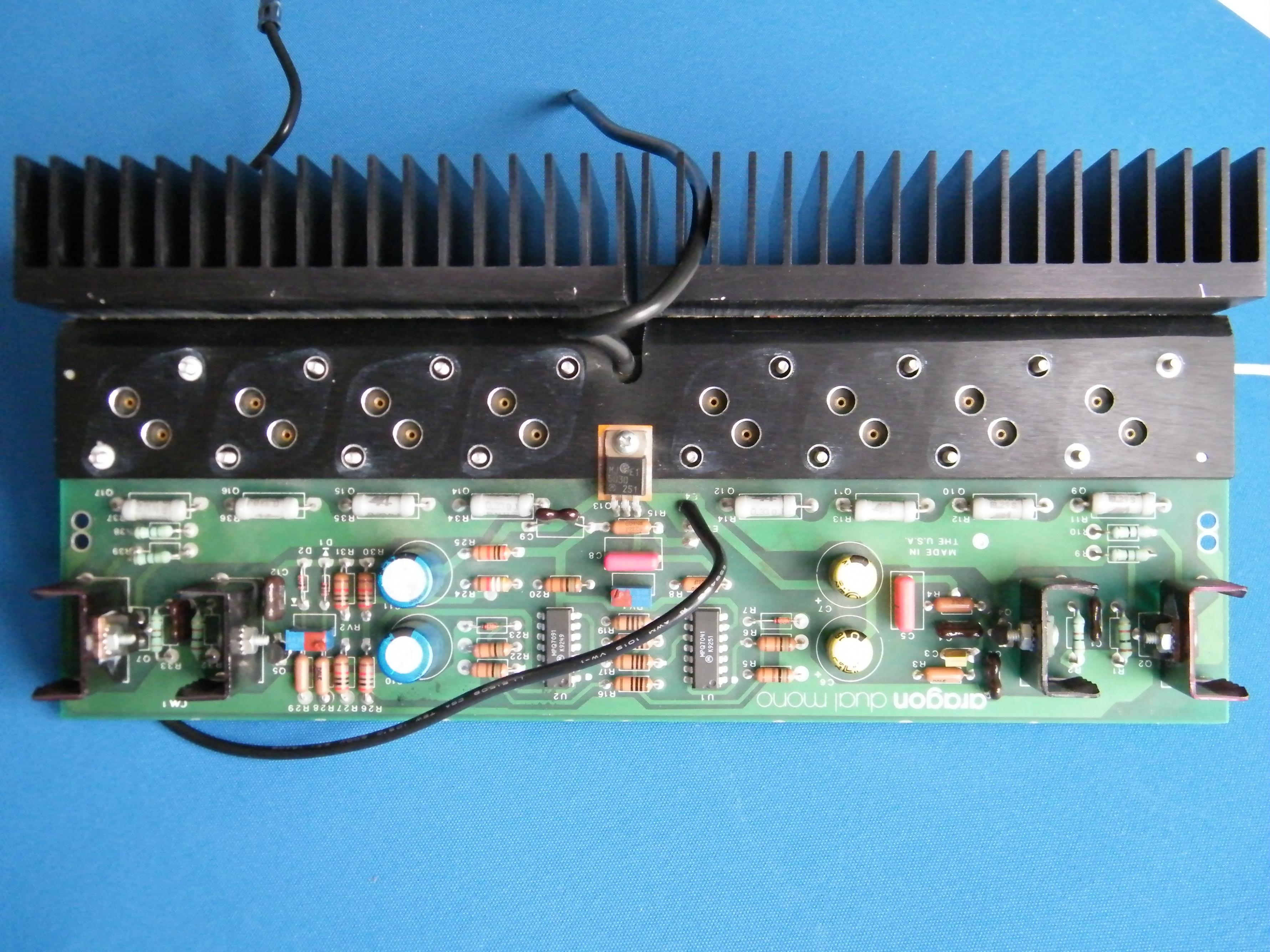

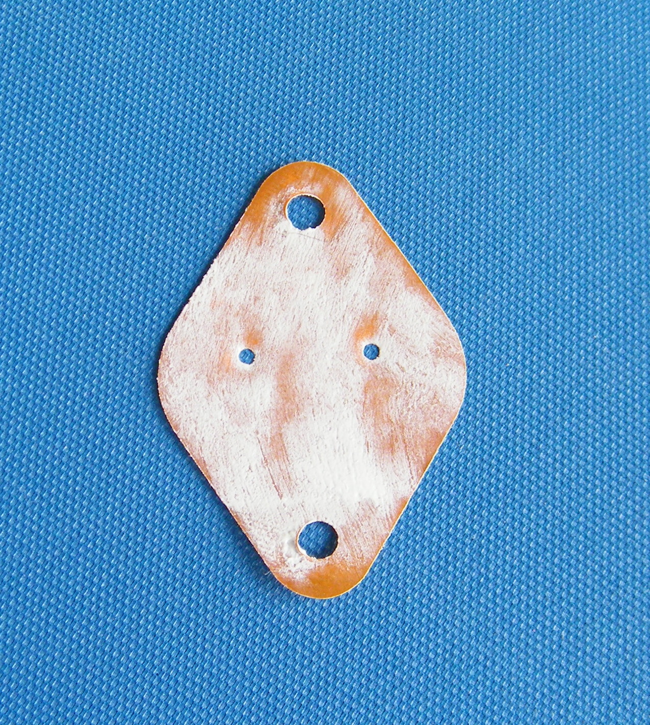

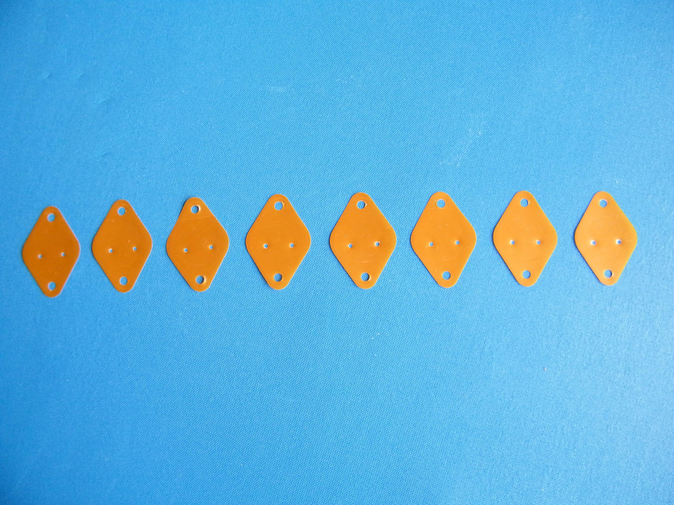

1) Clean and prepare the heat sink and thermal washers. I used an old clean handkerchief and a cleaning cloth designed to remove dirt from surfaces (not abrasive)
Fig 1: Heat sink cleaned.​
Fig 2 - 20 July 2014 - Aragon 4004 Right Channel - heak sink pads after cleaning of grease.jpg
Fig 2: Thermal washers very carefully cleaned of the old grease without buckling them.​

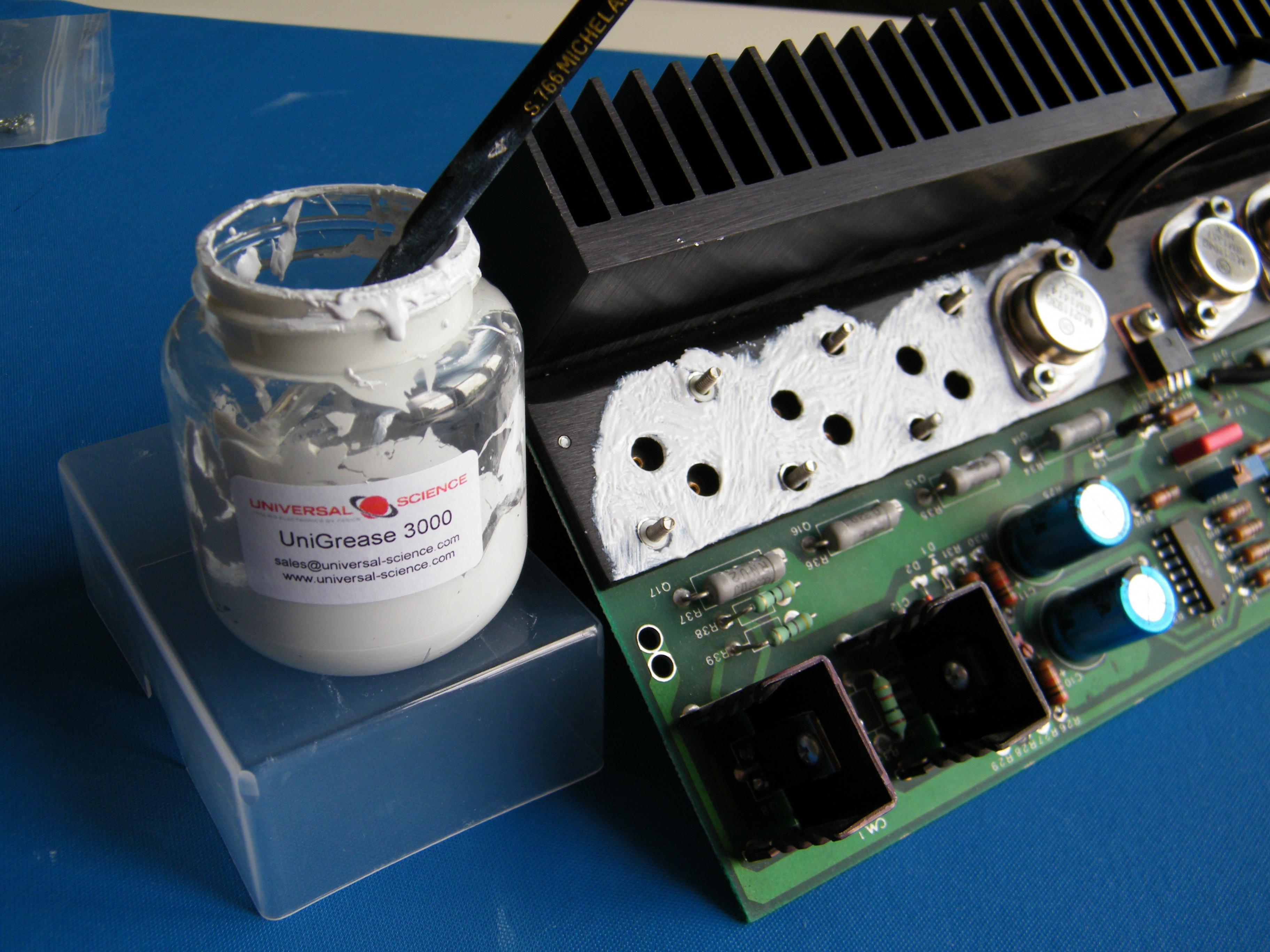

2) Apply grease to the heat sink. The ideal is to fill the air gaps on the anodised aluminium heat sink with an even layer of grease. In practise the grease, while very flexible, can “bunch up” into spots so I applied a layer with a small paintbrush evening it out and avoiding thick patches. Excess grease would make it difficult to compress and could even cause air gaps that would decrease thermal conductivity.
Fig 3 - 21st July 2014 - Aragon 4004 - thermal grease applied to the heat sink.jpg
Fig 3: Unigrease 3000 applied to the heat sink.

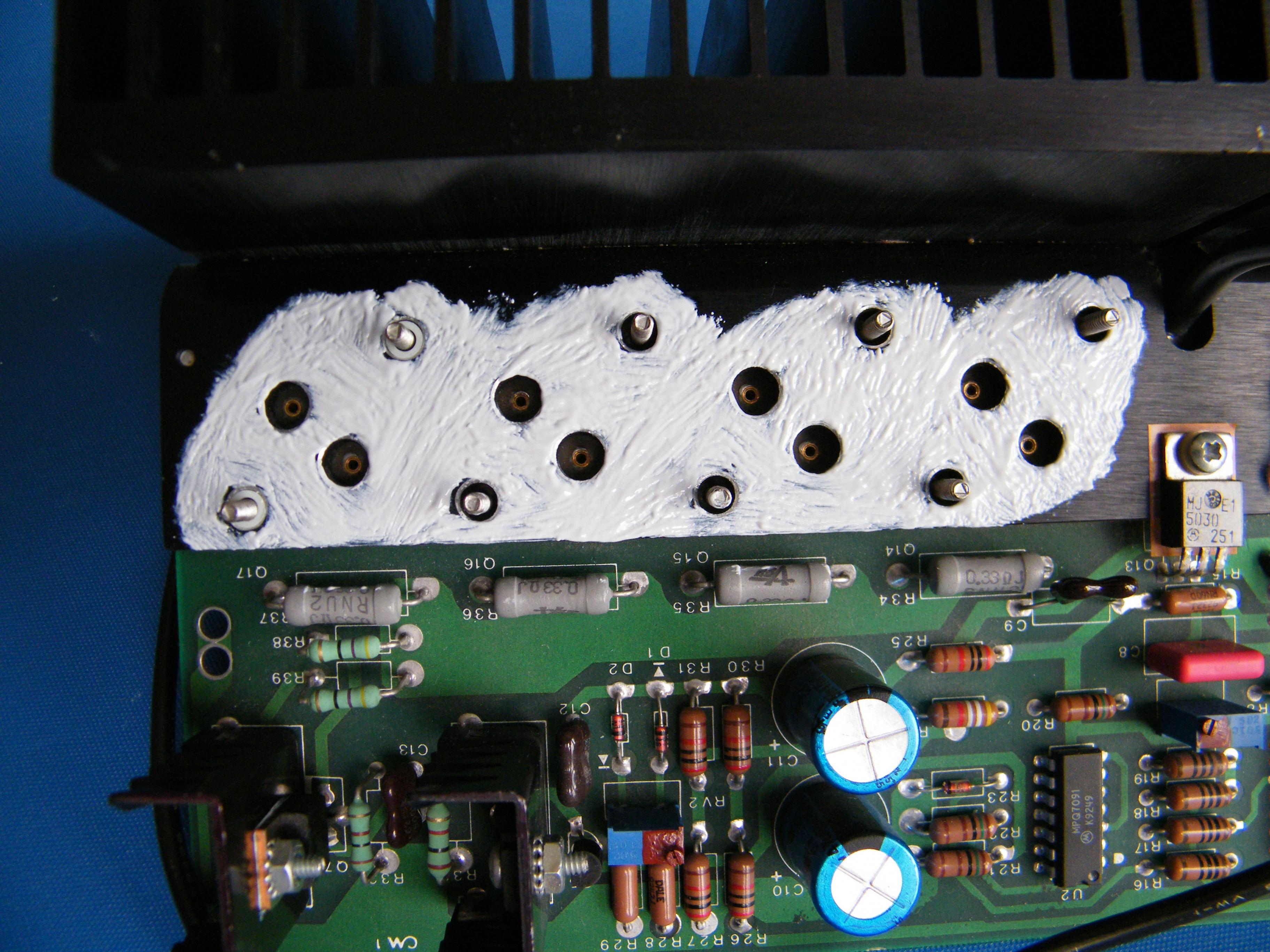

3) Apply a thin layer of grease to one side of a thermal washer
Fig 4 - 21st July 2014 - Aragon 4004 - thermal washer with thin layer of grease.JPG
Fig 4: Thin layer of thermal grease applied to the side of the thermal washer that will face the heat sink.
Aragon 4004 - replacing transistors on an output module

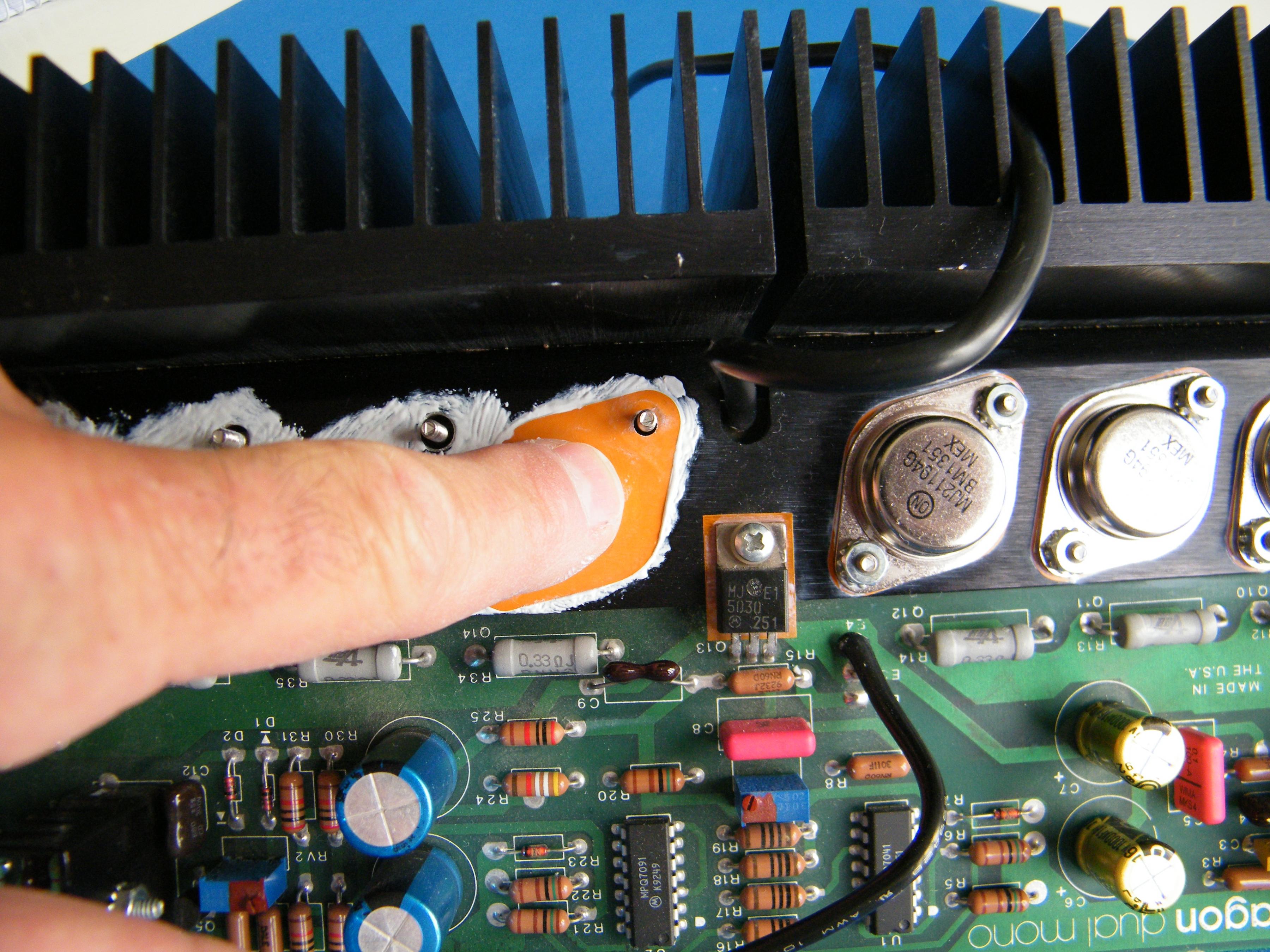

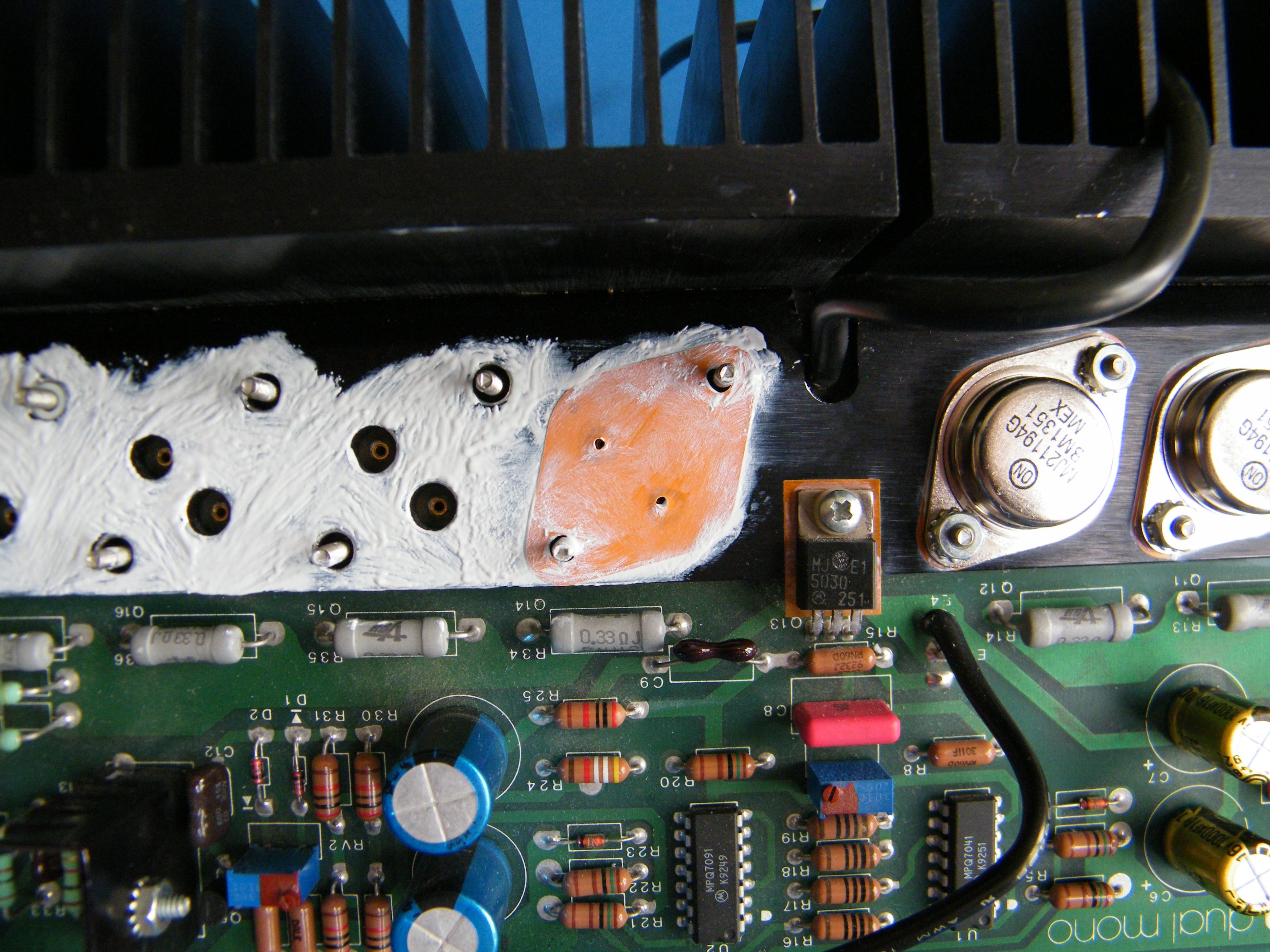

4) Apply the washer to the heat sink. This may vary from normal practice where you stick the thermal washer to the transistor first but here I wanted to use the heat sink as a support to press down on the thermal washer and carefully work it onto the heat sink thus optimising the spread of the thermal grease.
Fig 5: Applying the thermal washer to the heat sink. Press gently with a finger onto the thermal washer and carefully work it down to spread the grease as evenly as possible between the washer and the heat sink.
5) Put a thin layer of grease over the top of the thermal washer mounted on the heat sink. Don’t overdo it – just go for an even spread of the grease. I applied this with the paintbrush and wiped it very slightly with my finger to smooth off any excess.
Fig 6 - 21st July 2014 - Aragon 4004 - bedded thermal washer with very thin layer of grease.jpg
Fig 6: Thin layer of thermal grease applied to the mounted thermal washer.

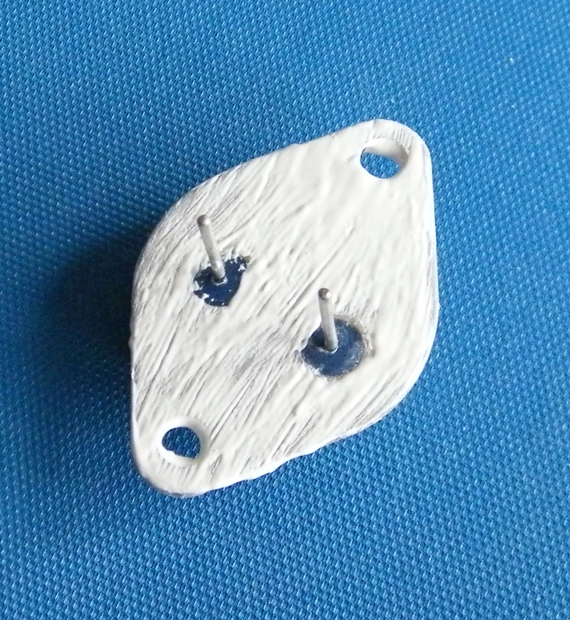

6) Apply a layer of grease to the transistor to be mounted. Again, I applied this with the paintbrush and spread the grease as evenly as possible. Be careful NOT to get grease on the base and emitter leads as you will note in Fig 7 there’s a bit on one of the leads which had to come off!
Fig 7: Thermal grease applied to a transistor

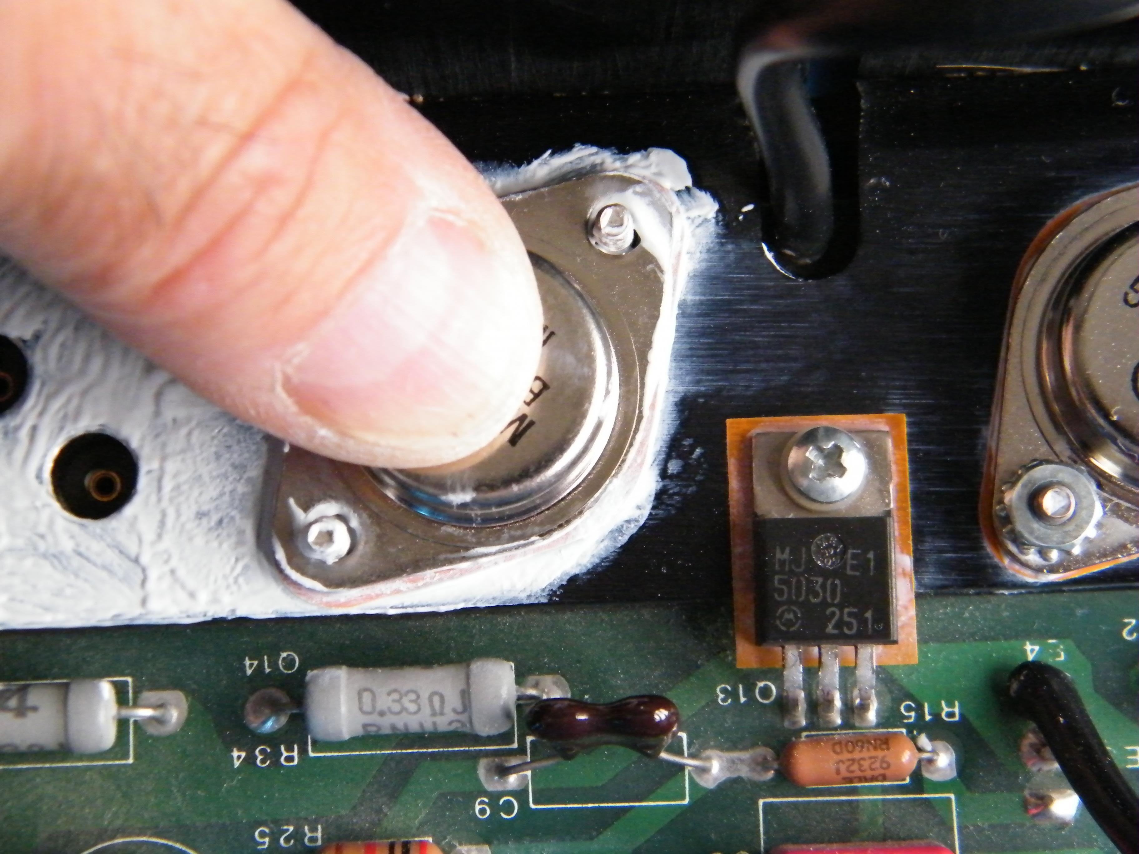

7) Fix the transistor in position on the heat sink. Apply firm pressure on the transistor for about 10 seconds and then screw the transistor to the heat sink. In the case of the Aragon 4004 assembly the transistor securing nuts are equipped with grip washers. Screw the bolts down sufficient for the grip washers to take and then NO MORE or you risk buckling the transistor case or even stripping the thread of the mounting bolt. Strictly speaking the torque spec for the nuts is 8 inch pounds (0.9nm) so the best solution is to use a proper torque screwdriver. See Figs 8, 9 & 10.
Fig 8 - 21st July 2014 - Aragon 4004 - applying thumb pressure to even out grease.jpg
Fig 8: Putting firm pressure on the transistor to evenly spread the grease.
