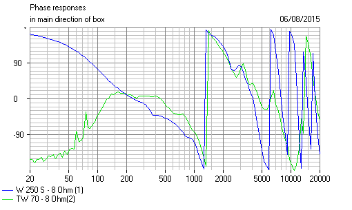

The tank is a good circuit to align phase sometimes. I'm using one below. And phase alignment matters. Though, TBH, I don't think many people get it with phase. Good phase alignment makes the speaker sound integrated and tells you a lot about resonances. Interestingly, Troels Gravesen always says it's best to just tackle the very worst bumps, which kinda stand out and make themselves known.

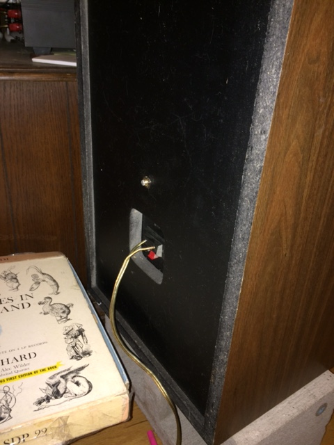

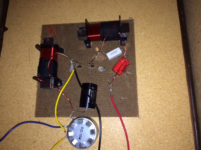

Just for future reference... here's pics and a schematic of my AR-38s speakers after modification. The little screw on the back of the speaker is for adjusting the tweeter level.
The Zobel is soldered directly across the woofer terminals. Not the best for reliability, but I was running out of space on the back of the cabinet.
The schematic is the same as System7 posted. The component values are a little different based upon what I had available. Doesn't seem to be a big deal.
With this mod it's a pretty OK speaker that makes me happy when I listen to it.

I can show you the electrical response of the filter, and the rough phase alignment looks good too. From the the slightly different FR plots of the Visaton TW70 and the flatter AR cone tweeter, I think frequency response is going to have no alarming bumps. 10/10 IMO!

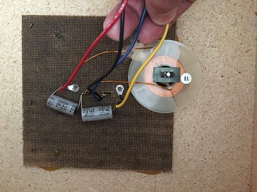

AR38S - restore and recap

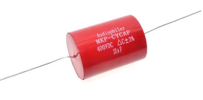

Hi Tal, a year since you posed the question 'where is a good source for 50V 6uf non-polarized capacitors?'. I expect you have got some by now. I restored a pair of AR38S and used aliexpress, I got 6uf 50v Bipolar capacitors in a packet of 30 for $6.33. They are radial instead of the original axial. They sounded fine to me, but the comment I got after posting pictures on another AR speaker forum was that 'Those tiny NPE's probably have very high ESR (some are 2-3 ohms and not intended for crossovers) it might tone down an otherwise hot high end.'
So I am going back to aliexpress and getting their Audiophile quality ones. These are axial like the originals. The closest uf value is 5.6uf, that they are 250v or 400v doesn't matter, so long as they are higher than 50v. These run about $1 US each and postage for 2 is $2.

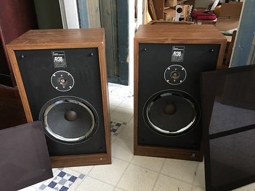

Here are some photos of the AR38s which I got for $10 at an auction.
Photo before refoaming
Photo after refoaming
Original Crossover
Crossover after install of cheap 50v 6uf NP caps
Audiophile cap of the type i have on order 400v 5.6uf NP
