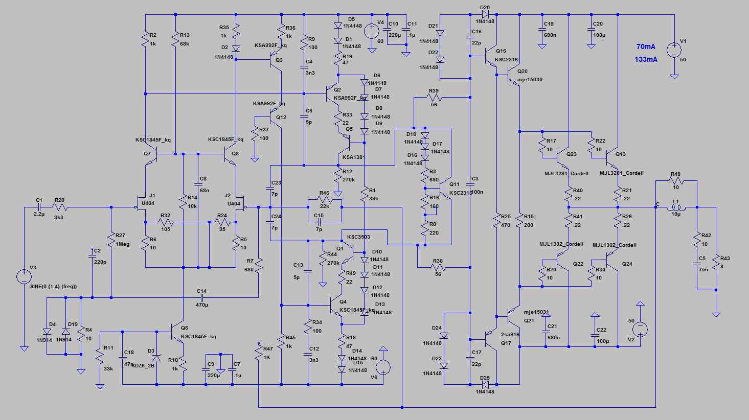

Carlmart, yes I found a schematic of the M120 and similar topology except for the front end. The apt also uses an OpAmp for DC feedback to trim the output offset which I did not see on the 120. I wonder who copied who? I think the 120 also uses different devices in the output stage. The apt uses the MJ10022/23 devices which I think were quite new when the apt came out.
Here are the two simulations I arrived to with the M120, including one with DC servo. In fact, the original M120 used two IC servos on each channel.
THD gets a bit worst in the sim with the servo.
I never simmed the Apt 1. Perhaps someone did.
As most, if not all, active devices used in the these new "Luxman" versions are different from the original amplifiers, I do not quite agree on calling them "clones". Maybe "architecture" or "inspired". As models for those original parts are mostly unavailable too, we can only watch what happens with the modern parts and listen to the results.
As I have not tools for distortion or noise, auditioning them is the most I can do.
Now I wonder how Baker clamps could be effectively implemented here, in the output drivers I guess. Suggestions accepted to simulate.
Just tried what I think should be a Baker clamp implementation on the Luxman M120 clone. Taken from Bob Cordell's book.
I think D20 and D25 shouldn't be 1N4148. If I remember well from another implementation, that should be a Schottky or a BAV21.
THD was not altered, and the THD curve is practically the same. I'm not sure if there's something somewhere in the sim that will show the clamp effects.

Using the better diodes for this particular application (BAV21 and the like vs the ubiquitous 1N4148), i don't think you would see contributions of the clamp until the amp is driven to clipping when the clamp becomes active.

The 1N4149 is also often a better choice than the better-known 1N4148, since it is similar but with lower capacitance.
